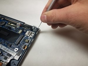

Wedge a plastic opening tool or spudger in between the laptop casing and the port. Pry until you feel it release.
This will take some force because the port is glued to the casing.
