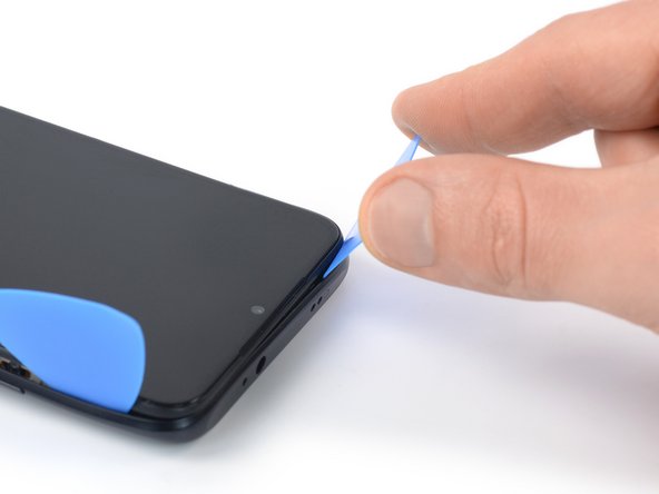

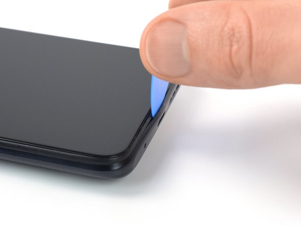

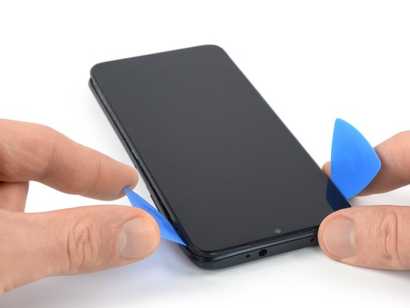

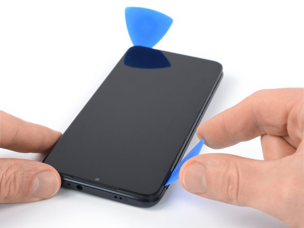

  3. Xiaomi Redmi Note 9T Screen Replacement, Insert an opening pick: crwdns2935265:03crwdnd2935265:01crwdnd2935265:03crwdne2935265:0 Xiaomi Redmi Note 9T Screen Replacement, Insert an opening pick: crwdns2935265:03crwdnd2935265:02crwdnd2935265:03crwdne2935265:0 Xiaomi Redmi Note 9T Screen Replacement, Insert an opening pick: crwdns2935265:03crwdnd2935265:03crwdnd2935265:03crwdne2935265:0
    • The back cover of the Redmi Note 9T is held in place by plastic clips and mild adhesive around the camera cut-out. It might require some force to release the plastic clips.
    • Insert an opening pick in a steep angle between the display assembly and the back cover where the charging port is located. This might require some force.
    • Make sure to insert the opening pick between the back cover and the display frame to avoid separating the screen from the frame.

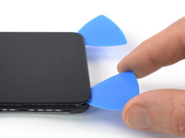

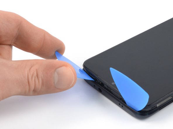

  4. Xiaomi Redmi Note 9T Screen Replacement, Release the bottom edge plastic clips: crwdns2935265:04crwdnd2935265:01crwdnd2935265:02crwdne2935265:0 Xiaomi Redmi Note 9T Screen Replacement, Release the bottom edge plastic clips: crwdns2935265:04crwdnd2935265:02crwdnd2935265:02crwdne2935265:0
    • Slide the opening pick to the bottom right corner to release the plastic clips holding the back cover in place.
    • Leave the opening pick in the bottom right corner to prevent the clips from snapping back into place.

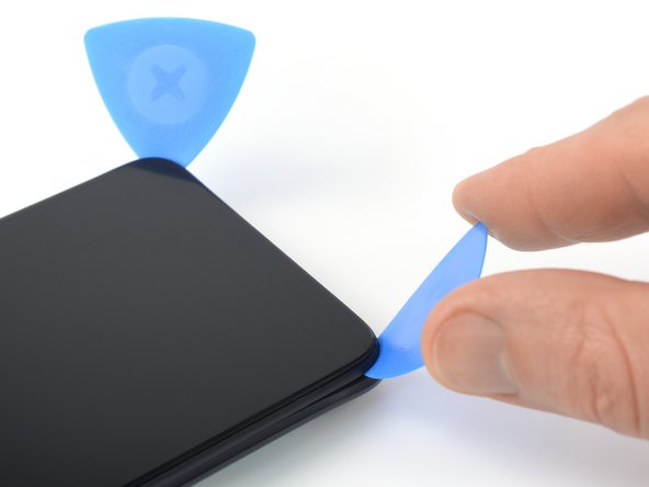

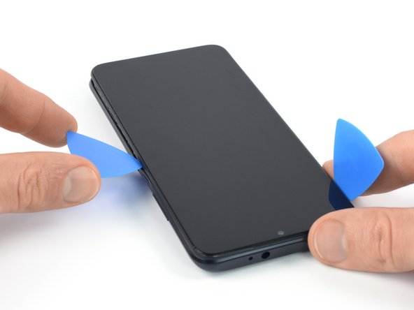

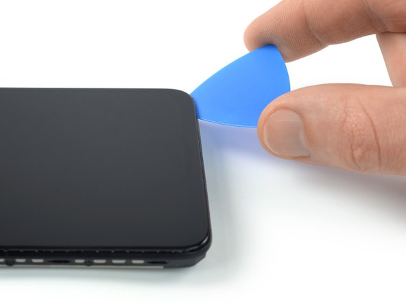

  5. Xiaomi Redmi Note 9T Screen Replacement: crwdns2935265:05crwdnd2935265:01crwdnd2935265:02crwdne2935265:0 Xiaomi Redmi Note 9T Screen Replacement: crwdns2935265:05crwdnd2935265:02crwdnd2935265:02crwdne2935265:0
    • Insert a second opening pick in a steep angle at the bottom edge of your phone.
    • Slide the opening pick to the bottom left corner to release the plastic clips.
    • Leave the opening pick in the bottom left corner to prevent the clips from snapping back into place.

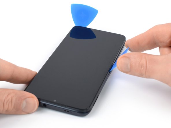

  9. Xiaomi Redmi Note 9T Screen Replacement: crwdns2935265:09crwdnd2935265:01crwdnd2935265:02crwdne2935265:0 Xiaomi Redmi Note 9T Screen Replacement: crwdns2935265:09crwdnd2935265:02crwdnd2935265:02crwdne2935265:0
    • Slide the right opening pick around the top right corner to release the remaining plastic clips.
    • Don't try to separate the phone assembly from the back cover all the way yet – the power and volume button cable is still connected to the motherboard.

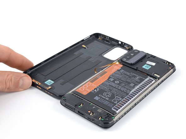

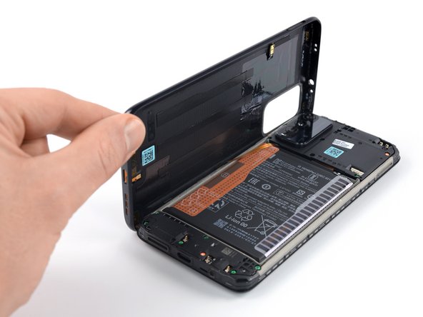

  10. Xiaomi Redmi Note 9T Screen Replacement, Open the phone assembly: crwdns2935265:010crwdnd2935265:01crwdnd2935265:03crwdne2935265:0 Xiaomi Redmi Note 9T Screen Replacement, Open the phone assembly: crwdns2935265:010crwdnd2935265:02crwdnd2935265:03crwdne2935265:0 Xiaomi Redmi Note 9T Screen Replacement, Open the phone assembly: crwdns2935265:010crwdnd2935265:03crwdnd2935265:03crwdne2935265:0
    • Carefully fold the back cover to the left side of the phone assembly like you would open the cover of a book.
    • Take care not to strain or tear the power or volume button flex cable during this procedure.
    • During reassembly align the back cover with the phone assembly and snap it back in its original position.

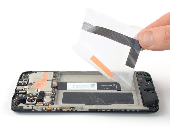

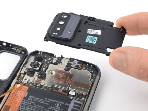

  11. Xiaomi Redmi Note 9T Screen Replacement, Unfasten the motherboard cover screws: crwdns2935265:011crwdnd2935265:01crwdnd2935265:01crwdne2935265:0
    • Use a Phillips screwdriver to remove the ten 3.9 mm-long screws securing the motherboard cover.

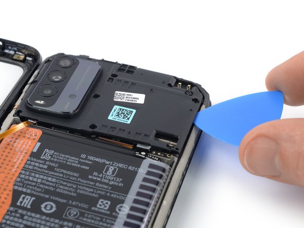

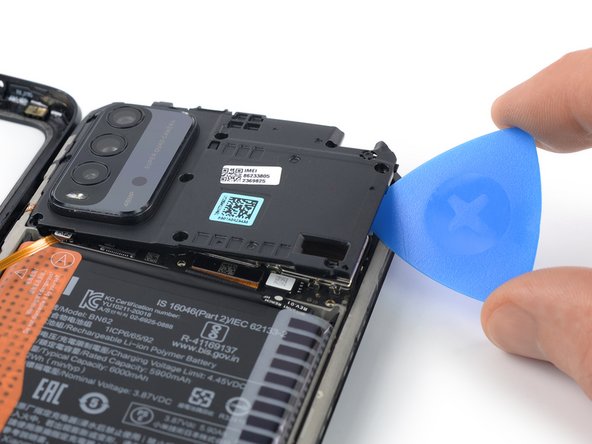

  12. Xiaomi Redmi Note 9T Screen Replacement, Pry up the motherboard cover: crwdns2935265:012crwdnd2935265:01crwdnd2935265:03crwdne2935265:0 Xiaomi Redmi Note 9T Screen Replacement, Pry up the motherboard cover: crwdns2935265:012crwdnd2935265:02crwdnd2935265:03crwdne2935265:0 Xiaomi Redmi Note 9T Screen Replacement, Pry up the motherboard cover: crwdns2935265:012crwdnd2935265:03crwdnd2935265:03crwdne2935265:0
    • Insert an opening pick underneath the bottom right edge of the motherboard cover.
    • Slide the opening pick along the right edge of the motherboard cover to release its plastic clips.
    • Twist the opening pick sideways to pry up the motherboard cover.
  13. Xiaomi Redmi Note 9T Screen Replacement, Remove the motherboard cover: crwdns2935265:013crwdnd2935265:01crwdnd2935265:02crwdne2935265:0 Xiaomi Redmi Note 9T Screen Replacement, Remove the motherboard cover: crwdns2935265:013crwdnd2935265:02crwdnd2935265:02crwdne2935265:0
    • Remove the motherboard cover.

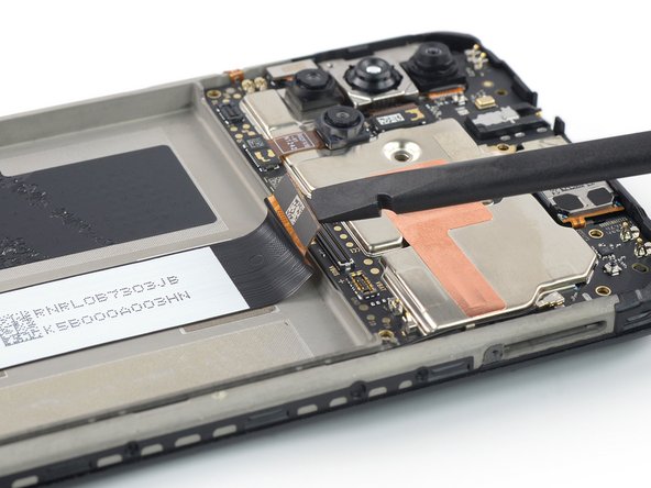

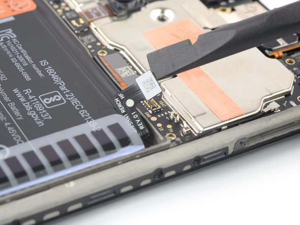

  14. Xiaomi Redmi Note 9T Screen Replacement, Disconnect the home and volume button cable: crwdns2935265:014crwdnd2935265:01crwdnd2935265:02crwdne2935265:0 Xiaomi Redmi Note 9T Screen Replacement, Disconnect the home and volume button cable: crwdns2935265:014crwdnd2935265:02crwdnd2935265:02crwdne2935265:0
    • Use a spudger to disconnect the home and volume button cable by prying the connector straight up from its socket.
    • To re-attach press connectors like this one, carefully align and press down on one side until it clicks into place, then repeat on the other side. Don't press down on the middle. If the connector is misaligned, the pins can bend, causing permanent damage.

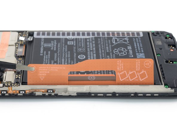

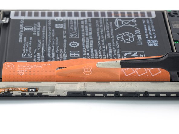

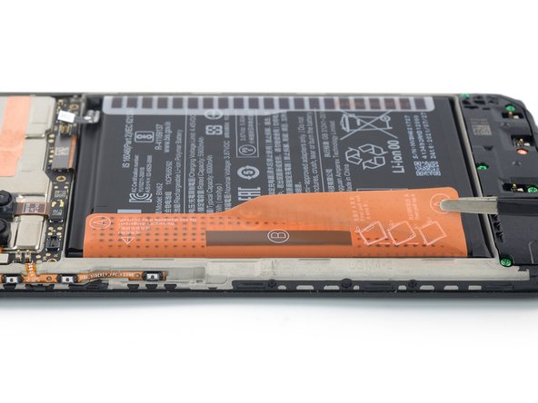

  17. Xiaomi Redmi Note 9T Screen Replacement, Peel off the battery pull-tabs: crwdns2935265:017crwdnd2935265:01crwdnd2935265:03crwdne2935265:0 Xiaomi Redmi Note 9T Screen Replacement, Peel off the battery pull-tabs: crwdns2935265:017crwdnd2935265:02crwdnd2935265:03crwdne2935265:0 Xiaomi Redmi Note 9T Screen Replacement, Peel off the battery pull-tabs: crwdns2935265:017crwdnd2935265:03crwdnd2935265:03crwdne2935265:0
    • Take care not to puncture or bend the battery with your tool—a punctured or bent battery may leak dangerous chemicals or cause a fire.
    • Use a pair of blunt nose tweezers or a clean fingernail to peel the orange adhesive strip labeled with an A off the battery.
  18. Xiaomi Redmi Note 9T Screen Replacement: crwdns2935265:018crwdnd2935265:01crwdnd2935265:02crwdne2935265:0 Xiaomi Redmi Note 9T Screen Replacement: crwdns2935265:018crwdnd2935265:02crwdnd2935265:02crwdne2935265:0
    • Repeat the previous pull-tab procedure on the orange adhesive strip labeled with a B.

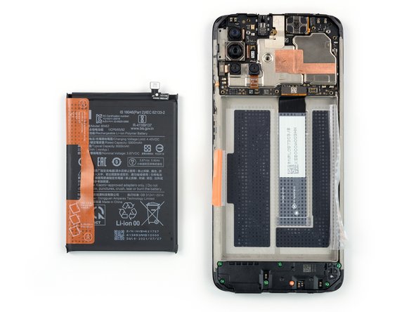

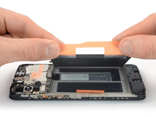

  19. Xiaomi Redmi Note 9T Screen Replacement, Lift the battery: crwdns2935265:019crwdnd2935265:01crwdnd2935265:02crwdne2935265:0 Xiaomi Redmi Note 9T Screen Replacement, Lift the battery: crwdns2935265:019crwdnd2935265:02crwdnd2935265:02crwdne2935265:0
    • Grab both pull-tab ends labeled with an A and pull up on the adhesive strip to lift the battery out of its recess and swing it up to an upright position.
    • If you're having trouble lifting the battery out of its recess, apply a heated iOpener to the screen for two minutes to loosen the battery adhesive.
    • A hair dryer, heat gun, or hot plate may also be used, but be careful not to overheat the device.
    • Don't point a heat gun directly onto the battery but only onto the screen to prevent the battery from overheating.

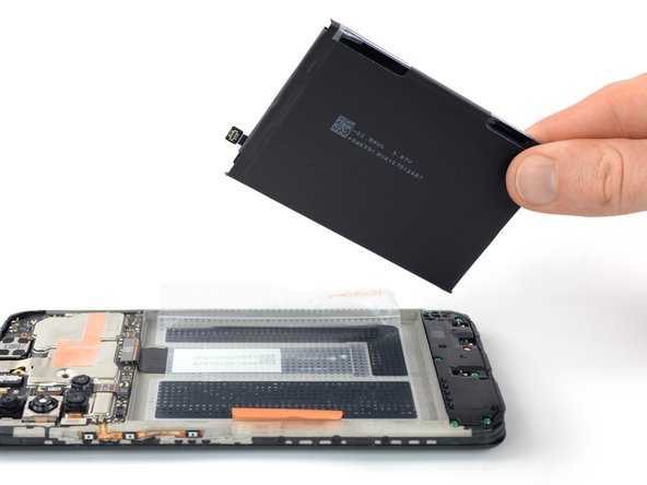

  20. Xiaomi Redmi Note 9T Screen Replacement, Remove the battery: crwdns2935265:020crwdnd2935265:01crwdnd2935265:03crwdne2935265:0 Xiaomi Redmi Note 9T Screen Replacement, Remove the battery: crwdns2935265:020crwdnd2935265:02crwdnd2935265:03crwdne2935265:0 Xiaomi Redmi Note 9T Screen Replacement, Remove the battery: crwdns2935265:020crwdnd2935265:03crwdnd2935265:03crwdne2935265:0
    • Peel the battery off the remaining adhesive.
    • Remove the battery.
    • Don't reinstall a damaged or deformed battery, as doing so is a potential safety hazard.
    • Secure the new battery with pre-cut adhesive or double-sided adhesive tape. In order to position it correctly, apply the new adhesive into the device at the places where the old adhesive was located, not directly onto the battery. Press the new battery firmly into place.
    • During reassembly, temporarily reconnect the battery to the motherboard before you press it into place to ensure correct alignment. Disconnect the battery after it's seated.
  21. Xiaomi Redmi Note 9T Screen Replacement, Remove the battery adhesive: crwdns2935265:021crwdnd2935265:01crwdnd2935265:02crwdne2935265:0 Xiaomi Redmi Note 9T Screen Replacement, Remove the battery adhesive: crwdns2935265:021crwdnd2935265:02crwdnd2935265:02crwdne2935265:0

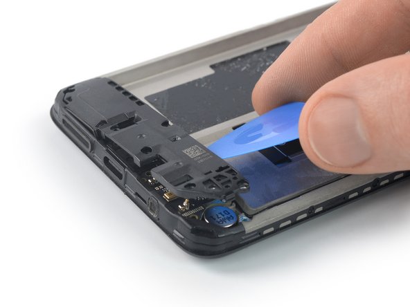

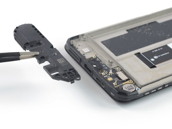

  22. Xiaomi Redmi Note 9T Screen Replacement, Unfasten the loudspeaker assembly screws: crwdns2935265:022crwdnd2935265:01crwdnd2935265:01crwdne2935265:0
    • Use a Phillips screwdriver to remove the seven 3.9 mm-long screws securing the loudspeaker assembly.
  23. Xiaomi Redmi Note 9T Screen Replacement, Pry up the loudspeaker assembly: crwdns2935265:023crwdnd2935265:01crwdnd2935265:02crwdne2935265:0 Xiaomi Redmi Note 9T Screen Replacement, Pry up the loudspeaker assembly: crwdns2935265:023crwdnd2935265:02crwdnd2935265:02crwdne2935265:0
    • Slide an opening pick underneath the top edge of the loudspeaker assembly.
    • Use your opening pick to pry up the loudspeaker assembly until you can grip it with your tweezers or fingers.
  24. Xiaomi Redmi Note 9T Screen Replacement, Remove the loudspeaker assembly: crwdns2935265:024crwdnd2935265:01crwdnd2935265:02crwdne2935265:0 Xiaomi Redmi Note 9T Screen Replacement, Remove the loudspeaker assembly: crwdns2935265:024crwdnd2935265:02crwdnd2935265:02crwdne2935265:0
    • Use a pair of tweezers or your fingers to remove the loudspeaker assembly.

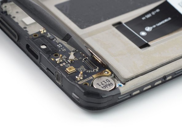

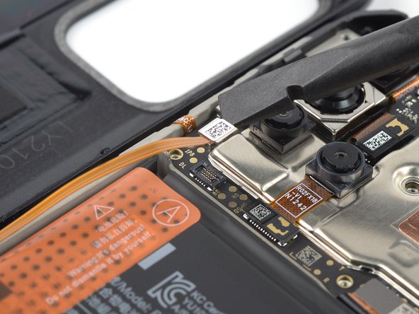

  25. Xiaomi Redmi Note 9T Screen Replacement, Disconnect the display cable: crwdns2935265:025crwdnd2935265:01crwdnd2935265:02crwdne2935265:0 Xiaomi Redmi Note 9T Screen Replacement, Disconnect the display cable: crwdns2935265:025crwdnd2935265:02crwdnd2935265:02crwdne2935265:0
    • Use a spudger to disconnect the display cable by prying the connector straight up from its socket.

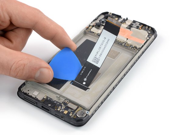

  26. Xiaomi Redmi Note 9T Screen Replacement, Free the display cable: crwdns2935265:026crwdnd2935265:01crwdnd2935265:02crwdne2935265:0 Xiaomi Redmi Note 9T Screen Replacement, Free the display cable: crwdns2935265:026crwdnd2935265:02crwdnd2935265:02crwdne2935265:0
    • The display cable is adhered to the midframe with mild adhesive.
    • Slide an opening pick underneath the display cable to separate it from the midframe.
    • If you're having trouble separating the display cable, apply a heated iOpener to the screen for one minute to loosen the cable adhesive.
  27. Xiaomi Redmi Note 9T Screen Replacement, Disconnect the digitizer cable: crwdns2935265:027crwdnd2935265:01crwdnd2935265:02crwdne2935265:0 Xiaomi Redmi Note 9T Screen Replacement, Disconnect the digitizer cable: crwdns2935265:027crwdnd2935265:02crwdnd2935265:02crwdne2935265:0
    • Use a spudger to disconnect the digitizer cable by prying the connector straight up from its socket.

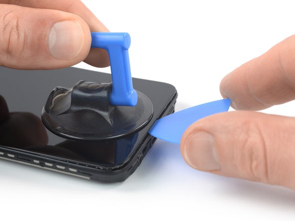

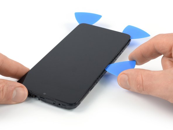

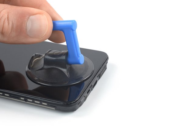

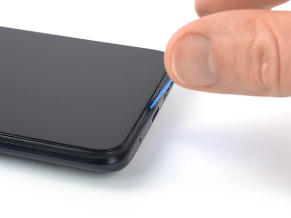

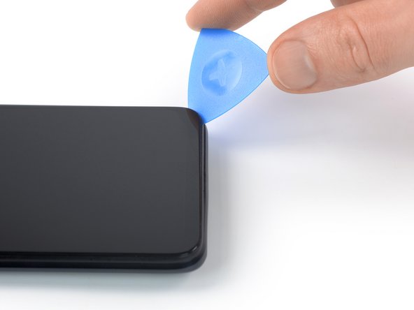

  29. Xiaomi Redmi Note 9T Screen Replacement, Insert an opening pick: crwdns2935265:029crwdnd2935265:01crwdnd2935265:03crwdne2935265:0 Xiaomi Redmi Note 9T Screen Replacement, Insert an opening pick: crwdns2935265:029crwdnd2935265:02crwdnd2935265:03crwdne2935265:0 Xiaomi Redmi Note 9T Screen Replacement, Insert an opening pick: crwdns2935265:029crwdnd2935265:03crwdnd2935265:03crwdne2935265:0
    • Once the screen is warm to the touch, apply a suction handle to the bottom edge of the screen.
    • If your display is badly cracked, covering it with a layer of clear packing tape may allow the suction cup to adhere. Alternatively, very strong tape may be used instead of the suction cup. If all else fails, you can superglue the suction cup to the broken screen.
    • Lift the screen with the suction handle to create a small gap between the screen and the phone assembly.
    • Depending on the age of your phone, this may be difficult. If you're having trouble, apply more heat to the bottom edge and try again.
    • Insert an opening pick into the gap.

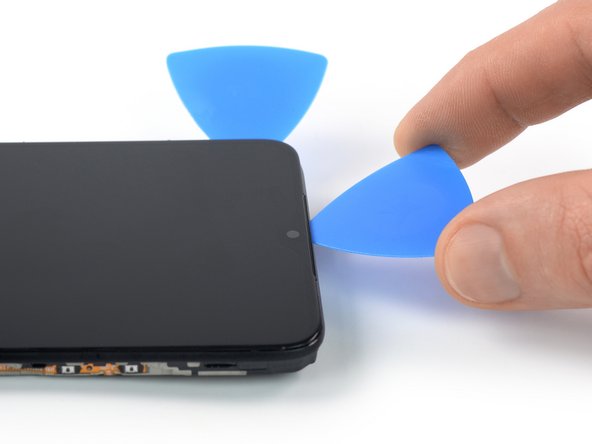

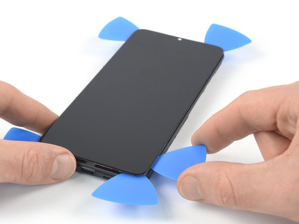

  30. Xiaomi Redmi Note 9T Screen Replacement, Slice the bottom edge adhesive: crwdns2935265:030crwdnd2935265:01crwdnd2935265:02crwdne2935265:0 Xiaomi Redmi Note 9T Screen Replacement, Slice the bottom edge adhesive: crwdns2935265:030crwdnd2935265:02crwdnd2935265:02crwdne2935265:0
    • Slide the opening pick to the bottom right corner of the screen to slice its adhesive.
    • Leave the opening pick in place to prevent the adhesive from resealing.

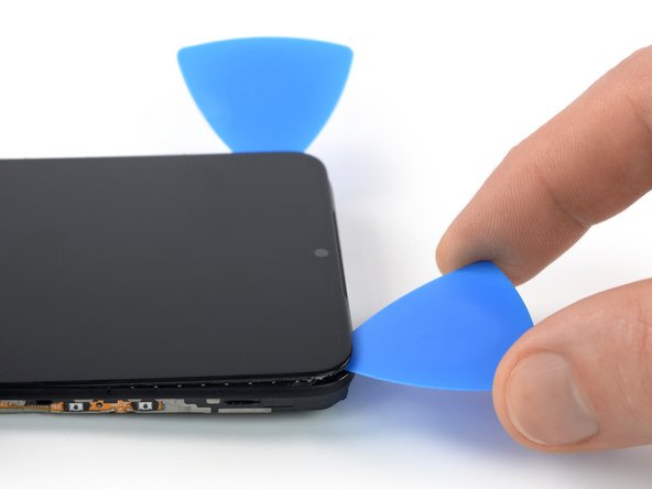

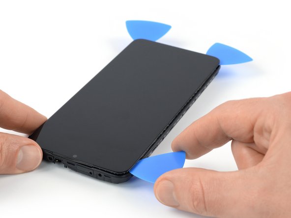

  31. Xiaomi Redmi Note 9T Screen Replacement: crwdns2935265:031crwdnd2935265:01crwdnd2935265:02crwdne2935265:0 Xiaomi Redmi Note 9T Screen Replacement: crwdns2935265:031crwdnd2935265:02crwdnd2935265:02crwdne2935265:0
    • Insert a second opening pick at the bottom edge and slide it to the bottom left corner of the screen to slice the adhesive.

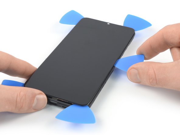

  32. Xiaomi Redmi Note 9T Screen Replacement, Slice the left edge adhesive: crwdns2935265:032crwdnd2935265:01crwdnd2935265:03crwdne2935265:0 Xiaomi Redmi Note 9T Screen Replacement, Slice the left edge adhesive: crwdns2935265:032crwdnd2935265:02crwdnd2935265:03crwdne2935265:0 Xiaomi Redmi Note 9T Screen Replacement, Slice the left edge adhesive: crwdns2935265:032crwdnd2935265:03crwdnd2935265:03crwdne2935265:0
    • Insert a third opening pick underneath the bottom left corner of the screen.
    • Slide the opening pick along the left edge of the screen to slice the adhesive.
    • Leave the opening pick in the top left corner to prevent the adhesive from resealing.
  33. Xiaomi Redmi Note 9T Screen Replacement, Slice the top edge adhesive: crwdns2935265:033crwdnd2935265:01crwdnd2935265:03crwdne2935265:0 Xiaomi Redmi Note 9T Screen Replacement, Slice the top edge adhesive: crwdns2935265:033crwdnd2935265:02crwdnd2935265:03crwdne2935265:0 Xiaomi Redmi Note 9T Screen Replacement, Slice the top edge adhesive: crwdns2935265:033crwdnd2935265:03crwdnd2935265:03crwdne2935265:0
    • If the adhesive becomes hard to cut, it has most likely cooled down. Use your iOpener or heat gun for 1–2 minutes to reheat it.
    • When you slice near the front facing camera, insert only the tip of the opening pick (~2.5 mm) to avoid damaging or smearing the camera.
    • Insert a fourth opening pick at the top left corner of the screen.
    • Slide the opening pick along the top edge of the phone to slice the adhesive.
    • Leave the opening pick in the top right corner to prevent the adhesive from resealing.
  34. Xiaomi Redmi Note 9T Screen Replacement, Slice the right edge adhesive: crwdns2935265:034crwdnd2935265:01crwdnd2935265:03crwdne2935265:0 Xiaomi Redmi Note 9T Screen Replacement, Slice the right edge adhesive: crwdns2935265:034crwdnd2935265:02crwdnd2935265:03crwdne2935265:0 Xiaomi Redmi Note 9T Screen Replacement, Slice the right edge adhesive: crwdns2935265:034crwdnd2935265:03crwdnd2935265:03crwdne2935265:0
    • Insert a fifth opening pick and slide it along the right edge of the phone to slice the remaining adhesive.
    • Don't try to remove the display all the way yet, the display cables are still threaded through the midframe.

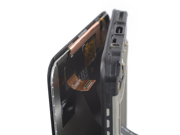

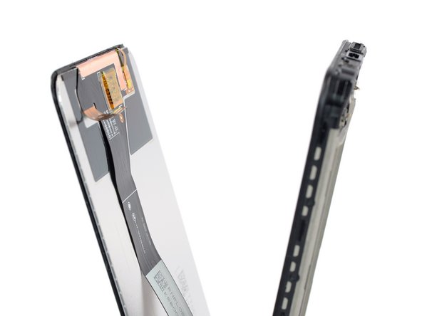

  35. Xiaomi Redmi Note 9T Screen Replacement, Free the display cables: crwdns2935265:035crwdnd2935265:01crwdnd2935265:02crwdne2935265:0 Xiaomi Redmi Note 9T Screen Replacement, Free the display cables: crwdns2935265:035crwdnd2935265:02crwdnd2935265:02crwdne2935265:0
    • Carefully thread the digitizer flex cable through the gap in the midframe by opening the phone assembly like a book.
  36. Xiaomi Redmi Note 9T Screen Replacement: crwdns2935265:036crwdnd2935265:01crwdnd2935265:02crwdne2935265:0 Xiaomi Redmi Note 9T Screen Replacement: crwdns2935265:036crwdnd2935265:02crwdnd2935265:02crwdne2935265:0
    • Free the display flex cable by threading it through the gap in the midframe.
  37. Xiaomi Redmi Note 9T Screen Replacement, Separate the screen from the phone assembly: crwdns2935265:037crwdnd2935265:01crwdnd2935265:01crwdne2935265:0
    • Separate the screen from the phone assembly.
