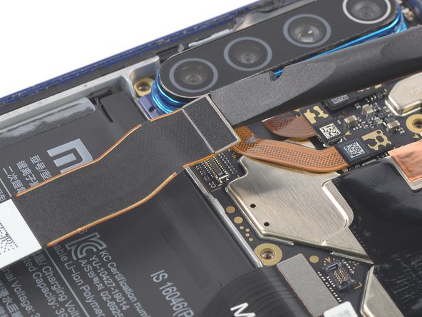

  14. Xiaomi Redmi Note 8 Screen Replacement, Disconnect the display flex cable: crwdns2935265:014crwdnd2935265:01crwdnd2935265:02crwdne2935265:0 Xiaomi Redmi Note 8 Screen Replacement, Disconnect the display flex cable: crwdns2935265:014crwdnd2935265:02crwdnd2935265:02crwdne2935265:0
    • Use a spudger to disconnect the display flex cable by prying the connector straight up from its socket.

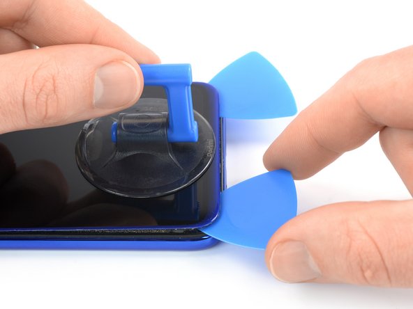

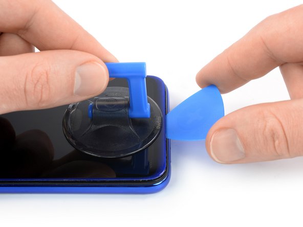

  19. Xiaomi Redmi Note 8 Screen Replacement, Insert an opening pick: crwdns2935265:019crwdnd2935265:01crwdnd2935265:03crwdne2935265:0 Xiaomi Redmi Note 8 Screen Replacement, Insert an opening pick: crwdns2935265:019crwdnd2935265:02crwdnd2935265:03crwdne2935265:0 Xiaomi Redmi Note 8 Screen Replacement, Insert an opening pick: crwdns2935265:019crwdnd2935265:03crwdnd2935265:03crwdne2935265:0
    • Once the screen is warm to touch, apply a suction cup to the bottom edge of the phone.
    • If your screen is badly cracked, covering it with a layer of clear packing tape may allow the suction cup to adhere. Alternatively, very strong tape may be used instead of the suction cup. If all else fails, you can superglue the suction cup to the screen.
    • Lift the screen with the suction handle to create a small gap between the screen and the midframe.
    • Insert an opening pick in the gap between the midframe and the screen.
    • In case you only want to replace the display glass but not the LCD and digitizer you need to be especially carful during the next step. There's a small cable at the bottom right end of the LCD which is very fragile. Only slide with the very tip of your opening pick (about 1-2 mm).
    • Slide the opening pick to the bottom right corner of the screen to slice its adhesive. Leave the opening pick in place to prevent the adhesive from resealing.

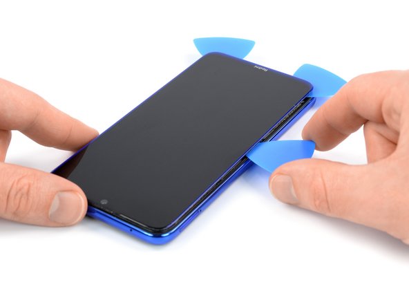

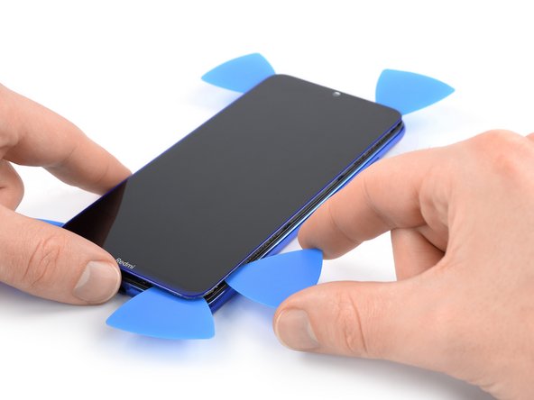

  20. Xiaomi Redmi Note 8 Screen Replacement, Slice the adhesive: crwdns2935265:020crwdnd2935265:01crwdnd2935265:02crwdne2935265:0 Xiaomi Redmi Note 8 Screen Replacement, Slice the adhesive: crwdns2935265:020crwdnd2935265:02crwdnd2935265:02crwdne2935265:0
    • Insert a second opening pick and slide it to the bottom left corner of the screen to cut the adhesive.
    • Leave the opening picks in place to prevent the adhesive from resealing.

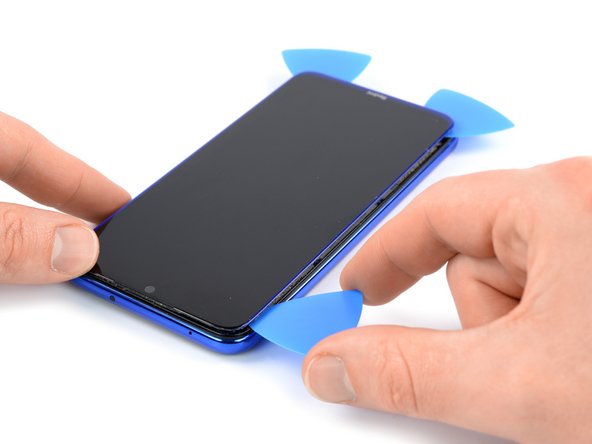

  21. Xiaomi Redmi Note 8 Screen Replacement: crwdns2935265:021crwdnd2935265:01crwdnd2935265:03crwdne2935265:0 Xiaomi Redmi Note 8 Screen Replacement: crwdns2935265:021crwdnd2935265:02crwdnd2935265:03crwdne2935265:0 Xiaomi Redmi Note 8 Screen Replacement: crwdns2935265:021crwdnd2935265:03crwdnd2935265:03crwdne2935265:0
    • If the adhesive becomes hard to cut, it has most likely cooled down. Use your iOpener or heat gun for 1-2 minutes to reheat it.
    • Insert a third opening pick underneath the bottom left corner of the screen.
    • Slide the opening pick along the left edge of the screen to slice the adhesive. Leave it in the top left corner to prevent the adhesive from resealing.

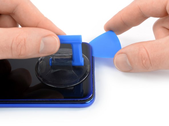

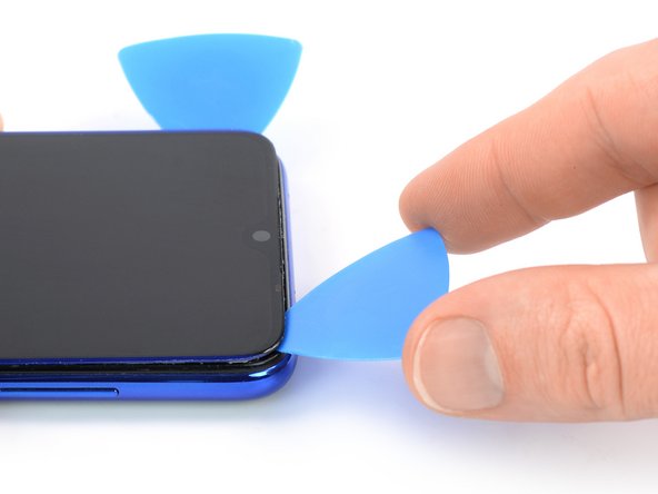

  22. Xiaomi Redmi Note 8 Screen Replacement: crwdns2935265:022crwdnd2935265:01crwdnd2935265:02crwdne2935265:0 Xiaomi Redmi Note 8 Screen Replacement: crwdns2935265:022crwdnd2935265:02crwdnd2935265:02crwdne2935265:0
    • When you slice near the front facing camera, insert only the tip of the opening pick (about 3-4 mm) to avoid damaging or smearing the camera.
    • Insert a fourth opening pick at the top left corner of the screen.
    • Slide the opening pick along the top edge of the phone to slice the adhesive.
    • Leave the opening pick in the top right corner of the screen to prevent the adhesive from resealing.
  23. Xiaomi Redmi Note 8 Screen Replacement: crwdns2935265:023crwdnd2935265:01crwdnd2935265:02crwdne2935265:0 Xiaomi Redmi Note 8 Screen Replacement: crwdns2935265:023crwdnd2935265:02crwdnd2935265:02crwdne2935265:0
    • Insert a fifth opening pick and slide it along the right edge of the phone to slice the remaining adhesive.
    • Do not try to remove the display all the way yet, the display cable is still threaded through the frame.
