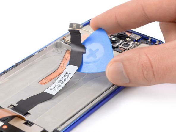

  25. Xiaomi Redmi Note 8 Pro Screen Replacement, Loosen the display adhesive: crwdns2935265:025crwdnd2935265:01crwdnd2935265:01crwdne2935265:0
    • Apply a heated iOpener or a heat gun to the screen to loosen the adhesive underneath. Apply the iOpener for at least two minutes.

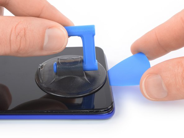

  26. Xiaomi Redmi Note 8 Pro Screen Replacement, Insert an opening pick: crwdns2935265:026crwdnd2935265:01crwdnd2935265:03crwdne2935265:0 Xiaomi Redmi Note 8 Pro Screen Replacement, Insert an opening pick: crwdns2935265:026crwdnd2935265:02crwdnd2935265:03crwdne2935265:0 Xiaomi Redmi Note 8 Pro Screen Replacement, Insert an opening pick: crwdns2935265:026crwdnd2935265:03crwdnd2935265:03crwdne2935265:0
    • Once the screen is warm to touch, apply a suction cup to the bottom edge of the phone.
    • If your screen is badly cracked, covering it with a layer of clear packing tape may allow the suction cup to adhere. Alternatively, very strong tape may be used instead of the suction cup. If all else fails, you can superglue the suction cup to the screen.
    • Lift the screen with the suction handle to create a small gap between the screen and the midframe.
    • Insert an opening pick in the gap between the midframe and the screen.
    • Slide the opening pick to the bottom right corner of the screen to slice its adhesive. Leave the opening pick in place to prevent the adhesive from resealing.

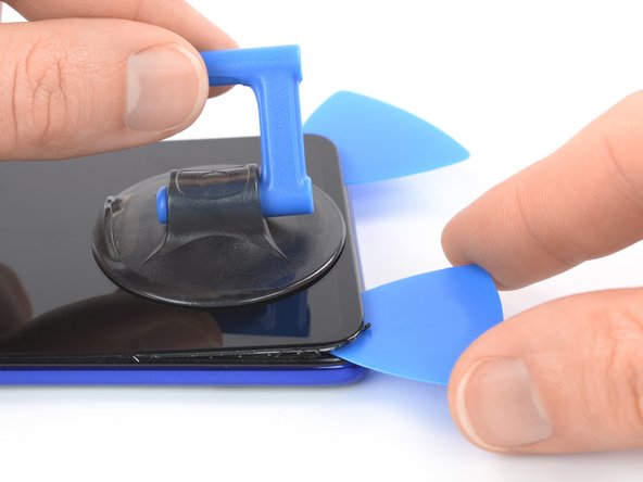

  27. Xiaomi Redmi Note 8 Pro Screen Replacement, Slice the adhesive: crwdns2935265:027crwdnd2935265:01crwdnd2935265:02crwdne2935265:0 Xiaomi Redmi Note 8 Pro Screen Replacement, Slice the adhesive: crwdns2935265:027crwdnd2935265:02crwdnd2935265:02crwdne2935265:0
    • Insert a second opening pick and slide it to the bottom left corner of the screen to cut the adhesive.
    • Leave the opening picks in place to prevent the adhesive from resealing.

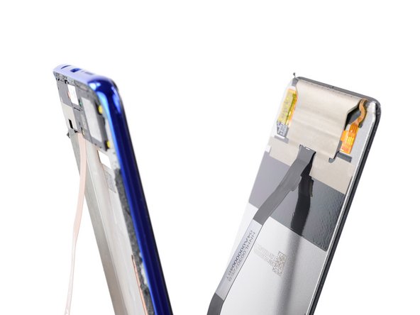

  30. Xiaomi Redmi Note 8 Pro Screen Replacement: crwdns2935265:030crwdnd2935265:01crwdnd2935265:02crwdne2935265:0 Xiaomi Redmi Note 8 Pro Screen Replacement: crwdns2935265:030crwdnd2935265:02crwdnd2935265:02crwdne2935265:0
    • Insert a fifth opening pick and slide it along the right edge of the phone to slice the remaining adhesive.
    • Do not try to remove the display all the way yet, the display cable is still threaded through the frame.

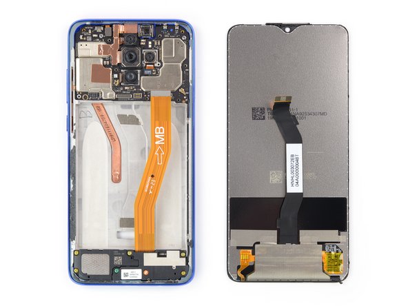

  31. Xiaomi Redmi Note 8 Pro Screen Replacement, Remove the screen: crwdns2935265:031crwdnd2935265:01crwdnd2935265:03crwdne2935265:0 Xiaomi Redmi Note 8 Pro Screen Replacement, Remove the screen: crwdns2935265:031crwdnd2935265:02crwdnd2935265:03crwdne2935265:0 Xiaomi Redmi Note 8 Pro Screen Replacement, Remove the screen: crwdns2935265:031crwdnd2935265:03crwdnd2935265:03crwdne2935265:0
    • Thread the display flex cable through the gap in the midframe and remove the screen.
    • Compare your new replacement part to the original part—you may need to transfer remaining components like the speaker grill from your old screen to your new screen.
    • Apply new adhesive where it's necessary after cleaning the relevant areas with isopropyl alcohol (>90%).
