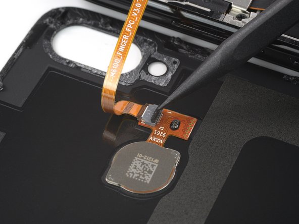

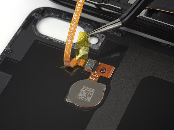

    1. Xiaomi Redmi Note 7 Screen Replacement, Peel the protective foil off: crwdns2935265:011crwdnd2935265:01crwdnd2935265:02crwdne2935265:0 Xiaomi Redmi Note 7 Screen Replacement, Peel the protective foil off: crwdns2935265:011crwdnd2935265:02crwdnd2935265:02crwdne2935265:0
      • For easier handling during repairs we highly recommend to separate the back cover including the fingerprint sensor from the phone assembly.
      • Use a pair of tweezers to carefully peel the yellow protective foil off the ZIF connector.
    2. Xiaomi Redmi Note 7 Screen Replacement, Open the ZIF connector: crwdns2935265:012crwdnd2935265:01crwdnd2935265:02crwdne2935265:0 Xiaomi Redmi Note 7 Screen Replacement, Open the ZIF connector: crwdns2935265:012crwdnd2935265:02crwdnd2935265:02crwdne2935265:0
      • Use the pointed end of a spudger to open the ZIF connector by bringing its black flap in an upright position.
    3. Xiaomi Redmi Note 7 Screen Replacement, Disconnect the fingerprint flex cable: crwdns2935265:013crwdnd2935265:01crwdnd2935265:02crwdne2935265:0 Xiaomi Redmi Note 7 Screen Replacement, Disconnect the fingerprint flex cable: crwdns2935265:013crwdnd2935265:02crwdnd2935265:02crwdne2935265:0
      • Disconnect the fingerprint flex cable by pulling it straight out off the ZIF connector using a pair of tweezers.

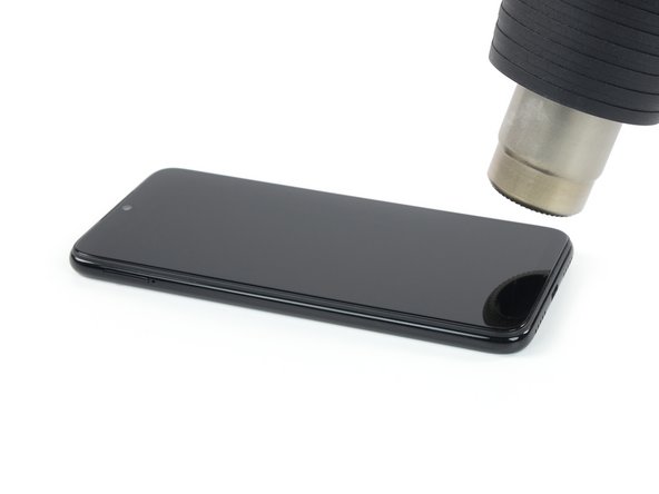

    4. Xiaomi Redmi Note 7 Screen Replacement, Loosen the display adhesive: crwdns2935265:019crwdnd2935265:01crwdnd2935265:02crwdne2935265:0 Xiaomi Redmi Note 7 Screen Replacement, Loosen the display adhesive: crwdns2935265:019crwdnd2935265:02crwdnd2935265:02crwdne2935265:0
      • Apply a heated iOpener or a heat gun to the screen to loosen the adhesive underneath. Apply the iOpener for at least two minutes.

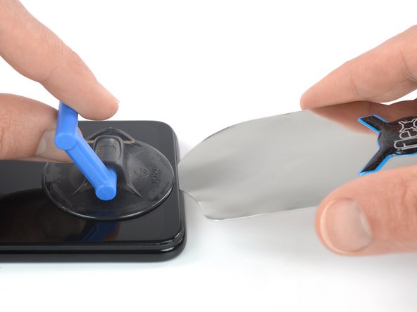

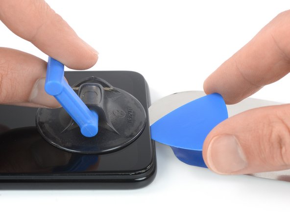

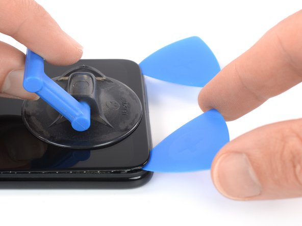

    5. Xiaomi Redmi Note 7 Screen Replacement, Insert an iFlex: crwdns2935265:020crwdnd2935265:01crwdnd2935265:02crwdne2935265:0 Xiaomi Redmi Note 7 Screen Replacement, Insert an iFlex: crwdns2935265:020crwdnd2935265:02crwdnd2935265:02crwdne2935265:0
      • Once the screen is warm to touch, apply a suction cup to the bottom edge of the phone.
      • If your rear glass is badly cracked, covering it with a layer of clear packing tape may allow the suction cup to adhere. Alternatively, very strong tape may be used instead of the suction cup. If all else fails, you can superglue the suction cup to the rear glass.
      • Lift the screen with the suction handle to create a small gap between the screen and the frame.
      • Insert the tip of an iFlex in the gap between the midframe and the screen.

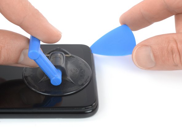

    6. Xiaomi Redmi Note 7 Screen Replacement, Insert an opening pick: crwdns2935265:021crwdnd2935265:01crwdnd2935265:03crwdne2935265:0 Xiaomi Redmi Note 7 Screen Replacement, Insert an opening pick: crwdns2935265:021crwdnd2935265:02crwdnd2935265:03crwdne2935265:0 Xiaomi Redmi Note 7 Screen Replacement, Insert an opening pick: crwdns2935265:021crwdnd2935265:03crwdnd2935265:03crwdne2935265:0
      • Insert the tip of an opening pick in the gap between the midframe and the screen, next to the iFlex.
      • Remove the iFlex.
      • Slide the opening pick to the bottom right corner to cut the adhesive. Leave it in its place to prevent the adhesive from resealing.

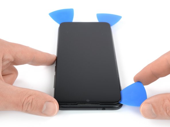

    7. Xiaomi Redmi Note 7 Screen Replacement, Cut the adhesive: crwdns2935265:022crwdnd2935265:01crwdnd2935265:02crwdne2935265:0 Xiaomi Redmi Note 7 Screen Replacement, Cut the adhesive: crwdns2935265:022crwdnd2935265:02crwdnd2935265:02crwdne2935265:0
      • Insert a second opening pick and slide it to the bottom left corner of the screen to cut the adhesive.
      • Leave the opening picks in place to prevent the adhesive from resealing.

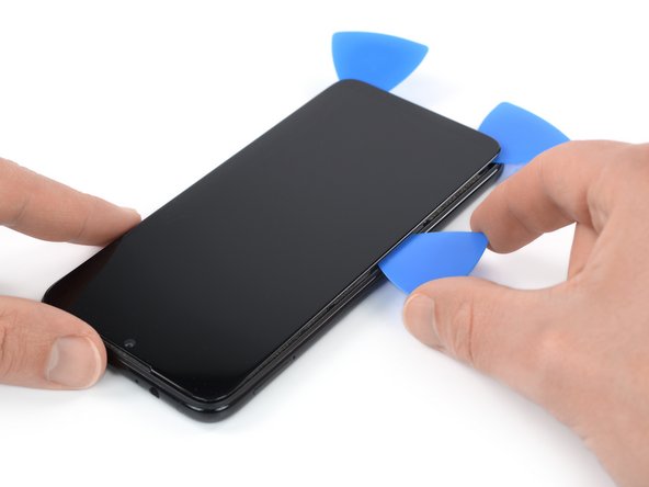

    8. Xiaomi Redmi Note 7 Screen Replacement, Cut the lefthand-side adhesive: crwdns2935265:023crwdnd2935265:01crwdnd2935265:03crwdne2935265:0 Xiaomi Redmi Note 7 Screen Replacement, Cut the lefthand-side adhesive: crwdns2935265:023crwdnd2935265:02crwdnd2935265:03crwdne2935265:0 Xiaomi Redmi Note 7 Screen Replacement, Cut the lefthand-side adhesive: crwdns2935265:023crwdnd2935265:03crwdnd2935265:03crwdne2935265:0
      • If the adhesive becomes hard to cut, it has most likely cooled down. Use your iOpener or heat gun to reheat it.
      • Insert a third opening pick under the bottom left corner of the phone.
      • Slide the opening pick up to the top left corner to cut the adhesive. Leave it in to prevent the adhesive from resealing.

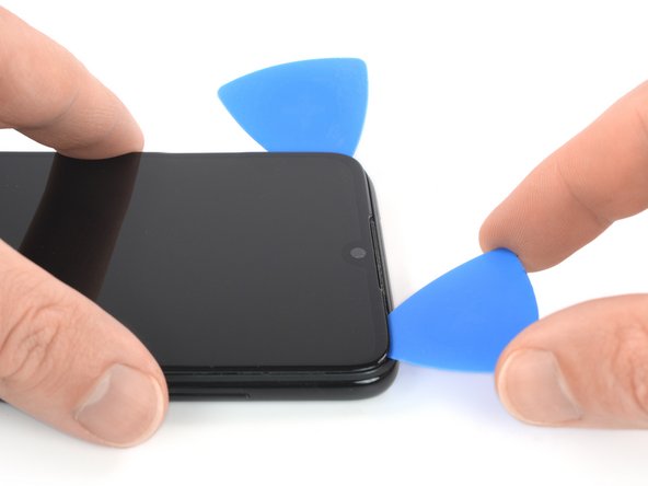

    9. Xiaomi Redmi Note 7 Screen Replacement, Cut the top edge adhesive: crwdns2935265:024crwdnd2935265:01crwdnd2935265:02crwdne2935265:0 Xiaomi Redmi Note 7 Screen Replacement, Cut the top edge adhesive: crwdns2935265:024crwdnd2935265:02crwdnd2935265:02crwdne2935265:0
      • Insert a fourth opening pick at the top left corner.
      • Slide the opening pick along the top edge of the phone to cut the adhesive. Leave the opening pick in the top right corner of the screen to prevent the adhesive from resealing.
      • When you slice near the front facing camera, insert only the tip of the opening pick to avoid damaging or smearing the camera.

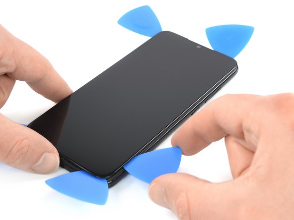

    10. Xiaomi Redmi Note 7 Screen Replacement, Cut the righthand-side adhesive: crwdns2935265:025crwdnd2935265:01crwdnd2935265:02crwdne2935265:0 Xiaomi Redmi Note 7 Screen Replacement, Cut the righthand-side adhesive: crwdns2935265:025crwdnd2935265:02crwdnd2935265:02crwdne2935265:0
      • Insert a fifth opening pick and slide it along the right edge of the phone to cut the remaining adhesive.
      • Do not try to remove the display all the way yet, the display cable is still threaded through the frame and possibly adhered on the inner side of the midframe.

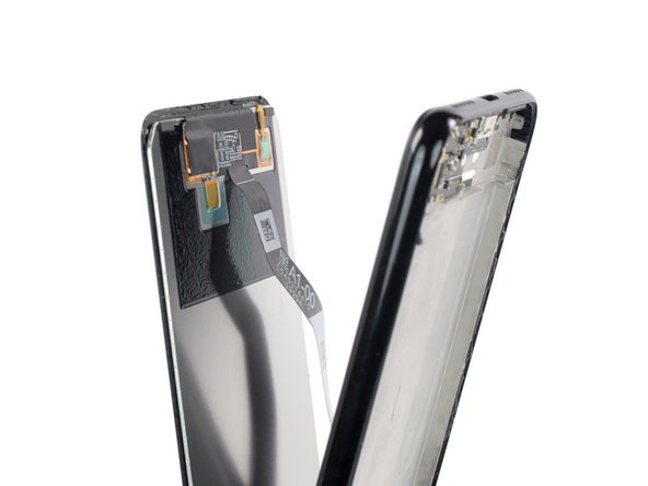

    11. Xiaomi Redmi Note 7 Screen Replacement, Remove the screen: crwdns2935265:026crwdnd2935265:01crwdnd2935265:03crwdne2935265:0 Xiaomi Redmi Note 7 Screen Replacement, Remove the screen: crwdns2935265:026crwdnd2935265:02crwdnd2935265:03crwdne2935265:0 Xiaomi Redmi Note 7 Screen Replacement, Remove the screen: crwdns2935265:026crwdnd2935265:03crwdnd2935265:03crwdne2935265:0
      • Thread the display flex cable through the gap in the midframe and remove the screen.
      • The upper speaker grill of the Redmi Note 7 is likely to fall off during this procedure. Avoid loosing it during the screen removal.
