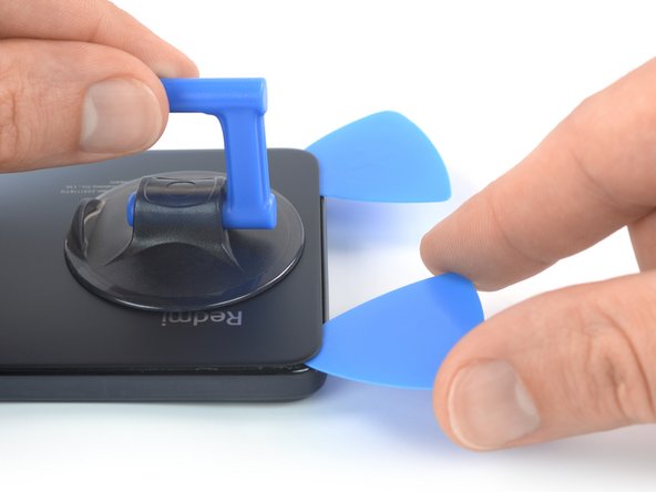

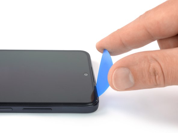

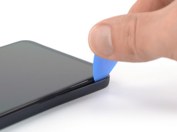

  2. Xiaomi Redmi Note 11 Pro Screen Replacement, Insert an opening pick: crwdns2935265:02crwdnd2935265:01crwdnd2935265:03crwdne2935265:0 Xiaomi Redmi Note 11 Pro Screen Replacement, Insert an opening pick: crwdns2935265:02crwdnd2935265:02crwdnd2935265:03crwdne2935265:0 Xiaomi Redmi Note 11 Pro Screen Replacement, Insert an opening pick: crwdns2935265:02crwdnd2935265:03crwdnd2935265:03crwdne2935265:0
    • Secure a suction handle to the bottom edge of the rear glass, as close to the edge as possible.
    • If the rear glass is cracked, the suction handle may not stick. Try lifting it with strong tape, or superglue the suction handle in place and allow it to cure so you can proceed.
    • Lift the rear glass with the suction handle to create a small gap between the back cover and the frame.
    • If you're having trouble creating a gap, apply more heat to further soften the adhesive. Follow the iOpener instructions to avoid overheating.
    • Insert an opening pick into the gap you created.
    • Slide the opening pick to the bottom right corner to slice the adhesive.
    • Leave the opening pick in place to prevent the adhesive from resealing.

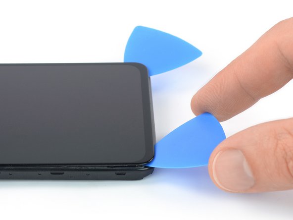

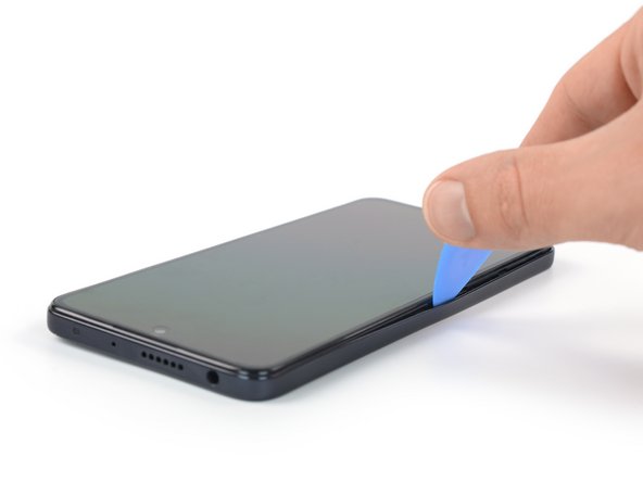

  3. Xiaomi Redmi Note 11 Pro Screen Replacement, Slice the bottom edge adhesive: crwdns2935265:03crwdnd2935265:01crwdnd2935265:02crwdne2935265:0 Xiaomi Redmi Note 11 Pro Screen Replacement, Slice the bottom edge adhesive: crwdns2935265:03crwdnd2935265:02crwdnd2935265:02crwdne2935265:0
    • Insert a second opening pick at the bottom edge of your phone.
    • Slide the opening pick to the bottom left corner to slice the adhesive.
    • Leave the opening picks in place to prevent the adhesive from resealing.

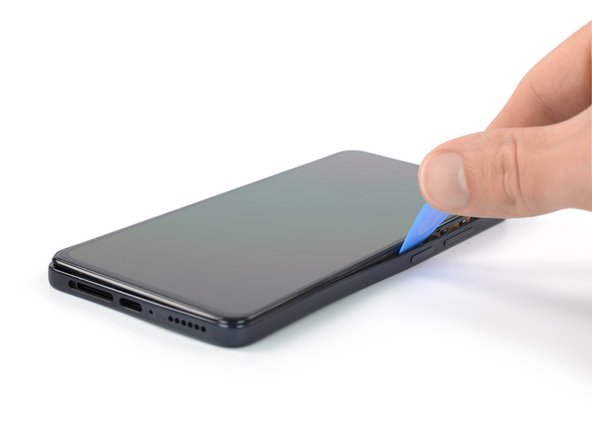

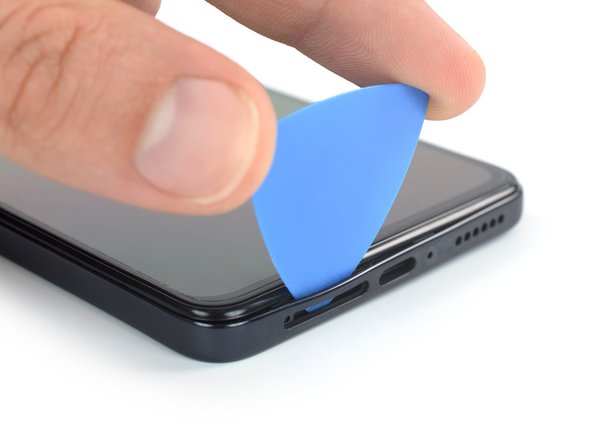

  4. Xiaomi Redmi Note 11 Pro Screen Replacement, Slice the left edge adhesive: crwdns2935265:04crwdnd2935265:01crwdnd2935265:03crwdne2935265:0 Xiaomi Redmi Note 11 Pro Screen Replacement, Slice the left edge adhesive: crwdns2935265:04crwdnd2935265:02crwdnd2935265:03crwdne2935265:0 Xiaomi Redmi Note 11 Pro Screen Replacement, Slice the left edge adhesive: crwdns2935265:04crwdnd2935265:03crwdnd2935265:03crwdne2935265:0
    • If the adhesive becomes hard to cut, it has most likely cooled down. Use your iOpener for one to two minutes to reheat it.
    • Insert a third opening pick at the bottom left corner of your phone.
    • Slide the opening pick along the left edge of your phone to slice the adhesive.
    • Leave the opening pick in the top left corner to prevent the adhesive from resealing.

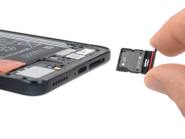

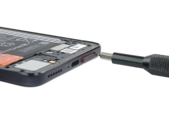

  8. Xiaomi Redmi Note 11 Pro Screen Replacement, Eject the SIM card tray: crwdns2935265:08crwdnd2935265:01crwdnd2935265:03crwdne2935265:0 Xiaomi Redmi Note 11 Pro Screen Replacement, Eject the SIM card tray: crwdns2935265:08crwdnd2935265:02crwdnd2935265:03crwdne2935265:0 Xiaomi Redmi Note 11 Pro Screen Replacement, Eject the SIM card tray: crwdns2935265:08crwdnd2935265:03crwdnd2935265:03crwdne2935265:0
    • Insert a SIM card eject tool, a SIM eject bit, or a straightened paper clip into the hole on the SIM tray located at the bottom edge of the phone.
    • Press directly into the hole to eject the SIM card tray.
    • Remove the SIM card tray.
    • If you accidentally inserted the SIM eject tool into a microphone hole, don't worry! You most likely didn't damage the microphone.

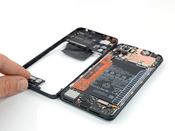

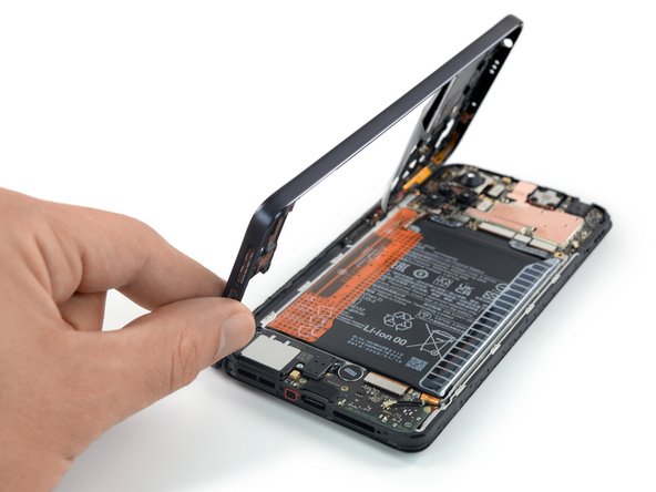

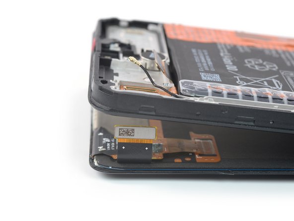

  15. Xiaomi Redmi Note 11 Pro Screen Replacement, Free the midframe cable connector: crwdns2935265:015crwdnd2935265:01crwdnd2935265:03crwdne2935265:0 Xiaomi Redmi Note 11 Pro Screen Replacement, Free the midframe cable connector: crwdns2935265:015crwdnd2935265:02crwdnd2935265:03crwdne2935265:0 Xiaomi Redmi Note 11 Pro Screen Replacement, Free the midframe cable connector: crwdns2935265:015crwdnd2935265:03crwdnd2935265:03crwdne2935265:0
    • Carefully swing open the midframe to the left like you would open the front cover of a book to get free access to its cable connector.
    • Place the midframe next to the left edge of the front panel assembly.

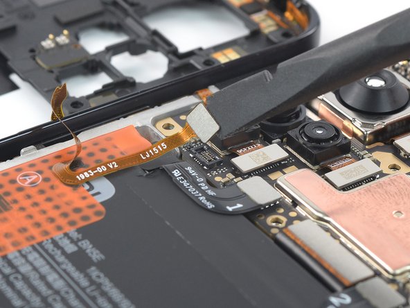

  16. Xiaomi Redmi Note 11 Pro Screen Replacement, Disconnect the midframe cable: crwdns2935265:016crwdnd2935265:01crwdnd2935265:02crwdne2935265:0 Xiaomi Redmi Note 11 Pro Screen Replacement, Disconnect the midframe cable: crwdns2935265:016crwdnd2935265:02crwdnd2935265:02crwdne2935265:0
    • Use a spudger to disconnect the midframe cable by prying the connector straight up from its socket.
  17. Xiaomi Redmi Note 11 Pro Screen Replacement, Remove the midframe: crwdns2935265:017crwdnd2935265:01crwdnd2935265:01crwdne2935265:0
    • Remove the midframe.

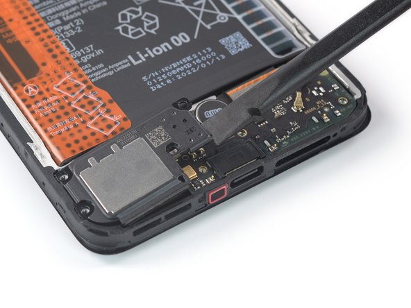

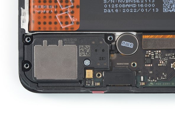

  19. Xiaomi Redmi Note 11 Pro Screen Replacement, Unfasten the loudspeaker screw: crwdns2935265:019crwdnd2935265:01crwdnd2935265:02crwdne2935265:0 Xiaomi Redmi Note 11 Pro Screen Replacement, Unfasten the loudspeaker screw: crwdns2935265:019crwdnd2935265:02crwdnd2935265:02crwdne2935265:0
    • Use a Phillips screwdriver to remove the 3.6 mm-long screw securing the loudspeaker.
  20. Xiaomi Redmi Note 11 Pro Screen Replacement, Pry up the loudspeaker: crwdns2935265:020crwdnd2935265:01crwdnd2935265:02crwdne2935265:0 Xiaomi Redmi Note 11 Pro Screen Replacement, Pry up the loudspeaker: crwdns2935265:020crwdnd2935265:02crwdnd2935265:02crwdne2935265:0
    • The loudspeaker of the Xiaomi Redmi Note 11 Pro is held in place by plastic clips.
    • Insert an spudger underneath the right edge of the loudspeaker.
    • Use your spudger to pry up the loudspeaker.

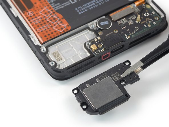

  21. Xiaomi Redmi Note 11 Pro Screen Replacement, Remove the loudspeaker: crwdns2935265:021crwdnd2935265:01crwdnd2935265:02crwdne2935265:0 Xiaomi Redmi Note 11 Pro Screen Replacement, Remove the loudspeaker: crwdns2935265:021crwdnd2935265:02crwdnd2935265:02crwdne2935265:0
    • Use your fingers or a pair of tweezers to remove the loudspeaker.

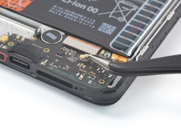

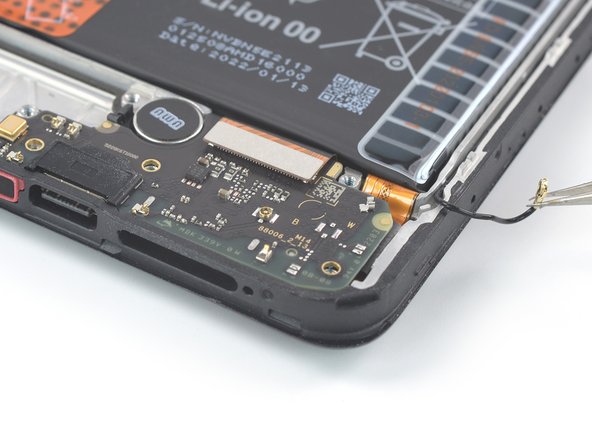

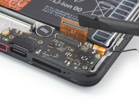

  22. Xiaomi Redmi Note 11 Pro Screen Replacement, Disconnect the black antenna cable: crwdns2935265:022crwdnd2935265:01crwdnd2935265:03crwdne2935265:0 Xiaomi Redmi Note 11 Pro Screen Replacement, Disconnect the black antenna cable: crwdns2935265:022crwdnd2935265:02crwdnd2935265:03crwdne2935265:0 Xiaomi Redmi Note 11 Pro Screen Replacement, Disconnect the black antenna cable: crwdns2935265:022crwdnd2935265:03crwdnd2935265:03crwdne2935265:0
    • Slide a pair of tweezers under the black coaxial cable until they're snug against the metal connector.
    • Disconnect the black coaxial cable by prying it straight up from the charging board.
    • Use your tweezers to carefully loosen the cable from its routing on the charging board and bend it to the side.

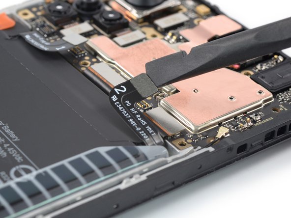

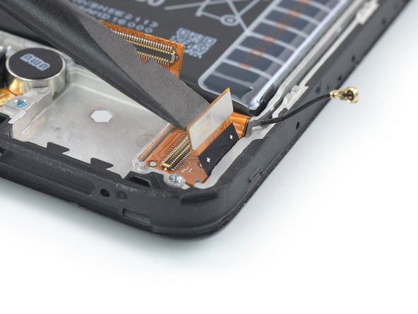

  23. Xiaomi Redmi Note 11 Pro Screen Replacement, Disconnect the interconnect cable: crwdns2935265:023crwdnd2935265:01crwdnd2935265:02crwdne2935265:0 Xiaomi Redmi Note 11 Pro Screen Replacement, Disconnect the interconnect cable: crwdns2935265:023crwdnd2935265:02crwdnd2935265:02crwdne2935265:0
    • Use a spudger to disconnect the interconnect cable by prying the connector straight up from its socket.
  24. Xiaomi Redmi Note 11 Pro Screen Replacement, Pry up the charging board: crwdns2935265:024crwdnd2935265:01crwdnd2935265:02crwdne2935265:0 Xiaomi Redmi Note 11 Pro Screen Replacement, Pry up the charging board: crwdns2935265:024crwdnd2935265:02crwdnd2935265:02crwdne2935265:0
    • Insert the pointed end of a spudger underneath the left edge of the charging board.
    • Use your spudger to pry up the charging board.
  25. Xiaomi Redmi Note 11 Pro Screen Replacement, Remove the charging board: crwdns2935265:025crwdnd2935265:01crwdnd2935265:02crwdne2935265:0 Xiaomi Redmi Note 11 Pro Screen Replacement, Remove the charging board: crwdns2935265:025crwdnd2935265:02crwdnd2935265:02crwdne2935265:0
    • Use a pair of tweezers of your fingers to carefully remove the charging board.

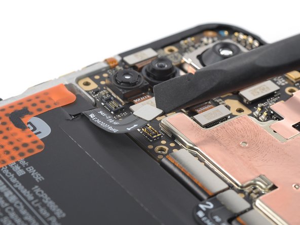

  26. Xiaomi Redmi Note 11 Pro Screen Replacement, Disconnect the display cable: crwdns2935265:026crwdnd2935265:01crwdnd2935265:02crwdne2935265:0 Xiaomi Redmi Note 11 Pro Screen Replacement, Disconnect the display cable: crwdns2935265:026crwdnd2935265:02crwdnd2935265:02crwdne2935265:0
    • Use a spudger to disconnect the display cable by prying the connector straight up from its socket.

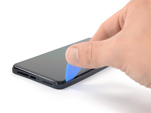

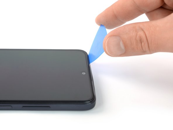

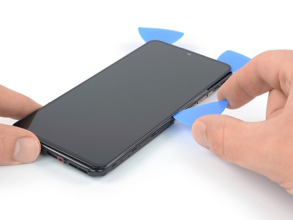

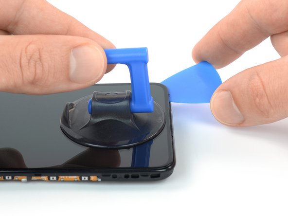

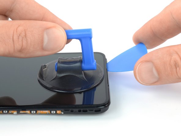

  28. Xiaomi Redmi Note 11 Pro Screen Replacement, Insert an opening pick: crwdns2935265:028crwdnd2935265:01crwdnd2935265:03crwdne2935265:0 Xiaomi Redmi Note 11 Pro Screen Replacement, Insert an opening pick: crwdns2935265:028crwdnd2935265:02crwdnd2935265:03crwdne2935265:0 Xiaomi Redmi Note 11 Pro Screen Replacement, Insert an opening pick: crwdns2935265:028crwdnd2935265:03crwdnd2935265:03crwdne2935265:0
    • Once the screen is warm to touch, apply a suction handle to the top edge of the screen and as close to the edge as possible.
    • If your screen is badly cracked, covering it with a layer of clear packing tape may allow the suction cup to adhere. Alternatively, very strong tape may be used instead of the suction handle. If all else fails, you can superglue the suction cup to the screen.
    • Lift the screen with the suction handle to create a small gap between the screen and the frame.
    • Insert an opening pick into the gap between the midframe and the screen, at the left side of the earpiece speaker cut-out.
    • Slide the opening pick to the top left corner of the screen to slice its adhesive.

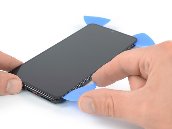

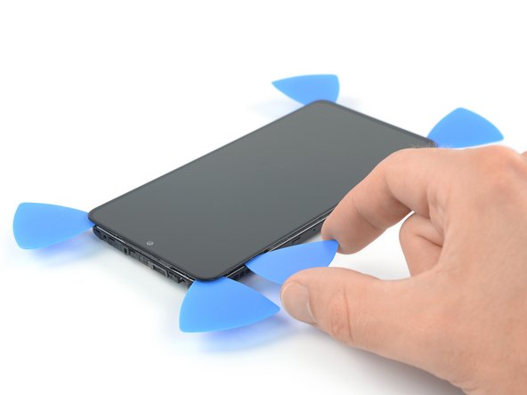

  31. Xiaomi Redmi Note 11 Pro Screen Replacement: crwdns2935265:031crwdnd2935265:01crwdnd2935265:02crwdne2935265:0 Xiaomi Redmi Note 11 Pro Screen Replacement: crwdns2935265:031crwdnd2935265:02crwdnd2935265:02crwdne2935265:0
    • Insert a fourth opening pick underneath the bottom right corner of the screen.
    • Slide the opening pick along the bottom edge of the screen to slice the adhesive.
    • Leave the opening pick in the bottom left corner to prevent the adhesive from resealing.
  32. Xiaomi Redmi Note 11 Pro Screen Replacement: crwdns2935265:032crwdnd2935265:01crwdnd2935265:02crwdne2935265:0 Xiaomi Redmi Note 11 Pro Screen Replacement: crwdns2935265:032crwdnd2935265:02crwdnd2935265:02crwdne2935265:0
    • Insert a fifth opening pick at the bottom left corner of the screen.
    • Slide the opening pick along the left edge to slice the remaining adhesive.
    • Do not try to remove the display all the way yet. The display cable is still threaded through the frame.

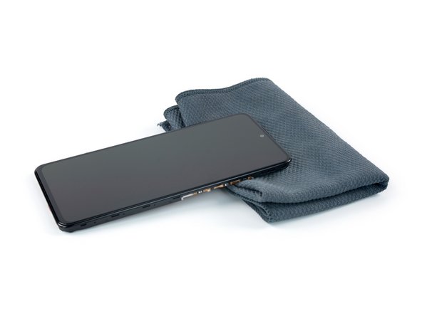

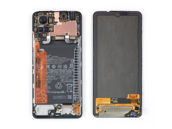

  33. Xiaomi Redmi Note 11 Pro Screen Replacement, Remove the screen: crwdns2935265:033crwdnd2935265:01crwdnd2935265:03crwdne2935265:0 Xiaomi Redmi Note 11 Pro Screen Replacement, Remove the screen: crwdns2935265:033crwdnd2935265:02crwdnd2935265:03crwdne2935265:0 Xiaomi Redmi Note 11 Pro Screen Replacement, Remove the screen: crwdns2935265:033crwdnd2935265:03crwdnd2935265:03crwdne2935265:0
    • Carefully thread the display cable through the gap in the midframe.
    • Remove the screen.
    • Apply new adhesive where it's necessary after cleaning the relevant areas with isopropyl alcohol (>90%).
    • During reassembly, follow this guide in case you're using a pre-cut adhesive card.
