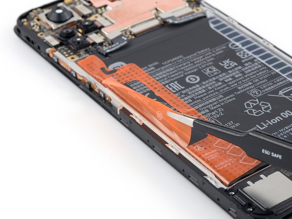

  19. Xiaomi Redmi Note 11 Pro Battery Replacement, Peel off the battery pull-tabs: crwdns2935265:019crwdnd2935265:01crwdnd2935265:03crwdne2935265:0 Xiaomi Redmi Note 11 Pro Battery Replacement, Peel off the battery pull-tabs: crwdns2935265:019crwdnd2935265:02crwdnd2935265:03crwdne2935265:0 Xiaomi Redmi Note 11 Pro Battery Replacement, Peel off the battery pull-tabs: crwdns2935265:019crwdnd2935265:03crwdnd2935265:03crwdne2935265:0
    • Take care not to puncture or bend the battery with your tool—a punctured or bent battery may leak dangerous chemicals or cause a fire.
    • Use a pair of blunt nose tweezers or a clean fingernail to peel the orange adhesive strip labeled with an A off the battery.

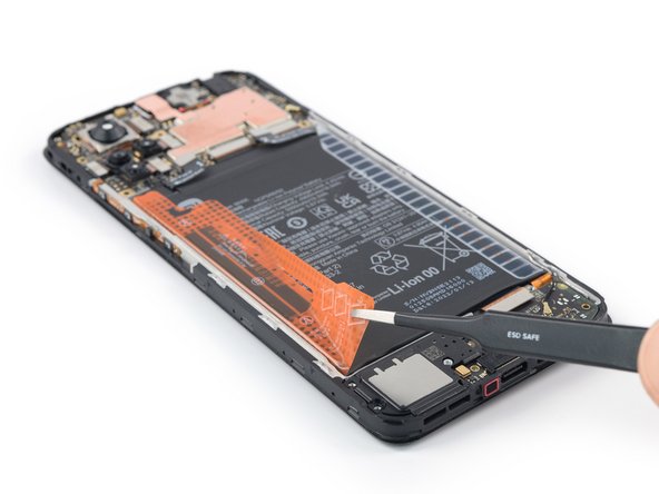

  20. Xiaomi Redmi Note 11 Pro Battery Replacement: crwdns2935265:020crwdnd2935265:01crwdnd2935265:02crwdne2935265:0 Xiaomi Redmi Note 11 Pro Battery Replacement: crwdns2935265:020crwdnd2935265:02crwdnd2935265:02crwdne2935265:0
    • Repeat the previous pull-tab procedure on the orange adhesive strip labeled with a B.

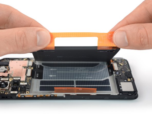

  21. Xiaomi Redmi Note 11 Pro Battery Replacement, Lift the battery: crwdns2935265:021crwdnd2935265:01crwdnd2935265:02crwdne2935265:0 Xiaomi Redmi Note 11 Pro Battery Replacement, Lift the battery: crwdns2935265:021crwdnd2935265:02crwdnd2935265:02crwdne2935265:0
    • Grab both pull-tab ends labeled with an A and pull up on the adhesive strip to lift the battery out of its recess and swing it up to an upright position.
    • If you're having trouble lifting the battery out of its recess, apply a heated iOpener to the screen for two minutes to loosen the battery adhesive.
    • A hair dryer, heat gun, or hot plate may also be used, but be careful not to overheat the device.
  22. Xiaomi Redmi Note 11 Pro Battery Replacement, Remove the battery: crwdns2935265:022crwdnd2935265:01crwdnd2935265:03crwdne2935265:0 Xiaomi Redmi Note 11 Pro Battery Replacement, Remove the battery: crwdns2935265:022crwdnd2935265:02crwdnd2935265:03crwdne2935265:0 Xiaomi Redmi Note 11 Pro Battery Replacement, Remove the battery: crwdns2935265:022crwdnd2935265:03crwdnd2935265:03crwdne2935265:0
    • Peel the battery off the remaining adhesive.
    • Remove the battery.
    • Do not reinstall a damaged or deformed battery, as doing so is a potential safety hazard.
    • Secure the new battery with pre-cut adhesive or double-sided adhesive tape. In order to position it correctly, apply the new adhesive into the device at the places where the old adhesive was located, not directly onto the battery. Press the new battery firmly into place.
    • During reassembly, temporarily reconnect the battery to the motherboard to help align it correctly. Disconnect the battery after it is seated.
