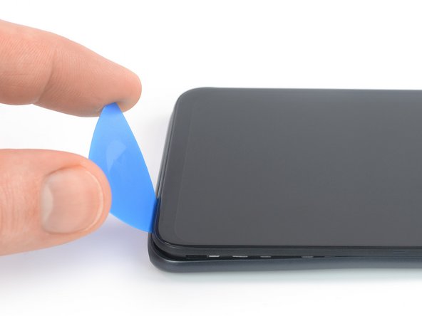

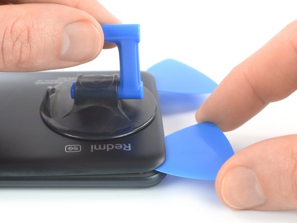

  2. Xiaomi Redmi Note 10 5G Screen Replacement, Insert an opening pick: crwdns2935265:02crwdnd2935265:01crwdnd2935265:03crwdne2935265:0 Xiaomi Redmi Note 10 5G Screen Replacement, Insert an opening pick: crwdns2935265:02crwdnd2935265:02crwdnd2935265:03crwdne2935265:0 Xiaomi Redmi Note 10 5G Screen Replacement, Insert an opening pick: crwdns2935265:02crwdnd2935265:03crwdnd2935265:03crwdne2935265:0
    • Secure a suction handle to the bottom edge of the back cover, as close to the edge as possible.
    • If the back cover is cracked, the suction handle may not stick. Try lifting it with strong tape, or superglue the suction handle in place and allow it to cure so you can proceed.
    • Lift the back cover with the suction handle to create a small gap between the back cover and the frame.
    • If you have trouble creating a gap, apply more heat to further soften the adhesive. Follow the iOpener instructions to avoid overheating.
    • Insert an opening pick into the gap you created.
    • Slide the opening pick to the bottom right corner to slice the adhesive.
    • Leave the opening pick in place to prevent the adhesive from resealing.

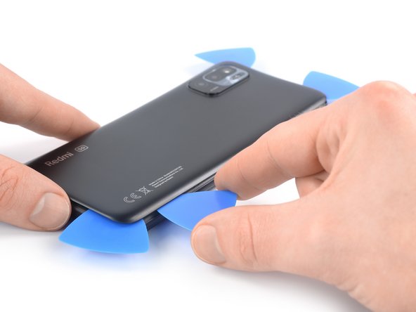

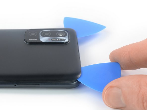

  3. Xiaomi Redmi Note 10 5G Screen Replacement, Slice the adhesive: crwdns2935265:03crwdnd2935265:01crwdnd2935265:02crwdne2935265:0 Xiaomi Redmi Note 10 5G Screen Replacement, Slice the adhesive: crwdns2935265:03crwdnd2935265:02crwdnd2935265:02crwdne2935265:0
    • Insert a second opening pick at the bottom edge of your phone.
    • Slide the opening pick to the bottom left corner to slice the adhesive.
    • Leave the opening picks in place to prevent the adhesive from resealing.

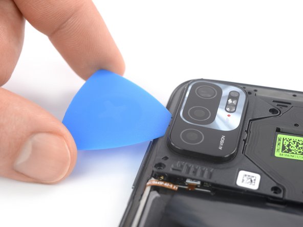

  9. Xiaomi Redmi Note 10 5G Screen Replacement, Pry up the camera cover: crwdns2935265:09crwdnd2935265:01crwdnd2935265:02crwdne2935265:0 Xiaomi Redmi Note 10 5G Screen Replacement, Pry up the camera cover: crwdns2935265:09crwdnd2935265:02crwdnd2935265:02crwdne2935265:0
    • Insert an opening pick into the gap between the left edge of the camera cover and the midframe.
    • Use your opening pick to pry up the camera cover by tilting it downwards.

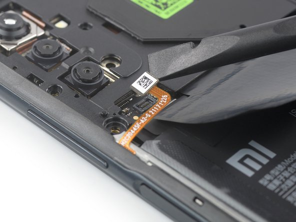

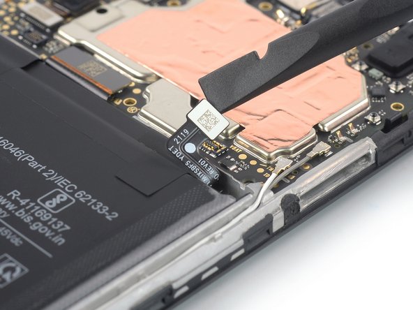

  13. Xiaomi Redmi Note 10 5G Screen Replacement, Disconnect the power and volume button flex cable: crwdns2935265:013crwdnd2935265:01crwdnd2935265:02crwdne2935265:0 Xiaomi Redmi Note 10 5G Screen Replacement, Disconnect the power and volume button flex cable: crwdns2935265:013crwdnd2935265:02crwdnd2935265:02crwdne2935265:0
    • Use a spudger to disconnect the power and volume button flex cable by prying the connector straight up from its socket.

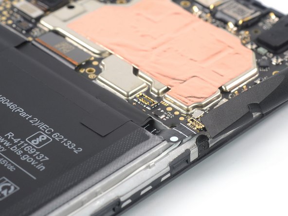

  20. Xiaomi Redmi Note 10 5G Screen Replacement, Disconnect the battery cable: crwdns2935265:020crwdnd2935265:01crwdnd2935265:03crwdne2935265:0 Xiaomi Redmi Note 10 5G Screen Replacement, Disconnect the battery cable: crwdns2935265:020crwdnd2935265:02crwdnd2935265:03crwdne2935265:0 Xiaomi Redmi Note 10 5G Screen Replacement, Disconnect the battery cable: crwdns2935265:020crwdnd2935265:03crwdnd2935265:03crwdne2935265:0
    • Use a spudger to disconnect the battery flex cable by prying the connector straight up from its socket.
    • Fold the battery cable to the side to get free access to the battery pull-tab.

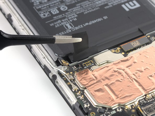

  21. Xiaomi Redmi Note 10 5G Screen Replacement, Remove the stretch-release adhesive: crwdns2935265:021crwdnd2935265:01crwdnd2935265:03crwdne2935265:0 Xiaomi Redmi Note 10 5G Screen Replacement, Remove the stretch-release adhesive: crwdns2935265:021crwdnd2935265:02crwdnd2935265:03crwdne2935265:0 Xiaomi Redmi Note 10 5G Screen Replacement, Remove the stretch-release adhesive: crwdns2935265:021crwdnd2935265:03crwdnd2935265:03crwdne2935265:0
    • The battery is secured to the rear case with two pieces of stretch-release adhesive.
    • Don't jab the battery with any sharp tools. A punctured battery may leak dangerous chemicals or catch fire.
    • Use a pair of blunt nose tweezers or a clean fingernail to peel up both battery adhesive pull-tabs to unstick them from the top edge of the battery.
  22. Xiaomi Redmi Note 10 5G Screen Replacement, Remove the pull-tabs: crwdns2935265:022crwdnd2935265:01crwdnd2935265:03crwdne2935265:0 Xiaomi Redmi Note 10 5G Screen Replacement, Remove the pull-tabs: crwdns2935265:022crwdnd2935265:02crwdnd2935265:03crwdne2935265:0 Xiaomi Redmi Note 10 5G Screen Replacement, Remove the pull-tabs: crwdns2935265:022crwdnd2935265:03crwdnd2935265:03crwdne2935265:0
    • Grab the first pull-tab with a pair of blunt nose tweezers or your fingers and slowly pull it away from the battery towards the top edge of your phone.
    • Pull hard enough to maintain tension on the strip, but don't force it. Give it plenty of time to stretch and unstick from under the battery.
    • Don't press down on the battery. Hold the phone firmly by its sides.
    • Keep the strip flat and unwrinkled. Try to pull evenly on the whole strip, rather than pulling in the middle or on one side.
    • Pull at a low angle so the strip doesn't snag on the edge of the battery.
    • If the adhesive strip breaks off, try to retrieve it using your fingers or blunt tweezers, and continue pulling—but do not pry under the battery.
    • If the adhesive breaks off underneath the battery and can't be retrieved, continue with the next step.

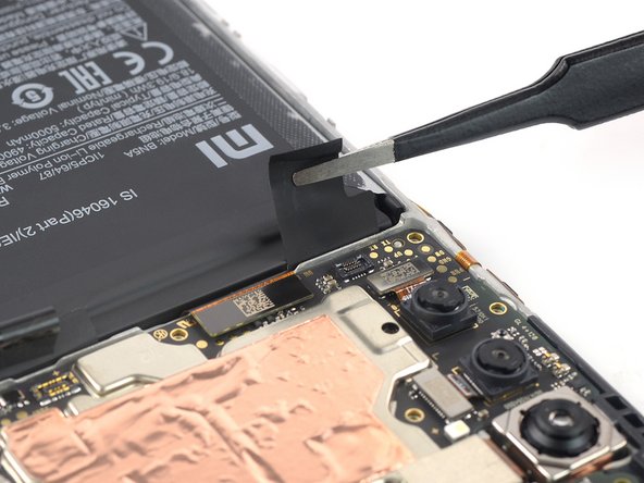

  23. Xiaomi Redmi Note 10 5G Screen Replacement: crwdns2935265:023crwdnd2935265:01crwdnd2935265:03crwdne2935265:0 Xiaomi Redmi Note 10 5G Screen Replacement: crwdns2935265:023crwdnd2935265:02crwdnd2935265:03crwdne2935265:0 Xiaomi Redmi Note 10 5G Screen Replacement: crwdns2935265:023crwdnd2935265:03crwdnd2935265:03crwdne2935265:0
    • Repeat the previous pull-tab removal procedure on the second pull-tab.
    • Follow the same procedure as with the previous strip: don't press down on the battery, keep the strip flat and unwrinkled, and pull at a low angle.
    • If the adhesive breaks off underneath the battery and can't be retrieved, apply a few drops of high concentration (over 90%) isopropyl alcohol under the edge of the battery in the area of the broken adhesive strip(s).
    • Wait about one minute for the alcohol solution to weaken the adhesive.
    • Use the flat end of a spudger to gently lift the battery.
    • Don't try to forcefully lever the battery out. If needed, apply a few more drops of alcohol to further weaken the adhesive. Never deform or puncture the battery with your pry tool.

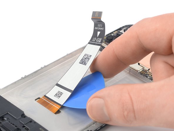

  25. Xiaomi Redmi Note 10 5G Screen Replacement, Disconnect the display flex cable: crwdns2935265:025crwdnd2935265:01crwdnd2935265:02crwdne2935265:0 Xiaomi Redmi Note 10 5G Screen Replacement, Disconnect the display flex cable: crwdns2935265:025crwdnd2935265:02crwdnd2935265:02crwdne2935265:0
    • Use a spudger to disconnect the display flex cable by prying the connector straight up from its socket.
  26. Xiaomi Redmi Note 10 5G Screen Replacement, Free the display flex cable: crwdns2935265:026crwdnd2935265:01crwdnd2935265:02crwdne2935265:0 Xiaomi Redmi Note 10 5G Screen Replacement, Free the display flex cable: crwdns2935265:026crwdnd2935265:02crwdnd2935265:02crwdne2935265:0
    • The display flex cable is adhered to the front panel assembly by mild adhesive.
    • Carefully slide an opening pick underneath the display flex cable to separate it from the front panel assembly.

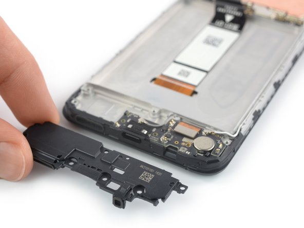

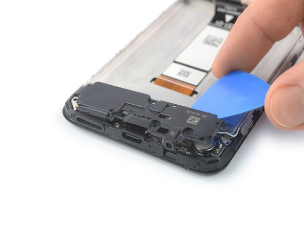

  27. Xiaomi Redmi Note 10 5G Screen Replacement, Remove the loudspeaker: crwdns2935265:027crwdnd2935265:01crwdnd2935265:03crwdne2935265:0 Xiaomi Redmi Note 10 5G Screen Replacement, Remove the loudspeaker: crwdns2935265:027crwdnd2935265:02crwdnd2935265:03crwdne2935265:0 Xiaomi Redmi Note 10 5G Screen Replacement, Remove the loudspeaker: crwdns2935265:027crwdnd2935265:03crwdnd2935265:03crwdne2935265:0
    • Insert an opening pick into the gap between the front panel assembly and the loudspeaker at the top edge of the speaker.
    • Twist the opening pick sideways to pry up the loudspeaker.
    • Remove the loudspeaker.

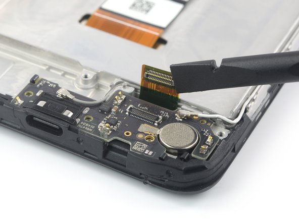

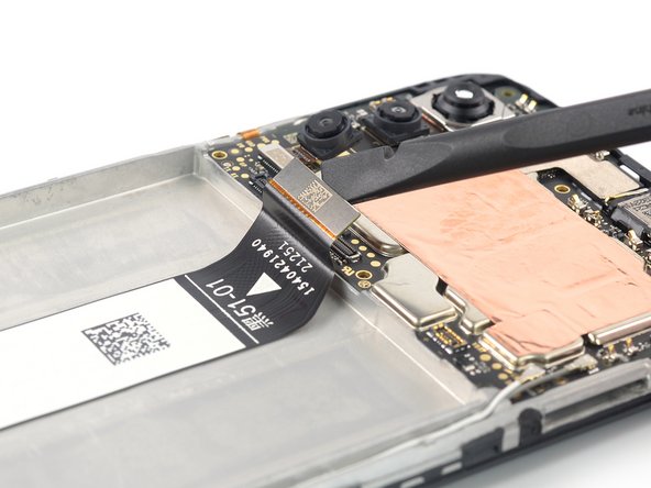

  28. Xiaomi Redmi Note 10 5G Screen Replacement, Disconnect the digitizer flex cable: crwdns2935265:028crwdnd2935265:01crwdnd2935265:02crwdne2935265:0 Xiaomi Redmi Note 10 5G Screen Replacement, Disconnect the digitizer flex cable: crwdns2935265:028crwdnd2935265:02crwdnd2935265:02crwdne2935265:0
    • Use a spudger to disconnect the digitizer flex cable by prying the connector straight up from its socket.

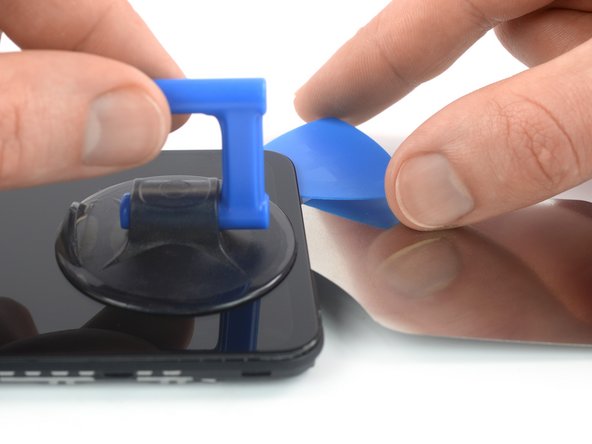

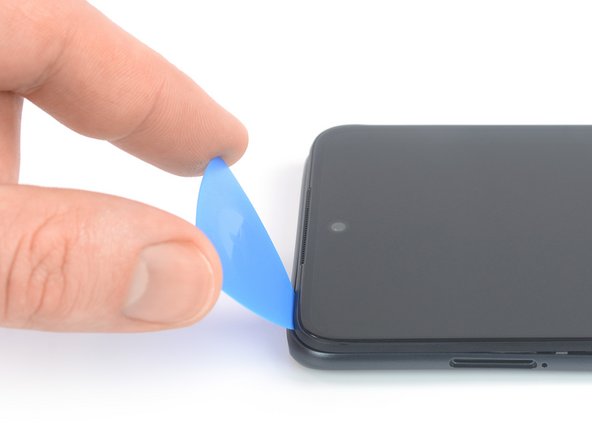

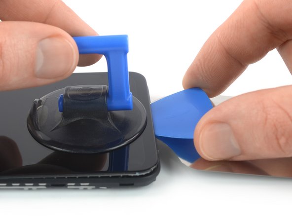

  30. Xiaomi Redmi Note 10 5G Screen Replacement, Insert an iFlex: crwdns2935265:030crwdnd2935265:01crwdnd2935265:02crwdne2935265:0 Xiaomi Redmi Note 10 5G Screen Replacement, Insert an iFlex: crwdns2935265:030crwdnd2935265:02crwdnd2935265:02crwdne2935265:0
    • Once the screen is warm to the touch, apply a suction handle to the bottom edge of the screen.
    • If your screen is badly cracked, covering it with a layer of clear packing tape may allow the suction handle to adhere. Alternatively, very strong tape may be used instead of the suction handle. If all else fails, you can superglue the suction handle to the screen.
    • Lift the screen with the suction handle to create a small gap between the screen and the frame.
    • Insert an iFlex into the gap between the midframe and the screen.

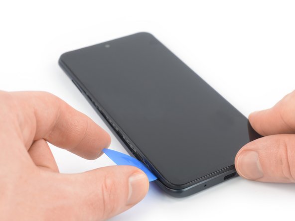

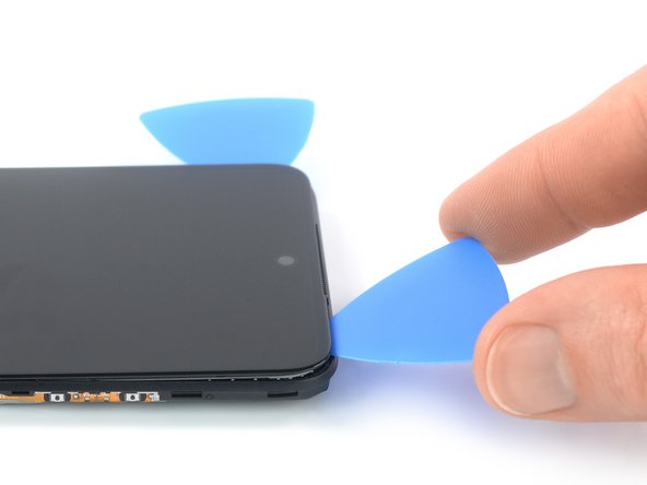

  34. Xiaomi Redmi Note 10 5G Screen Replacement: crwdns2935265:034crwdnd2935265:01crwdnd2935265:02crwdne2935265:0 Xiaomi Redmi Note 10 5G Screen Replacement: crwdns2935265:034crwdnd2935265:02crwdnd2935265:02crwdne2935265:0
    • When you slice near the front facing camera, insert only the tip of the opening pick (about 2-3 mm) to avoid damaging or smearing the camera.
    • Insert a fourth opening pick at the top left corner of the screen.
    • Slide the opening pick along the top edge of the phone to slice the adhesive.

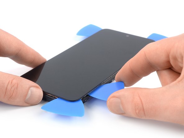

  35. Xiaomi Redmi Note 10 5G Screen Replacement: crwdns2935265:035crwdnd2935265:01crwdnd2935265:02crwdne2935265:0 Xiaomi Redmi Note 10 5G Screen Replacement: crwdns2935265:035crwdnd2935265:02crwdnd2935265:02crwdne2935265:0
    • Insert a fifth opening pick and slide it along the right edge of the phone to slice the remaining adhesive.
    • Do not try to remove the display all the way yet, the display and the digitizer cable are still threaded through the front panel assembly.
  36. Xiaomi Redmi Note 10 5G Screen Replacement, Free the display cables: crwdns2935265:036crwdnd2935265:01crwdnd2935265:03crwdne2935265:0 Xiaomi Redmi Note 10 5G Screen Replacement, Free the display cables: crwdns2935265:036crwdnd2935265:02crwdnd2935265:03crwdne2935265:0 Xiaomi Redmi Note 10 5G Screen Replacement, Free the display cables: crwdns2935265:036crwdnd2935265:03crwdnd2935265:03crwdne2935265:0
    • Thread the digitizer flex cable through the gap in the front panel assembly.
    • Thread the display flex cable through the gap in the front panel assembly.
  37. Xiaomi Redmi Note 10 5G Screen Replacement, Remove the screen: crwdns2935265:037crwdnd2935265:01crwdnd2935265:01crwdne2935265:0
    • Remove the screen.
    • Compare your new replacement part to the original part—you may need to transfer remaining components from your old screen to your replacement part.
    • Apply new adhesive where it's necessary after cleaning the relevant areas with isopropyl alcohol (>90%).
    • During reassembly, follow this guide in case you're using a pre-cut adhesive card.
If possible, turn on your device and test your repair before installing new adhesive and resealing.
The best way to secure the new screen is to apply a sheet of custom-cut double-sided tape to the back of the screen.
Repair didn’t go as planned? Try some basic troubleshooting, or ask our Answers community for help.
