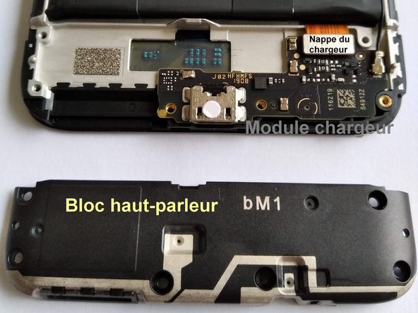

  4. Xiaomi Redmi Go Screen and Battery Replacement, Remove the Loudspeaker: crwdns2935265:04crwdnd2935265:01crwdnd2935265:02crwdne2935265:0 Xiaomi Redmi Go Screen and Battery Replacement, Remove the Loudspeaker: crwdns2935265:04crwdnd2935265:02crwdnd2935265:02crwdne2935265:0
    • Remove the 6 screws from the loudspeaker located at the bottom of the phone.
    • One of the screws located at the top right of the loudspeaker is covered by an opening indicator (small adhesive circle with the "MI" logo)
    • Carefully peel off the loudspeaker assembly

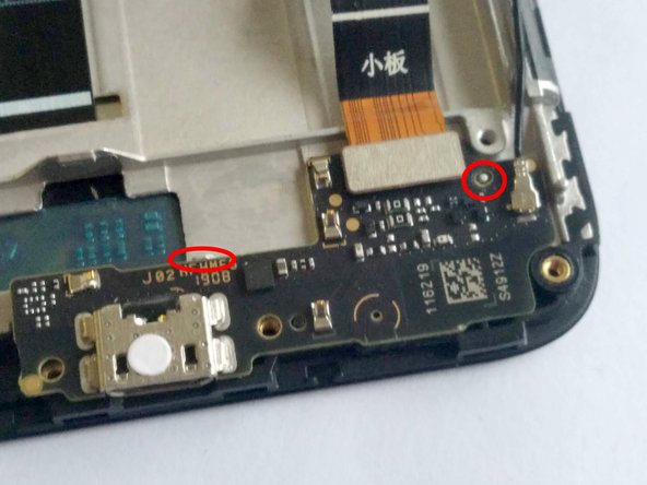

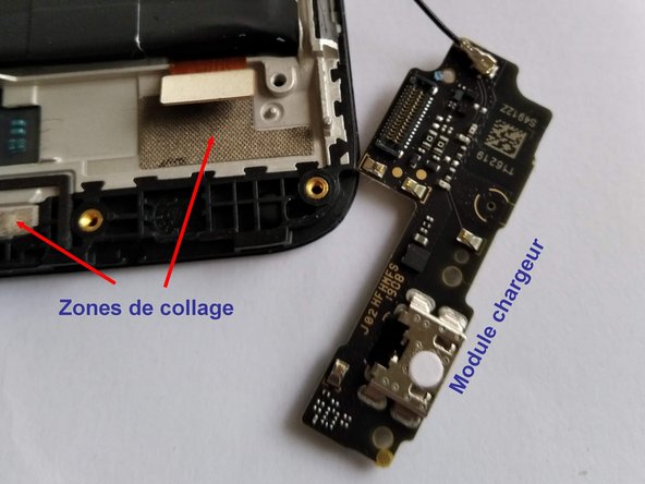

  5. Xiaomi Redmi Go Screen and Battery Replacement, Remove the Charger Module: crwdns2935265:05crwdnd2935265:01crwdnd2935265:02crwdne2935265:0 Xiaomi Redmi Go Screen and Battery Replacement, Remove the Charger Module: crwdns2935265:05crwdnd2935265:02crwdnd2935265:02crwdne2935265:0
    • Disconnect the charger module cable located at the bottom right of the battery
    • Carefully peel off the charger module starting from the left
    • Be careful not to damage the small black coax cable that connects the charger module to the motherboard

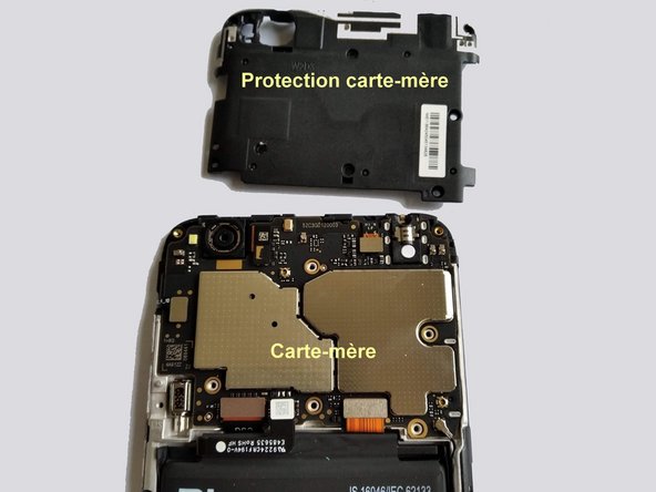

  6. Xiaomi Redmi Go Screen and Battery Replacement, Remove the Motherboard Midframe: crwdns2935265:06crwdnd2935265:01crwdnd2935265:02crwdne2935265:0 Xiaomi Redmi Go Screen and Battery Replacement, Remove the Motherboard Midframe: crwdns2935265:06crwdnd2935265:02crwdnd2935265:02crwdne2935265:0
    • Remove the 8 mounting screws from the motherboard cover. One of them, located at the bottom left, is hidden by an opening indicator (small adhesive circle with the "MI" logo).
    • In general the screws are all very close to the same length, but it is recommended you use a screw mat to ensure they go back in the same hole they came out from during reassembly
    • Carefully unclip the plastic cover, taking care not to twist it too much. Lever it up with a small screwdriver on one of the corners of the screen

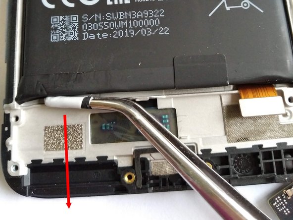

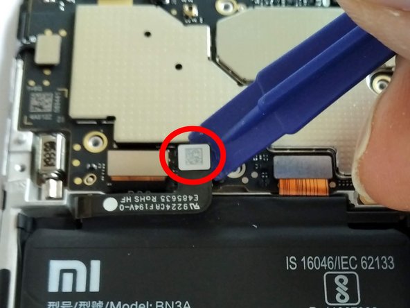

  7. Xiaomi Redmi Go Screen and Battery Replacement, Remove the Battery: crwdns2935265:07crwdnd2935265:01crwdnd2935265:03crwdne2935265:0 Xiaomi Redmi Go Screen and Battery Replacement, Remove the Battery: crwdns2935265:07crwdnd2935265:02crwdnd2935265:03crwdne2935265:0 Xiaomi Redmi Go Screen and Battery Replacement, Remove the Battery: crwdns2935265:07crwdnd2935265:03crwdnd2935265:03crwdne2935265:0
    • Peel off the 2 adhesive tabs located at the bottom of the battery
    • One at a time, pull these tabs horizontally, wrapping them around pliers or a screwdriver as you go. They will stretch to a length of around 20 to 30 cm
    • Disconnect the battery cable. The connector is located at the bottom of the motherboard between the screen connector and the charger module connector
    • Remove the battery

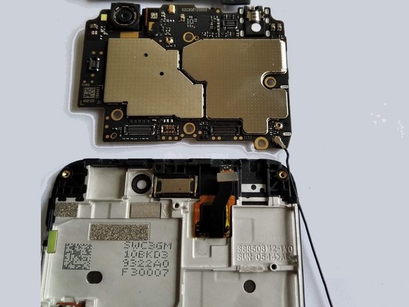

  9. Xiaomi Redmi Go Screen and Battery Replacement, Remove the Motherboard: crwdns2935265:09crwdnd2935265:01crwdnd2935265:02crwdne2935265:0 Xiaomi Redmi Go Screen and Battery Replacement, Remove the Motherboard: crwdns2935265:09crwdnd2935265:02crwdnd2935265:02crwdne2935265:0
    • Carefully disconnect the following:
    • The touch connector located at the top right of the motherboard
    • The volume/power cable connector, located on the left
    • The screen cable connector, located at the bottom left
    • Remove the motherboard by lifting it from the bottom
    • Be careful not to lose the black rubber gasket that surrounds the camera. Do not forget to disconnect the black coax cable that connects the motherboard to the charger module

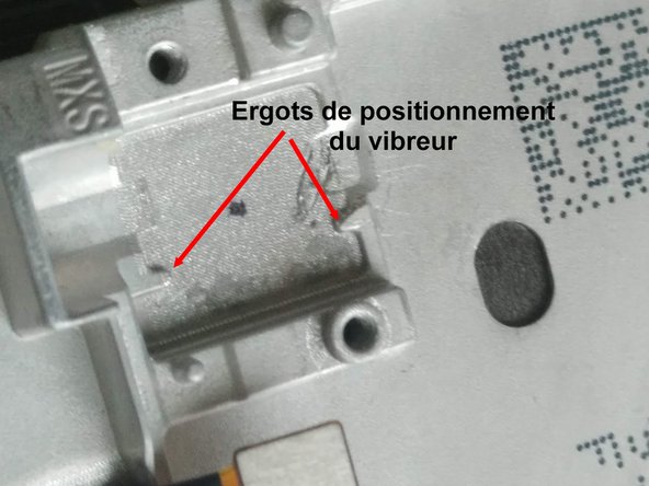

  10. Xiaomi Redmi Go Screen and Battery Replacement, Remove the Vibrator: crwdns2935265:010crwdnd2935265:01crwdnd2935265:02crwdne2935265:0 Xiaomi Redmi Go Screen and Battery Replacement, Remove the Vibrator: crwdns2935265:010crwdnd2935265:02crwdnd2935265:02crwdne2935265:0
    • With a sharp blade, slice the adhesive under the vibrator's printed circuit to carefully remove it
    • Carefully remove the remaining glue under the vibrator with a sharp blade
    • Glue the vibrator back onto the new screen frame, taking care to position it correctly between the two small lugs on the metal frame
    • To bond with neoprene glue, proceed as follows:
    • Put a dot of glue on the vibrator motor
    • Press the motor into place so that the glue spreads over the motor and the frame
    • Immediately remove the motor and wait a few minutes for the glue to dry a little
    • When the glue is no longer liquid, but it still sticks slightly to the finger, position the motor into position and press. The bond will be solid after a few hours

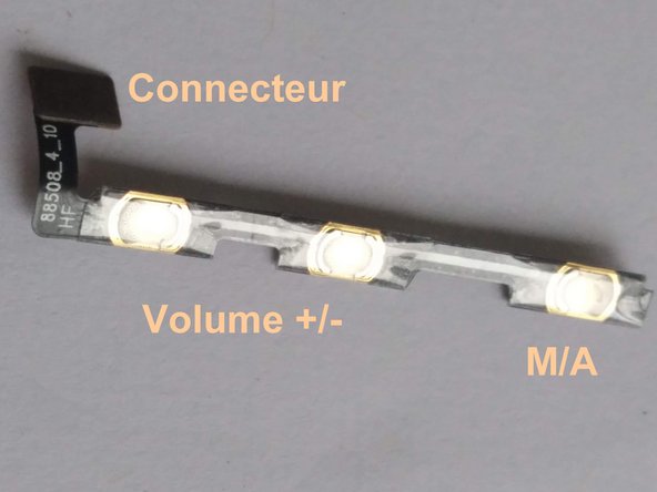

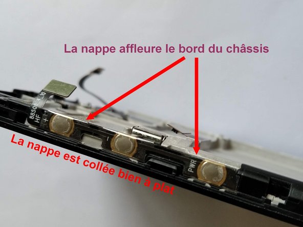

  12. Xiaomi Redmi Go Screen and Battery Replacement, Remove the Power and Volume Buttons: crwdns2935265:012crwdnd2935265:01crwdnd2935265:03crwdne2935265:0 Xiaomi Redmi Go Screen and Battery Replacement, Remove the Power and Volume Buttons: crwdns2935265:012crwdnd2935265:02crwdnd2935265:03crwdne2935265:0 Xiaomi Redmi Go Screen and Battery Replacement, Remove the Power and Volume Buttons: crwdns2935265:012crwdnd2935265:03crwdnd2935265:03crwdne2935265:0
    • Carefully use a flat spudger or a sharp blade between the frame of the screen and the cable which supports the power and volume buttons, located on the left of the telephone to slice the adhesive and remove this cable
    • Be careful not to deform the flex cable to keep it flat for reinstallation
    • Carefully remove the glue on the back of the flex cable with a fingernail or a plastic spudger
    • Place the cable on the new chassis and check that it is positioned flat on the edge of the frame just flush with the metal edge of the chassis
    • Glue the flex cable with a thin line of neoprene glue (see step 9 for gluing instructions)
  13. Xiaomi Redmi Go Screen and Battery Replacement, Reassemble the Motherboard: crwdns2935265:013crwdnd2935265:01crwdnd2935265:02crwdne2935265:0 Xiaomi Redmi Go Screen and Battery Replacement, Reassemble the Motherboard: crwdns2935265:013crwdnd2935265:02crwdnd2935265:02crwdne2935265:0
    • Carefully fold the touch screen flex connector located at the top left upwards
    • Place the motherboard on the new screen, taking care to position the headphone jack and the front camera in their respective slots. Be sure the rubber seal for the rear camera is in place.
    • Check that the card is correctly positioned in relation to the two small metal guide pins on the chassis (circled in green)
    • Temporarily secure the motherboard in the chassis with one of the 8 screws of the midframe cover
    • Plug in the touch screen connector, located at the top right of the motherboard
    • Plug in the power and volume button cable, located to the left of the motherboard
    • Plug in the screen cable, located at the bottom left of the motherboard.
    • The connection between components is a delicate operation which determines the proper functioning of the phone. There's nothing more stupid than having to disassemble it again because one of them is poorly connected. To do this, position the cable, press gently with the flat tip of a finger in the center of the connector. You should feel a "click".
  14. Xiaomi Redmi Go Screen and Battery Replacement, Fit the Charging Assembly: crwdns2935265:014crwdnd2935265:01crwdnd2935265:02crwdne2935265:0 Xiaomi Redmi Go Screen and Battery Replacement, Fit the Charging Assembly: crwdns2935265:014crwdnd2935265:02crwdnd2935265:02crwdne2935265:0
    • On the new screen, remove the two blue stickers that protect the adhesive used to secure the charger module and the micro USB connector
    • Replace the charger module by positioning it correctly in relation to the two small metal lugs located on the chassis (a small cylindrical point located at the top right and a small protrusion located just above and to the right of the micro USB connector)
