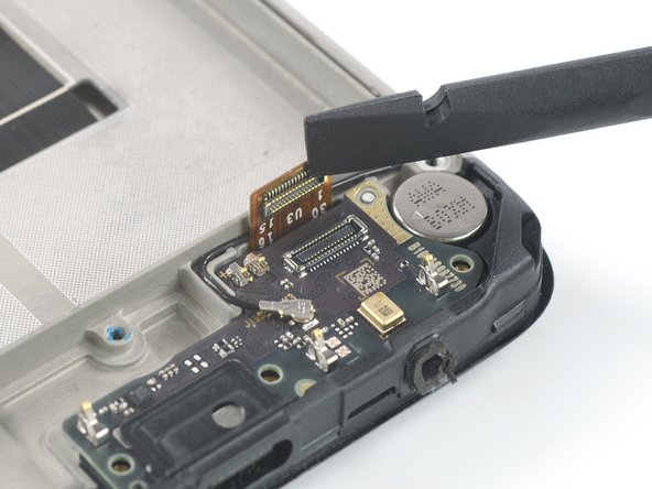

    1. Xiaomi Poco M3 Screen Replacement, Disconnect the display cable: crwdns2935265:020crwdnd2935265:01crwdnd2935265:02crwdne2935265:0 Xiaomi Poco M3 Screen Replacement, Disconnect the display cable: crwdns2935265:020crwdnd2935265:02crwdnd2935265:02crwdne2935265:0
      • Use the flat end of a spudger to disconnect the main display flex cable.

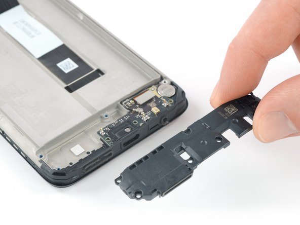

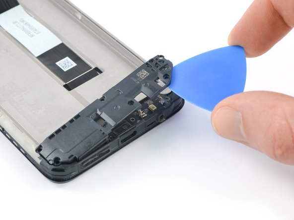

    4. Xiaomi Poco M3 Screen Replacement, Remove the loudspeaker assembly: crwdns2935265:023crwdnd2935265:01crwdnd2935265:03crwdne2935265:0 Xiaomi Poco M3 Screen Replacement, Remove the loudspeaker assembly: crwdns2935265:023crwdnd2935265:02crwdnd2935265:03crwdne2935265:0 Xiaomi Poco M3 Screen Replacement, Remove the loudspeaker assembly: crwdns2935265:023crwdnd2935265:03crwdnd2935265:03crwdne2935265:0
      • Insert an opening pick underneath the bottom right corner of the loudspeaker assembly.
      • Use the opening to pry the loudspeaker assembly out of its recess.
      • Remove the loudspeaker assembly.

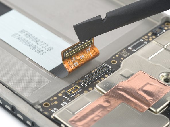

    5. Xiaomi Poco M3 Screen Replacement, Disconnect the digitizer cable: crwdns2935265:024crwdnd2935265:01crwdnd2935265:02crwdne2935265:0 Xiaomi Poco M3 Screen Replacement, Disconnect the digitizer cable: crwdns2935265:024crwdnd2935265:02crwdnd2935265:02crwdne2935265:0
      • Use the flat end of a spudger to disconnect the digitizer flex cable.

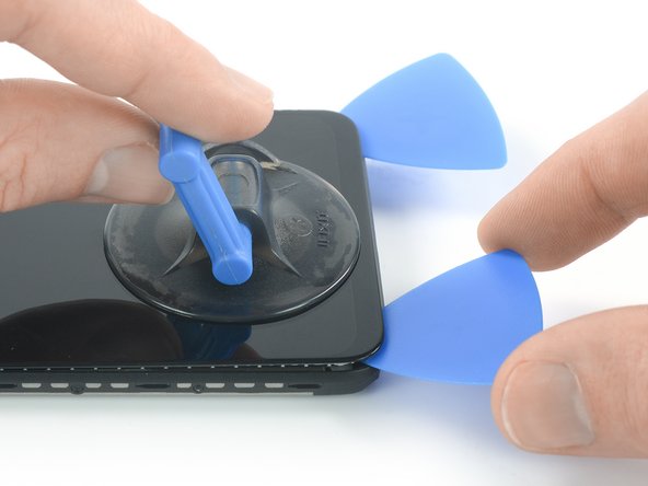

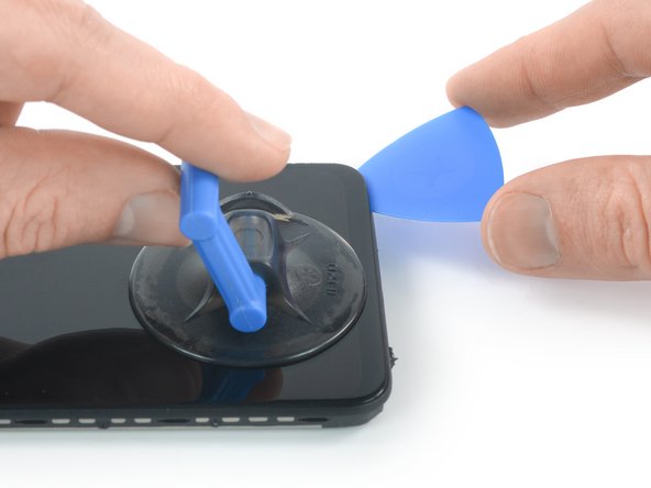

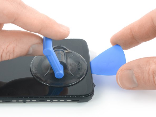

    7. Xiaomi Poco M3 Screen Replacement, Insert an opening pick: crwdns2935265:026crwdnd2935265:01crwdnd2935265:03crwdne2935265:0 Xiaomi Poco M3 Screen Replacement, Insert an opening pick: crwdns2935265:026crwdnd2935265:02crwdnd2935265:03crwdne2935265:0 Xiaomi Poco M3 Screen Replacement, Insert an opening pick: crwdns2935265:026crwdnd2935265:03crwdnd2935265:03crwdne2935265:0
      • Once the screen is warm to touch, apply a suction cup to the bottom edge of the phone.
      • If the phone's screen is cracked, the suction handle may not stick. Try lifting it with strong tape, or superglue the suction handle in place and allow it to cure so you can proceed.
      • Lift the screen with the suction handle to create a small gap between the screen and the frame.
      • Insert the tip of an opening pick in the gap between the midframe and the screen.
      • Slide the opening pick to the bottom right corner to cut the adhesive. Leave it in its place to prevent the adhesive from resealing.

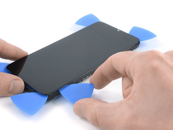

    8. Xiaomi Poco M3 Screen Replacement, Slice the display adhesive: crwdns2935265:027crwdnd2935265:01crwdnd2935265:02crwdne2935265:0 Xiaomi Poco M3 Screen Replacement, Slice the display adhesive: crwdns2935265:027crwdnd2935265:02crwdnd2935265:02crwdne2935265:0
      • Insert a second opening pick and slide it to the bottom left corner of the screen to cut the adhesive.
      • Leave the opening picks in to prevent the adhesive from resealing.

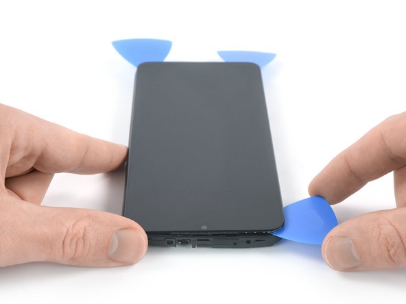

    9. Xiaomi Poco M3 Screen Replacement: crwdns2935265:028crwdnd2935265:01crwdnd2935265:03crwdne2935265:0 Xiaomi Poco M3 Screen Replacement: crwdns2935265:028crwdnd2935265:02crwdnd2935265:03crwdne2935265:0 Xiaomi Poco M3 Screen Replacement: crwdns2935265:028crwdnd2935265:03crwdnd2935265:03crwdne2935265:0
      • If the adhesive becomes hard to cut, it has most likely cooled down. Use your iOpener to reheat it.
      • Insert a third opening pick under the bottom left corner of the phone.
      • Slide the opening pick up to the top left corner to cut the adhesive. Leave it in to prevent the adhesive from resealing.

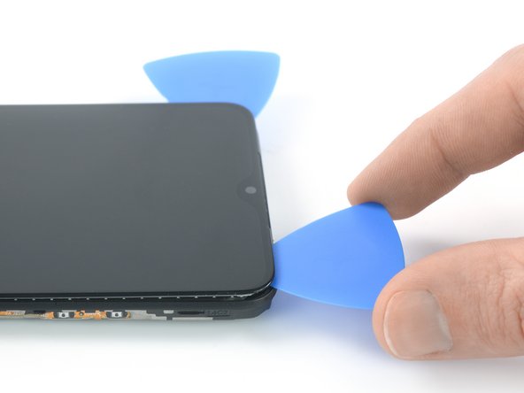

    10. Xiaomi Poco M3 Screen Replacement: crwdns2935265:029crwdnd2935265:01crwdnd2935265:02crwdne2935265:0 Xiaomi Poco M3 Screen Replacement: crwdns2935265:029crwdnd2935265:02crwdnd2935265:02crwdne2935265:0
      • Insert a fourth opening pick at the top left corner.
      • Slide the opening pick along the top edge of the phone to cut the adhesive. Leave the opening pick in the top right corner of the screen to prevent the adhesive from resealing.
      • When you slice near the front facing camera, insert only the tip of the opening pick to avoid damaging or smearing the camera.

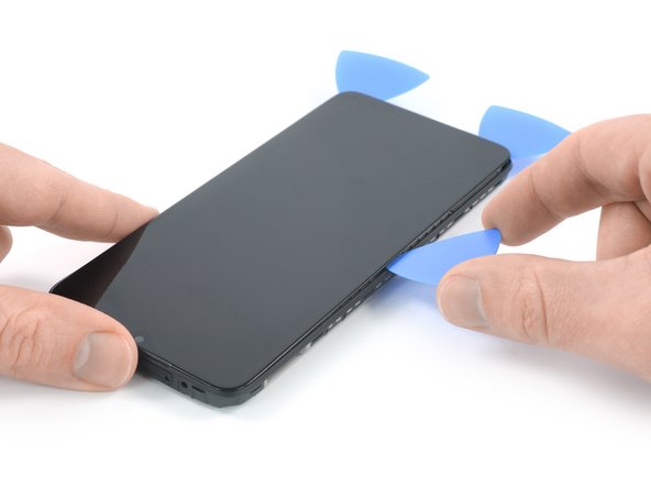

    11. Xiaomi Poco M3 Screen Replacement: crwdns2935265:030crwdnd2935265:01crwdnd2935265:02crwdne2935265:0 Xiaomi Poco M3 Screen Replacement: crwdns2935265:030crwdnd2935265:02crwdnd2935265:02crwdne2935265:0
      • Insert a fifth opening pick and slide it along the right edge of the phone to cut the remaining adhesive.
      • Try not to remove the display all the way yet, the display cables are still threaded through the frame and possibly adhered on the inner side of the midframe.

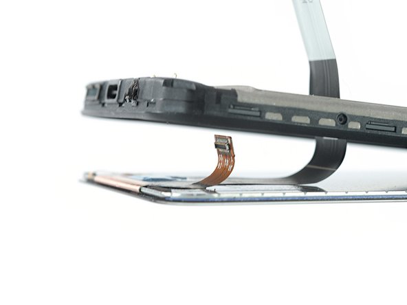

    12. Xiaomi Poco M3 Screen Replacement, Thread the digitizer flex cable through the frame: crwdns2935265:031crwdnd2935265:01crwdnd2935265:02crwdne2935265:0 Xiaomi Poco M3 Screen Replacement, Thread the digitizer flex cable through the frame: crwdns2935265:031crwdnd2935265:02crwdnd2935265:02crwdne2935265:0
      • Thread the digitizer flex cable through the gap in the midframe.
    13. Xiaomi Poco M3 Screen Replacement, Remove the display: crwdns2935265:032crwdnd2935265:01crwdnd2935265:03crwdne2935265:0 Xiaomi Poco M3 Screen Replacement, Remove the display: crwdns2935265:032crwdnd2935265:02crwdnd2935265:03crwdne2935265:0 Xiaomi Poco M3 Screen Replacement, Remove the display: crwdns2935265:032crwdnd2935265:03crwdnd2935265:03crwdne2935265:0
      • Thread the display flex cable through the gap in the midframe and remove the screen.
      • Compare your new replacement part to the original part—you may need to transfer remaining components or remove adhesive backings from the new part before installing.
