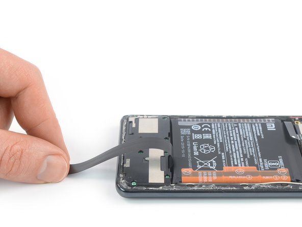

  12. Xiaomi Mi 9T Pro Battery Replacement, Disconnect the battery cable: crwdns2935265:012crwdnd2935265:01crwdnd2935265:02crwdne2935265:0 Xiaomi Mi 9T Pro Battery Replacement, Disconnect the battery cable: crwdns2935265:012crwdnd2935265:02crwdnd2935265:02crwdne2935265:0
    • Use a spudger to disconnect the battery cable by prying the connector straight up from its socket.
  13. Xiaomi Mi 9T Pro Battery Replacement, Disconnect the interconnect cable: crwdns2935265:013crwdnd2935265:01crwdnd2935265:02crwdne2935265:0 Xiaomi Mi 9T Pro Battery Replacement, Disconnect the interconnect cable: crwdns2935265:013crwdnd2935265:02crwdnd2935265:02crwdne2935265:0
    • Use a spudger to disconnect the interconnect cable by prying the connector straight up from its socket.
  14. Xiaomi Mi 9T Pro Battery Replacement, Free the battery: crwdns2935265:014crwdnd2935265:01crwdnd2935265:02crwdne2935265:0 Xiaomi Mi 9T Pro Battery Replacement, Free the battery: crwdns2935265:014crwdnd2935265:02crwdnd2935265:02crwdne2935265:0
    • During the following step do not fold the cable sharply and only bend it to avoid cable damage.
    • Fold the interconnect flex cable towards the charging port in order to get free access to both battery pull tabs and the battery.
    • You might want to use a small piece of tape to temporarily stick the cable onto your working surface to avoid accidentally damaging it during the battery removal.
  15. Xiaomi Mi 9T Pro Battery Replacement, Peel off the battery pull-tabs: crwdns2935265:015crwdnd2935265:01crwdnd2935265:02crwdne2935265:0 Xiaomi Mi 9T Pro Battery Replacement, Peel off the battery pull-tabs: crwdns2935265:015crwdnd2935265:02crwdnd2935265:02crwdne2935265:0
    • Take care not to puncture or bend the battery with your tool—a punctured or bent battery may leak dangerous chemicals or cause a thermal event.
    • Use a pair of blunt nose tweezers or a clean fingernail to peel the orange adhesive strip labeled with a 1 off the battery.

  17. Xiaomi Mi 9T Pro Battery Replacement, Lift the battery: crwdns2935265:017crwdnd2935265:01crwdnd2935265:02crwdne2935265:0 Xiaomi Mi 9T Pro Battery Replacement, Lift the battery: crwdns2935265:017crwdnd2935265:02crwdnd2935265:02crwdne2935265:0
    • Grab the pull-tab end labeled with a 3 and pull up on the orange adhesive strip to lift the battery out of its recess and swing it up to an upright position.
    • Although these adhesive tabs are supposed to make the battery removal easier, they may require some force. If you're having trouble removing the battery, you can apply a heated iOpener to the center of the display to loosen the adhesive underneath.
  18. Xiaomi Mi 9T Pro Battery Replacement, Remove the battery: crwdns2935265:018crwdnd2935265:01crwdnd2935265:02crwdne2935265:0 Xiaomi Mi 9T Pro Battery Replacement, Remove the battery: crwdns2935265:018crwdnd2935265:02crwdnd2935265:02crwdne2935265:0
