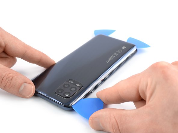

  1. Xiaomi Mi 10 Lite Screen Replacement, Heat the rear glass: crwdns2935265:01crwdnd2935265:01crwdnd2935265:01crwdne2935265:0
    • Prepare an iOpener and apply it to the rear glass for at least two minutes to loosen the adhesive underneath.
    • A hair dryer, heat gun, or hot plate may also be used, but be careful not to overheat the phone—the display and internal battery are both susceptible to heat damage.

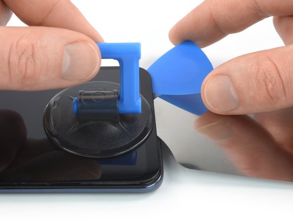

  2. Xiaomi Mi 10 Lite Screen Replacement, Insert an opening pick: crwdns2935265:02crwdnd2935265:01crwdnd2935265:03crwdne2935265:0 Xiaomi Mi 10 Lite Screen Replacement, Insert an opening pick: crwdns2935265:02crwdnd2935265:02crwdnd2935265:03crwdne2935265:0 Xiaomi Mi 10 Lite Screen Replacement, Insert an opening pick: crwdns2935265:02crwdnd2935265:03crwdnd2935265:03crwdne2935265:0
    • Secure a suction handle to the bottom edge of the rear glass, as close to the edge as possible.
    • If the rear glass is cracked, the suction handle may not stick. Try lifting it with strong tape, or superglue the suction handle in place and allow it to cure so you can proceed.
    • Lift the rear glass with the suction handle to create a small gap between the rear glass and the frame.
    • In case you have trouble creating a gap, apply more heat to further soften the adhesive. Follow the iOpener instructions to avoid overheating.
    • Insert an opening pick into the gap you created.
    • Slide the opening pick to the bottom right corner to slice the adhesive.
    • Leave the opening pick in place to prevent the adhesive from resealing.
  3. Xiaomi Mi 10 Lite Screen Replacement, Slice the adhesive: crwdns2935265:03crwdnd2935265:01crwdnd2935265:02crwdne2935265:0 Xiaomi Mi 10 Lite Screen Replacement, Slice the adhesive: crwdns2935265:03crwdnd2935265:02crwdnd2935265:02crwdne2935265:0
    • Insert a second opening pick at the bottom edge of your phone.
    • Slide the opening pick to the bottom left corner to slice the adhesive.
    • Leave the opening picks in place to prevent the adhesive from resealing.

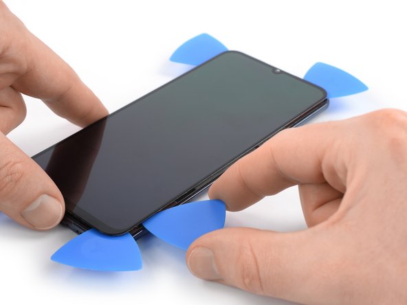

  5. Xiaomi Mi 10 Lite Screen Replacement: crwdns2935265:05crwdnd2935265:01crwdnd2935265:02crwdne2935265:0 Xiaomi Mi 10 Lite Screen Replacement: crwdns2935265:05crwdnd2935265:02crwdnd2935265:02crwdne2935265:0
    • Insert a fourth opening pick underneath the top left corner of your phone.
    • Slide the opening pick along the top edge to slice the adhesive.
    • Leave the opening pick in the top right corner to prevent the adhesive from resealing.
  6. Xiaomi Mi 10 Lite Screen Replacement: crwdns2935265:06crwdnd2935265:01crwdnd2935265:02crwdne2935265:0 Xiaomi Mi 10 Lite Screen Replacement: crwdns2935265:06crwdnd2935265:02crwdnd2935265:02crwdne2935265:0
    • Insert a fifth opening pick underneath the top right corner.
    • Slide the opening pick along the right edge of the rear glass to slice the remaining adhesive.

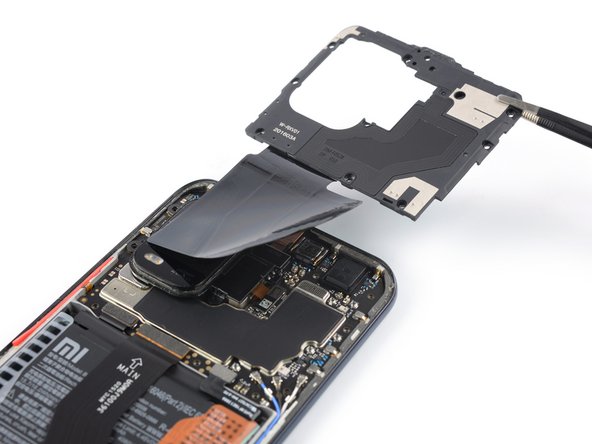

  8. Xiaomi Mi 10 Lite Screen Replacement, Unfasten the motherboard cover screws: crwdns2935265:08crwdnd2935265:01crwdnd2935265:01crwdne2935265:0
    • Use a Phillips screwdriver to remove the ten 3.9 mm-long screws securing the motherboard cover.

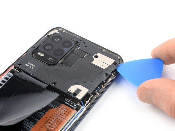

  9. Xiaomi Mi 10 Lite Screen Replacement, Pry up the motherboard cover: crwdns2935265:09crwdnd2935265:01crwdnd2935265:03crwdne2935265:0 Xiaomi Mi 10 Lite Screen Replacement, Pry up the motherboard cover: crwdns2935265:09crwdnd2935265:02crwdnd2935265:03crwdne2935265:0 Xiaomi Mi 10 Lite Screen Replacement, Pry up the motherboard cover: crwdns2935265:09crwdnd2935265:03crwdnd2935265:03crwdne2935265:0
    • Insert the tip of an opening pick underneath the right edge of the motherboard cover.
    • Slide the opening pick to the top right corner of the motherboard cover to unhinge the plastic clips and pry it up.
  10. Xiaomi Mi 10 Lite Screen Replacement, Remove the motherboard cover: crwdns2935265:010crwdnd2935265:01crwdnd2935265:02crwdne2935265:0 Xiaomi Mi 10 Lite Screen Replacement, Remove the motherboard cover: crwdns2935265:010crwdnd2935265:02crwdnd2935265:02crwdne2935265:0
    • Use a pair of tweezers or your fingers to remove the motherboard cover.

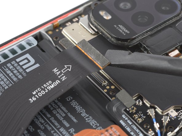

  12. Xiaomi Mi 10 Lite Screen Replacement, Disconnect the interconnect flex cable: crwdns2935265:012crwdnd2935265:01crwdnd2935265:02crwdne2935265:0 Xiaomi Mi 10 Lite Screen Replacement, Disconnect the interconnect flex cable: crwdns2935265:012crwdnd2935265:02crwdnd2935265:02crwdne2935265:0
    • Use a spudger to disconnect the interconnect flex cable by prying the connector straight up from its socket.

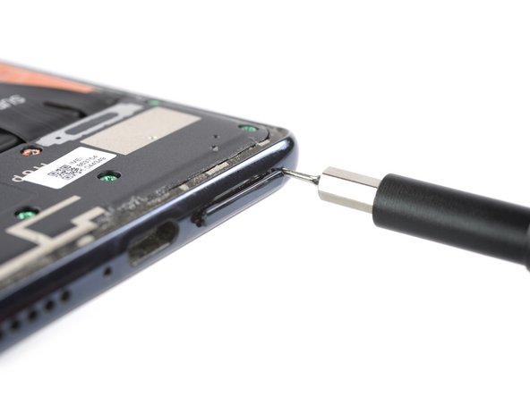

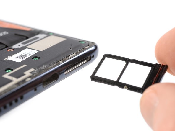

  13. Xiaomi Mi 10 Lite Screen Replacement, Eject the SIM card tray: crwdns2935265:013crwdnd2935265:01crwdnd2935265:03crwdne2935265:0 Xiaomi Mi 10 Lite Screen Replacement, Eject the SIM card tray: crwdns2935265:013crwdnd2935265:02crwdnd2935265:03crwdne2935265:0 Xiaomi Mi 10 Lite Screen Replacement, Eject the SIM card tray: crwdns2935265:013crwdnd2935265:03crwdnd2935265:03crwdne2935265:0
    • Insert a SIM card eject tool, a SIM eject bit, or a straightened paper clip into the hole on the SIM tray located at the bottom right edge of the phone.
    • Press directly into the hole to eject the SIM card tray.
    • Remove the SIM card tray.

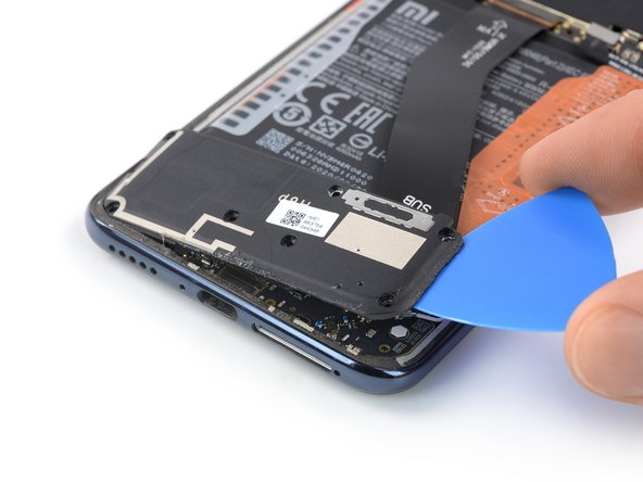

  14. Xiaomi Mi 10 Lite Screen Replacement, Unfasten the loudspeaker screws: crwdns2935265:014crwdnd2935265:01crwdnd2935265:01crwdne2935265:0
    • Use a Phillips screwdriver to remove the seven 3.9 mm-long screws securing the loudspeaker assembly.

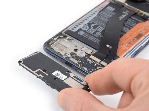

  15. Xiaomi Mi 10 Lite Screen Replacement, Pry up the loudspeaker assembly: crwdns2935265:015crwdnd2935265:01crwdnd2935265:02crwdne2935265:0 Xiaomi Mi 10 Lite Screen Replacement, Pry up the loudspeaker assembly: crwdns2935265:015crwdnd2935265:02crwdnd2935265:02crwdne2935265:0
    • Insert an opening pick underneath the top right corner of the loudspeaker assembly and pry it up.
  16. Xiaomi Mi 10 Lite Screen Replacement, Remove the loudspeaker assembly: crwdns2935265:016crwdnd2935265:01crwdnd2935265:02crwdne2935265:0 Xiaomi Mi 10 Lite Screen Replacement, Remove the loudspeaker assembly: crwdns2935265:016crwdnd2935265:02crwdnd2935265:02crwdne2935265:0
    • Remove the loudspeaker assembly.

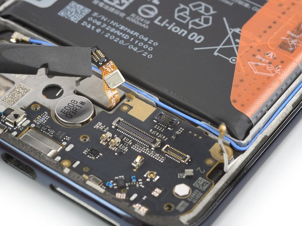

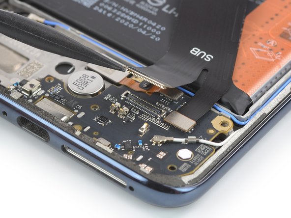

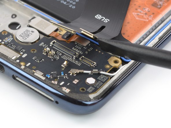

  17. Xiaomi Mi 10 Lite Screen Replacement, Disconnect the interconnect flex cable: crwdns2935265:017crwdnd2935265:01crwdnd2935265:02crwdne2935265:0 Xiaomi Mi 10 Lite Screen Replacement, Disconnect the interconnect flex cable: crwdns2935265:017crwdnd2935265:02crwdnd2935265:02crwdne2935265:0
    • Use a spudger to disconnect the bottom left connector of the interconnect flex cable by prying the connector straight up from its socket.

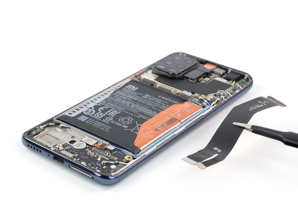

  18. Xiaomi Mi 10 Lite Screen Replacement, Remove the interconnect cable: crwdns2935265:018crwdnd2935265:01crwdnd2935265:03crwdne2935265:0 Xiaomi Mi 10 Lite Screen Replacement, Remove the interconnect cable: crwdns2935265:018crwdnd2935265:02crwdnd2935265:03crwdne2935265:0 Xiaomi Mi 10 Lite Screen Replacement, Remove the interconnect cable: crwdns2935265:018crwdnd2935265:03crwdnd2935265:03crwdne2935265:0
    • Use a spudger to disconnect the bottom right connector of the interconnect flex cable by prying the connector straight up from its socket.
    • Remove the interconnect cable.

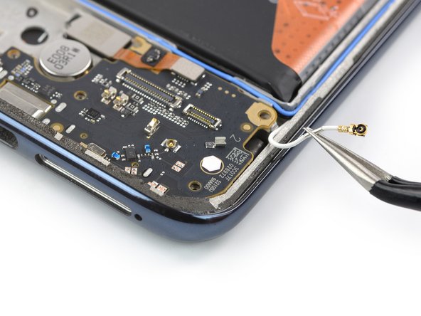

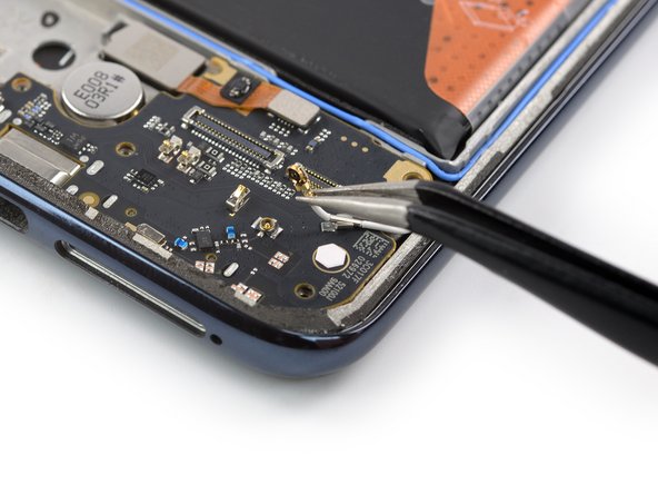

  19. Xiaomi Mi 10 Lite Screen Replacement, Disconnect the coax cable: crwdns2935265:019crwdnd2935265:01crwdnd2935265:03crwdne2935265:0 Xiaomi Mi 10 Lite Screen Replacement, Disconnect the coax cable: crwdns2935265:019crwdnd2935265:02crwdnd2935265:03crwdne2935265:0 Xiaomi Mi 10 Lite Screen Replacement, Disconnect the coax cable: crwdns2935265:019crwdnd2935265:03crwdnd2935265:03crwdne2935265:0
    • Use a pair of tweezers to carefully disconnect the white coax cable from the daughterboard.
    • Use your pair of tweezers to carefully free the white coax cable from its routing on the daughterboard and fold it to the side.
  20. Xiaomi Mi 10 Lite Screen Replacement, Disconnect the fingerprint sensor: crwdns2935265:020crwdnd2935265:01crwdnd2935265:03crwdne2935265:0 Xiaomi Mi 10 Lite Screen Replacement, Disconnect the fingerprint sensor: crwdns2935265:020crwdnd2935265:02crwdnd2935265:03crwdne2935265:0 Xiaomi Mi 10 Lite Screen Replacement, Disconnect the fingerprint sensor: crwdns2935265:020crwdnd2935265:03crwdnd2935265:03crwdne2935265:0
    • Use a spudger to disconnect the fingerprint sensor cable by prying the connector straight up from its socket.
    • Use your spudger to carefully fold the fingerprint sensor cable to the side to get free access to the daughterboard.

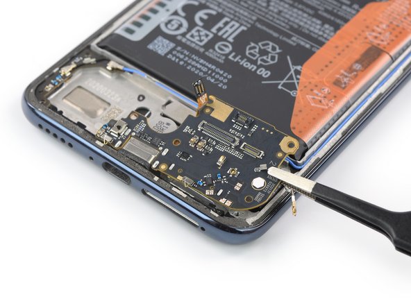

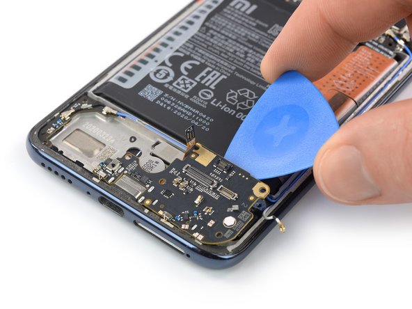

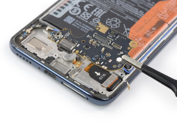

  21. Xiaomi Mi 10 Lite Screen Replacement, Pry up the daughterboard: crwdns2935265:021crwdnd2935265:01crwdnd2935265:02crwdne2935265:0 Xiaomi Mi 10 Lite Screen Replacement, Pry up the daughterboard: crwdns2935265:021crwdnd2935265:02crwdnd2935265:02crwdne2935265:0
    • Insert an opening pick into the gap between the top edge of the daughterboard and the antenna cables.
    • Use your opening pick to pry up the daughterboard.
  22. Xiaomi Mi 10 Lite Screen Replacement, Remove the daughterboard: crwdns2935265:022crwdnd2935265:01crwdnd2935265:03crwdne2935265:0 Xiaomi Mi 10 Lite Screen Replacement, Remove the daughterboard: crwdns2935265:022crwdnd2935265:02crwdnd2935265:03crwdne2935265:0 Xiaomi Mi 10 Lite Screen Replacement, Remove the daughterboard: crwdns2935265:022crwdnd2935265:03crwdnd2935265:03crwdne2935265:0
    • Don't try to remove the daughterboard by pulling it straight upwards. The USB-C connector is blocked by the midframe of the phone.
    • Use a pair of blunt nose tweezers or your fingers to remove the daughterboard by pulling it in a flat angle in the direction of the battery.

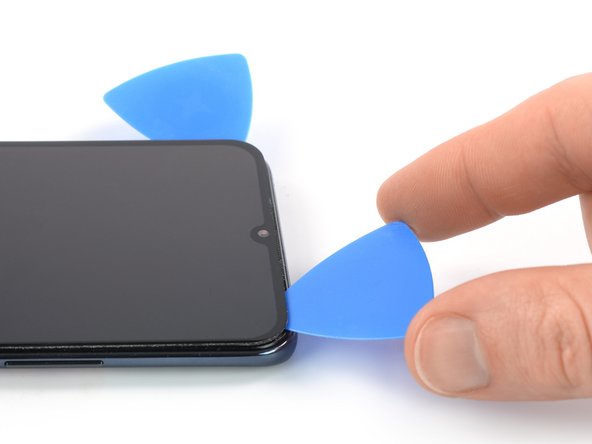

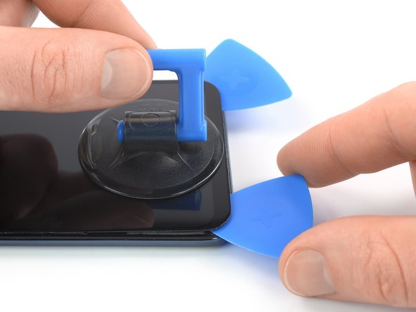

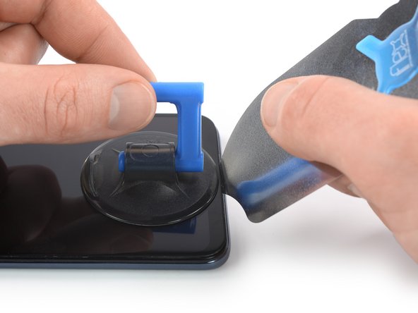

  25. Xiaomi Mi 10 Lite Screen Replacement, Insert an iFlex: crwdns2935265:025crwdnd2935265:01crwdnd2935265:02crwdne2935265:0 Xiaomi Mi 10 Lite Screen Replacement, Insert an iFlex: crwdns2935265:025crwdnd2935265:02crwdnd2935265:02crwdne2935265:0
    • Once the screen is warm to touch, apply a suction handle to the bottom edge of the screen.
    • If your screen is badly cracked, covering it with a layer of clear packing tape may allow the suction cup to adhere. Alternatively, very strong tape may be used instead of the suction handle. If all else fails, you can superglue the suction cup to the screen.
    • Lift the screen with the suction handle to create a small gap between the screen and the frame.
    • Insert an iFlex into the gap between the midframe and the screen.

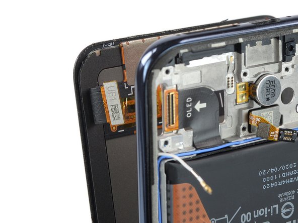

  31. Xiaomi Mi 10 Lite Screen Replacement, Remove the screen: crwdns2935265:031crwdnd2935265:01crwdnd2935265:03crwdne2935265:0 Xiaomi Mi 10 Lite Screen Replacement, Remove the screen: crwdns2935265:031crwdnd2935265:02crwdnd2935265:03crwdne2935265:0 Xiaomi Mi 10 Lite Screen Replacement, Remove the screen: crwdns2935265:031crwdnd2935265:03crwdnd2935265:03crwdne2935265:0
    • Thread the display flex cable through the gap in the midframe and remove the screen.
    • Compare your new replacement part to the original part—you may need to transfer remaining components from your old screen to your replacement part.
    • Apply new adhesive where it's necessary after cleaning the relevant areas with isopropyl alcohol (>90%).
