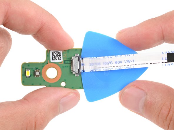

  27. Xbox Series X (Digital Edition) Power Button Board Replacement, Separate the cable adhesive: crwdns2935265:027crwdnd2935265:01crwdnd2935265:02crwdne2935265:0 Xbox Series X (Digital Edition) Power Button Board Replacement, Separate the cable adhesive: crwdns2935265:027crwdnd2935265:02crwdnd2935265:02crwdne2935265:0
    • Check if your replacement power button board comes with a cable. If it doesn't, follow the next three steps to remove and transfer the original cable.
    • The power button cable is secured to the board with a piece of mild adhesive.
    • Use an iOpener or a hair dryer to heat the cable next to its connector on the board.
  28. Xbox Series X (Digital Edition) Power Button Board Replacement: crwdns2935265:028crwdnd2935265:01crwdnd2935265:02crwdne2935265:0 Xbox Series X (Digital Edition) Power Button Board Replacement: crwdns2935265:028crwdnd2935265:02crwdnd2935265:02crwdne2935265:0
    • Gently slide an opening pick under the cable to separate the adhesive securing it.
  29. Xbox Series X (Digital Edition) Power Button Board Replacement, Disconnect the power button cable: crwdns2935265:029crwdnd2935265:01crwdnd2935265:03crwdne2935265:0 Xbox Series X (Digital Edition) Power Button Board Replacement, Disconnect the power button cable: crwdns2935265:029crwdnd2935265:02crwdnd2935265:03crwdne2935265:0 Xbox Series X (Digital Edition) Power Button Board Replacement, Disconnect the power button cable: crwdns2935265:029crwdnd2935265:03crwdnd2935265:03crwdne2935265:0
    • Use the pointed end of a spudger to depress the metal tab on the power button cable's board connector.
    • With the metal tab depressed, use a pair of tweezers to grip the plastic pull tab and slide the cable out of its socket.
    • Pull only on the pull tab, not the cable itself.
    • Don't pull on the cable without depressing the metal tab, otherwise you risk damaging either the cable or the connector.
    • During reassembly, the cable should lightly "snap" into place when inserted.
