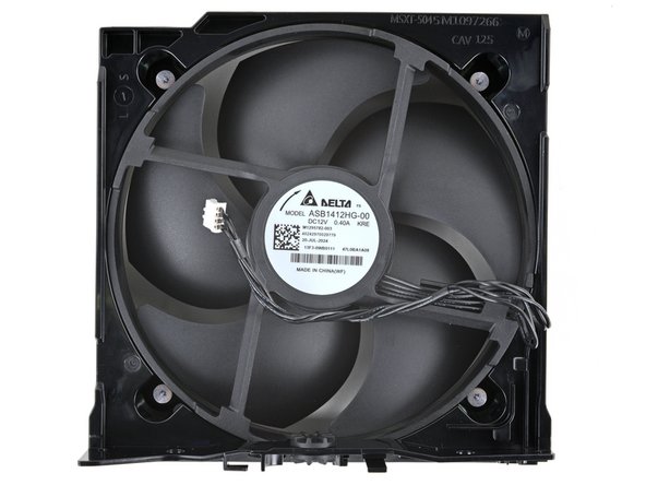

  12. Xbox Series X (Digital Edition) Fan Replacement, Remove the fan: crwdns2935265:012crwdnd2935265:01crwdnd2935265:03crwdne2935265:0 Xbox Series X (Digital Edition) Fan Replacement, Remove the fan: crwdns2935265:012crwdnd2935265:02crwdnd2935265:03crwdne2935265:0 Xbox Series X (Digital Edition) Fan Replacement, Remove the fan: crwdns2935265:012crwdnd2935265:03crwdnd2935265:03crwdne2935265:0
    Dust Blower
    $18.99
    • Slide the fan out of its slot to remove it.
    • During reassembly:
    • Before installing the fan, make sure it's clean! Use a dust blower or compressed air to blow off any dust or debris, and wipe the fan clean with a clean cloth.
    • Use a finger to keep the fan blades steady—it makes them easier to clean.
    • Note that the fan can only be installed one way—make sure Master Chief is facing you.

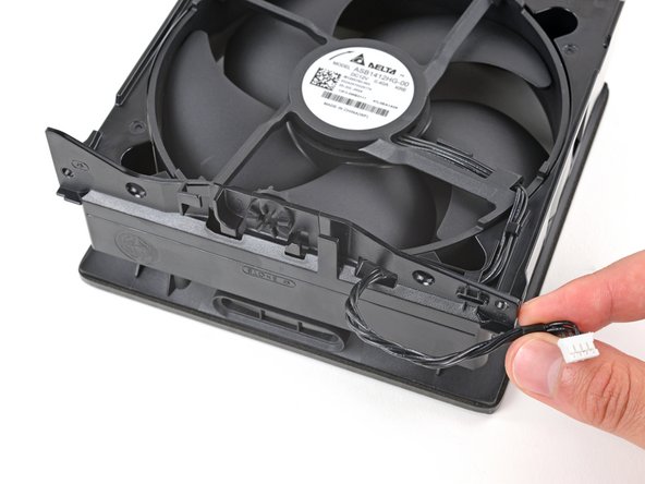

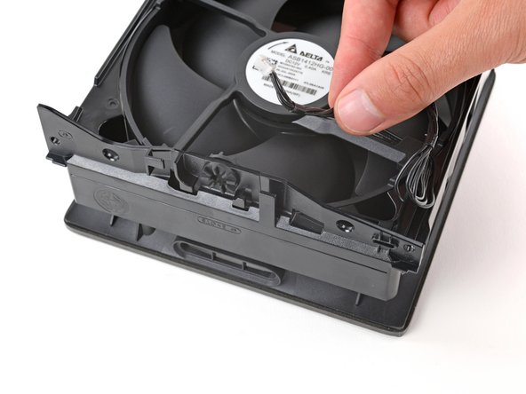

  13. Xbox Series X (Digital Edition) Fan Replacement, De‑route the fan cable: crwdns2935265:013crwdnd2935265:01crwdnd2935265:03crwdne2935265:0 Xbox Series X (Digital Edition) Fan Replacement, De‑route the fan cable: crwdns2935265:013crwdnd2935265:02crwdnd2935265:03crwdne2935265:0 Xbox Series X (Digital Edition) Fan Replacement, De‑route the fan cable: crwdns2935265:013crwdnd2935265:03crwdnd2935265:03crwdne2935265:0
    • Check if your replacement fan includes a plastic bracket. If it doesn't, follow the next three steps to remove and transfer it.
    • Use your fingers to completely de‑route the fan cable from its grooves on the bracket and pull the connector through its rectangular cutout.

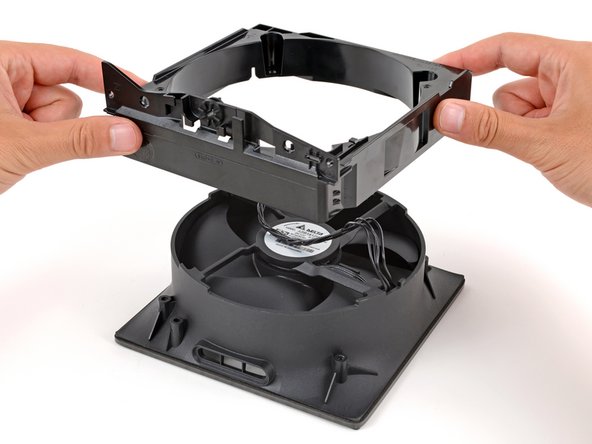

  15. Xbox Series X (Digital Edition) Fan Replacement, Remove the fan bracket: crwdns2935265:015crwdnd2935265:01crwdnd2935265:02crwdne2935265:0 Xbox Series X (Digital Edition) Fan Replacement, Remove the fan bracket: crwdns2935265:015crwdnd2935265:02crwdnd2935265:02crwdne2935265:0
    • Lift the bracket off the fan to remove it.
