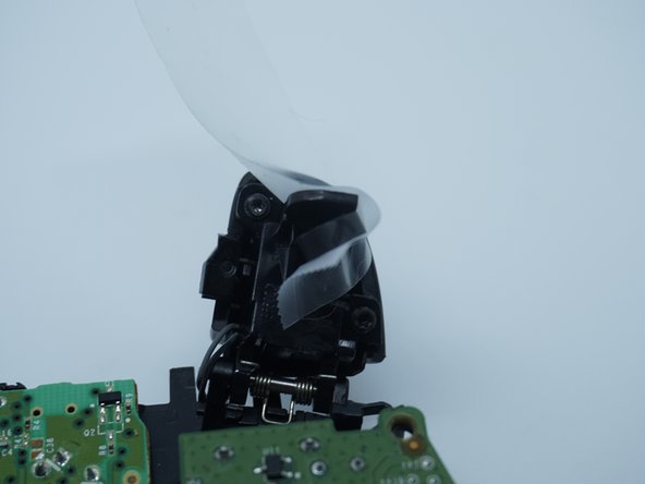

  5. Xbox One Wireless Controller 1697 LT/RT Magnet Adjustment, Cut new heatshink tubing: crwdns2935265:05crwdnd2935265:01crwdnd2935265:03crwdne2935265:0 Xbox One Wireless Controller 1697 LT/RT Magnet Adjustment, Cut new heatshink tubing: crwdns2935265:05crwdnd2935265:02crwdnd2935265:03crwdne2935265:0 Xbox One Wireless Controller 1697 LT/RT Magnet Adjustment, Cut new heatshink tubing: crwdns2935265:05crwdnd2935265:03crwdnd2935265:03crwdne2935265:0
    Precision Utility Knife
    • Repair one trigger at a time!
    • Before cutting the heatshrink, make TWO alignment marks (non-crossing).
    • After making alignment marks, cut the heatshrink off using a utility knife.
    • Using the old heatshrink as a reference, cut two new pieces.

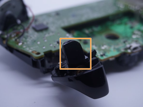

  6. Xbox One Wireless Controller 1697 LT/RT Magnet Adjustment, Clean up the magnet(s): crwdns2935265:06crwdnd2935265:01crwdnd2935265:03crwdne2935265:0 Xbox One Wireless Controller 1697 LT/RT Magnet Adjustment, Clean up the magnet(s): crwdns2935265:06crwdnd2935265:02crwdnd2935265:03crwdne2935265:0 Xbox One Wireless Controller 1697 LT/RT Magnet Adjustment, Clean up the magnet(s): crwdns2935265:06crwdnd2935265:03crwdnd2935265:03crwdne2935265:0
    • Incorrect magnet alignment will result in LT/RT activation without human input.
    • After cutting the heatshrink tubing, do a test alignment before applying glue.
    • These controllers use double sided tape from the factory. Note the dimple side and clean the magnet and frame. Goo Gone can be used on difficult residue.
    • Once the parts are reasonably clean, do a test alignment and apply tape for final installation.
