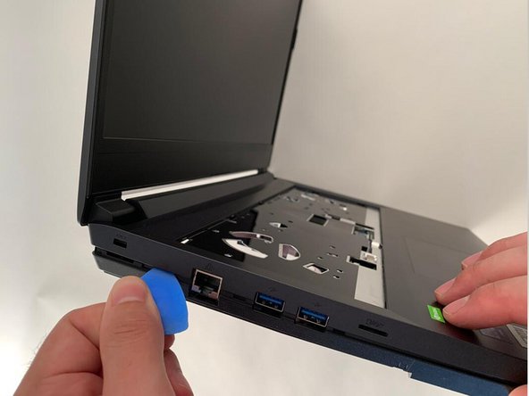

  4. Why! NH57ADS Motherboard Replacement, Keyboard: crwdns2935265:04crwdnd2935265:01crwdnd2935265:03crwdne2935265:0 Why! NH57ADS Motherboard Replacement, Keyboard: crwdns2935265:04crwdnd2935265:02crwdnd2935265:03crwdne2935265:0 Why! NH57ADS Motherboard Replacement, Keyboard: crwdns2935265:04crwdnd2935265:03crwdnd2935265:03crwdne2935265:0
    • Remove the two Phillips screws with the keypad symbol next to them.
    • Insert an iFixit opening pick into the upper slot of the keyboard and slide it to the end.
  5. Why! NH57ADS Motherboard Replacement, Remove the Keyboard: crwdns2935265:05crwdnd2935265:01crwdnd2935265:03crwdne2935265:0 Why! NH57ADS Motherboard Replacement, Remove the Keyboard: crwdns2935265:05crwdnd2935265:02crwdnd2935265:03crwdne2935265:0 Why! NH57ADS Motherboard Replacement, Remove the Keyboard: crwdns2935265:05crwdnd2935265:03crwdnd2935265:03crwdne2935265:0
    • Carefully lift the keyboard.
    • Gently flip up the retaining latch on the black keyboard cable and slide it out of the connector.
    • Repeat with the (orange) backlight cable.

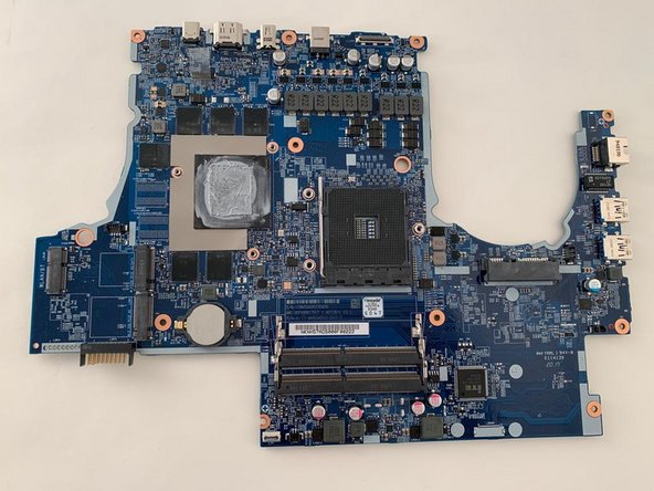

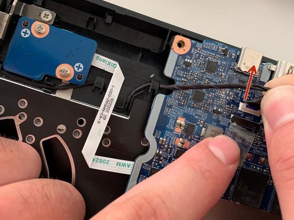

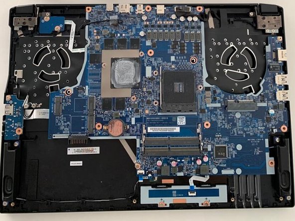

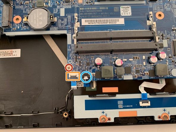

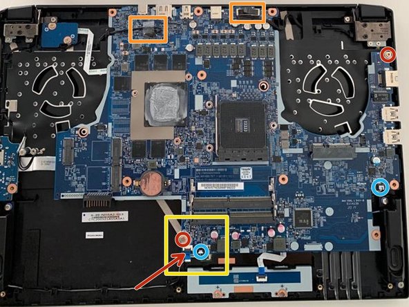

  10. Why! NH57ADS Motherboard Replacement, Motherboard: crwdns2935265:010crwdnd2935265:01crwdnd2935265:03crwdne2935265:0 Why! NH57ADS Motherboard Replacement, Motherboard: crwdns2935265:010crwdnd2935265:02crwdnd2935265:03crwdne2935265:0 Why! NH57ADS Motherboard Replacement, Motherboard: crwdns2935265:010crwdnd2935265:03crwdnd2935265:03crwdne2935265:0
    • Lift the retaining latches and remove the two ribbon cables located under the keyboard.
    • Remove the two remaining Phillips screws securing the motherboard.
    • Carefully unplug the two speaker cables using fingernails of fine tip tweezers. Do not pull on the delicate wires, as they can break easily.
    • Flip up the retaining latch on the ZIF connector between the speaker connector and the mounting screw. Remove the flex cable from the connector.

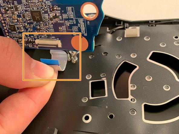

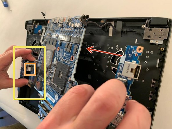

  11. Why! NH57ADS Motherboard Replacement, Disconnect Cables: crwdns2935265:011crwdnd2935265:01crwdnd2935265:03crwdne2935265:0 Why! NH57ADS Motherboard Replacement, Disconnect Cables: crwdns2935265:011crwdnd2935265:02crwdnd2935265:03crwdne2935265:0 Why! NH57ADS Motherboard Replacement, Disconnect Cables: crwdns2935265:011crwdnd2935265:03crwdnd2935265:03crwdne2935265:0
    • Unplug the LCD cable by grasping the tab and pulling it straight up. Unplug the other display cable by pulling it in the direction of the arrow. Press it out by the connector, not the cable.
    • Carefully lift the motherboard to access the remaining cable attached to the bottom side of the board.
  12. Why! NH57ADS Motherboard Replacement: crwdns2935265:012crwdnd2935265:01crwdnd2935265:03crwdne2935265:0 Why! NH57ADS Motherboard Replacement: crwdns2935265:012crwdnd2935265:02crwdnd2935265:03crwdne2935265:0 Why! NH57ADS Motherboard Replacement: crwdns2935265:012crwdnd2935265:03crwdnd2935265:03crwdne2935265:0
    • Lift the black retaining latch on the ZIF connector and unplug the flex cable.
    • The motherboard has now been removed.
