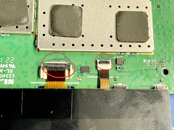

    • Guide the two ribbon cables for the LEDs and screen through the cable guides on the left side of the mainboard
    • Ensure that the mainboard is positioned correctly and look out for the two guide pins in the top and lower right hand corners of the top case (see arrows)
    • Use a Torx 5 screw driver to screw in the four screws, fastening the mainboard to the top of the case (red circles)
    • Connect the two ribbon cables to the mainboard. Ensure that the black plastic tabs (red circles in the second picture), are in the up position before you insert the ribbon cables
    • Push down the two black plastic tabs (red circles in the second picture), to secure the ribbon cables

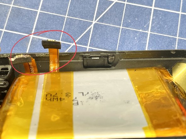

  9. Wahoo Elemnt Roam (WFCC4) Screen and Battery Replacement, Remove Old Battery and Battery Circuit Board: crwdns2935265:09crwdnd2935265:01crwdnd2935265:01crwdne2935265:0
    • The battery is glued securely to the bottom of the case with double sided tape
    • Use a plastic spudger to carefully pry the old battery from the case. This will take some time and patience, as the double sided tape is very strong
    • Remove the amber kapton tape and snip off the two main connectors to the battery circuit board
    • Dispose of the old battery in the right way and DO NOT throw it into the trash
    • Be careful when working with the battery and connectors and avoid creating a short between the two connectors

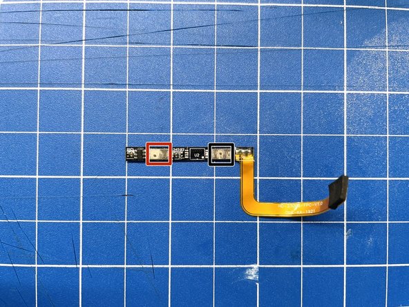

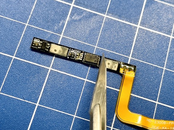

  10. Wahoo Elemnt Roam (WFCC4) Screen and Battery Replacement, Clean up Old Battery Circuit Board: crwdns2935265:010crwdnd2935265:01crwdnd2935265:03crwdne2935265:0 Wahoo Elemnt Roam (WFCC4) Screen and Battery Replacement, Clean up Old Battery Circuit Board: crwdns2935265:010crwdnd2935265:02crwdnd2935265:03crwdne2935265:0 Wahoo Elemnt Roam (WFCC4) Screen and Battery Replacement, Clean up Old Battery Circuit Board: crwdns2935265:010crwdnd2935265:03crwdnd2935265:03crwdne2935265:0
    • Although the new battery comes with its own circuit board, we'll have to use the old one as an intermediary / extension
    • Remove the remaining pieces of the old battery connectors from the two main pads. Be careful not to rip off the pads from the circuit board.
    • To avoid any conflicts between the logic of the old battery's IC and the IC of the new one, we have to remove the old one. Remove the small IC from the circuit board using an exacto knife or similar
    • Use a soldering iron and some soldering wick to remove the remaining solder from the pads for the IC
    • Note The pad to the left of the IC (U2) is for the positive side, and the pad to the right of the IC is for the negative side (see last picture for correct orientation)

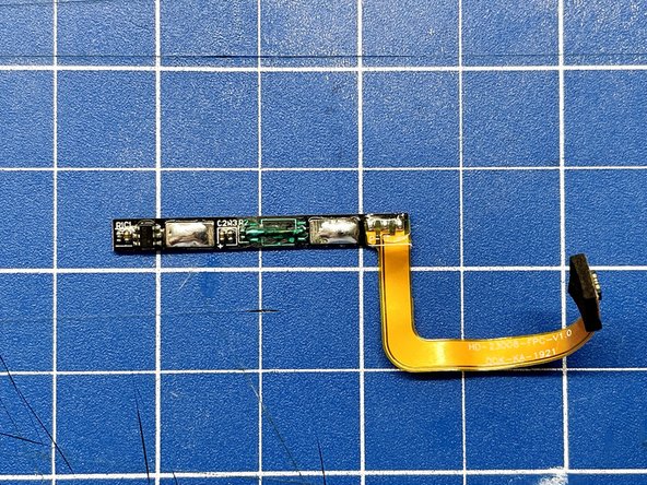

  11. Wahoo Elemnt Roam (WFCC4) Screen and Battery Replacement, Solder Bodge Wire to Old Battery Circuit Board: crwdns2935265:011crwdnd2935265:01crwdnd2935265:03crwdne2935265:0 Wahoo Elemnt Roam (WFCC4) Screen and Battery Replacement, Solder Bodge Wire to Old Battery Circuit Board: crwdns2935265:011crwdnd2935265:02crwdnd2935265:03crwdne2935265:0 Wahoo Elemnt Roam (WFCC4) Screen and Battery Replacement, Solder Bodge Wire to Old Battery Circuit Board: crwdns2935265:011crwdnd2935265:03crwdnd2935265:03crwdne2935265:0

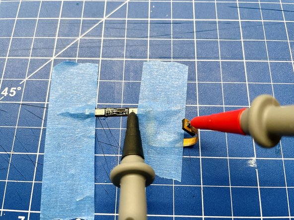

    • We have to solder a bodge wire to create a permanent connection between the negative side of the old battery's circuit board and the ribbon cable.
    • Solder a small enamelled copper wire to bridge the two center pads of the IC (red circles first picture)
    • Use a multimeter to check the connection between the negative side of the circuit board and the ribbon cable
    • Add some solder to the positive and negative tabs of the board to prepare them for soldering later
    • You can also add some solder mask to the bodge wire for extra protection

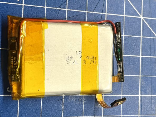

    • Add some fresh solder to the pads and solder two thin, flexible wires to the positive and negative tabs of the circuit board
    • Please take note of the wires' orientation. As you'll have to wrap the wires around the battery to fit the battery and wires into the case, solder them at an angle to make your life easier

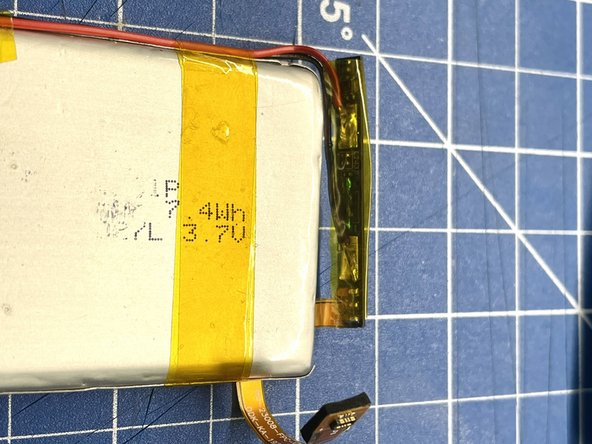

  13. Wahoo Elemnt Roam (WFCC4) Screen and Battery Replacement, Secure Circuit Board and Wires: crwdns2935265:013crwdnd2935265:01crwdnd2935265:01crwdne2935265:0
    • Fold the new battery's circuit board over and inwards
    • Use some kapton tape to secure the circuit board
    • Lead the wires around the side of the battery and secure them with kapton tape as well
    • Make sure the whole assembly is tightly packed and tidy to save space
    • Use a multimeter to check for the battery's voltage to ensure the wires are connected correctly and that there's no short
  14. Wahoo Elemnt Roam (WFCC4) Screen and Battery Replacement, Solder Leads to Old Battery's Circuit Board: crwdns2935265:014crwdnd2935265:01crwdnd2935265:03crwdne2935265:0 Wahoo Elemnt Roam (WFCC4) Screen and Battery Replacement, Solder Leads to Old Battery's Circuit Board: crwdns2935265:014crwdnd2935265:02crwdnd2935265:03crwdne2935265:0 Wahoo Elemnt Roam (WFCC4) Screen and Battery Replacement, Solder Leads to Old Battery's Circuit Board: crwdns2935265:014crwdnd2935265:03crwdnd2935265:03crwdne2935265:0
    • Solder the positive and negative leads to the pads of the old battery's circuit board, which we prepared earlier
    • Please take note of the circuit board's and the ribbon cable's orientation. The ribbon cable has to run under the battery and then wrap around it, to ensure proper orientation with the connector on the mainboard
    • Wrap the circuit board in kapton tape and secure it closely to the battery, to create a tight and tidy package
    • Use a multimeter to check for voltage at the ribbon cable's end points, to check for a proper connection
