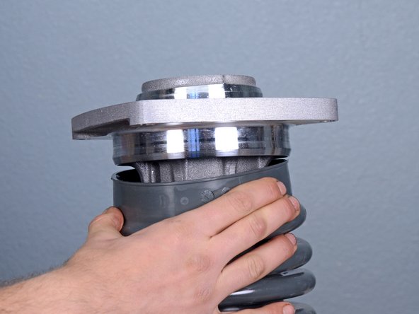

  8. Wacker 4-Stroke Rammer BS504AS REV 101 (2019) Bellows Replacement, Reveal the pin: crwdns2935265:08crwdnd2935265:01crwdnd2935265:03crwdne2935265:0 Wacker 4-Stroke Rammer BS504AS REV 101 (2019) Bellows Replacement, Reveal the pin: crwdns2935265:08crwdnd2935265:02crwdnd2935265:03crwdne2935265:0 Wacker 4-Stroke Rammer BS504AS REV 101 (2019) Bellows Replacement, Reveal the pin: crwdns2935265:08crwdnd2935265:03crwdnd2935265:03crwdne2935265:0
    • Continue to separate the two halves by compressing the bellows until the nylon plug covering the piston pin is visible.
  9. Wacker 4-Stroke Rammer BS504AS REV 101 (2019) Bellows Replacement, Procedure tip: crwdns2935265:09crwdnd2935265:01crwdnd2935265:02crwdne2935265:0 Wacker 4-Stroke Rammer BS504AS REV 101 (2019) Bellows Replacement, Procedure tip: crwdns2935265:09crwdnd2935265:02crwdnd2935265:02crwdne2935265:0
    • Tip: To compress the bellows, insert a block of wood between the two halves and pivot the leg assembly off of the crankcase to compress the guide cylinder, revealing the pin.

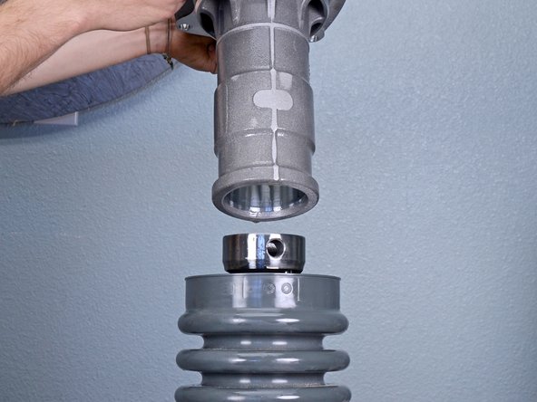

  11. Wacker 4-Stroke Rammer BS504AS REV 101 (2019) Bellows Replacement, Remove the leg assembly: crwdns2935265:011crwdnd2935265:01crwdnd2935265:02crwdne2935265:0 Wacker 4-Stroke Rammer BS504AS REV 101 (2019) Bellows Replacement, Remove the leg assembly: crwdns2935265:011crwdnd2935265:02crwdnd2935265:02crwdne2935265:0
    • Remove the leg assembly from the crankcase.
  12. Wacker 4-Stroke Rammer BS504AS REV 101 (2019) Bellows Replacement, Completely remove the pin: crwdns2935265:012crwdnd2935265:01crwdnd2935265:02crwdne2935265:0 Wacker 4-Stroke Rammer BS504AS REV 101 (2019) Bellows Replacement, Completely remove the pin: crwdns2935265:012crwdnd2935265:02crwdnd2935265:02crwdne2935265:0
    • Use a punch and hammer to tap the pin out of the guide piston.
    • Once the pin is removed, the guide cylinder may spring up due to the compression of the bellows.
    • During reassembly, the bellows will need to be compressed to uncover the pin hole on the guide piston.

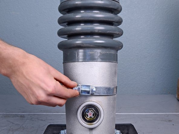

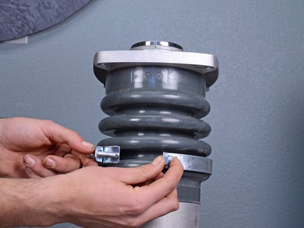

  13. Wacker 4-Stroke Rammer BS504AS REV 101 (2019) Bellows Replacement, Remove the hose clamps: crwdns2935265:013crwdnd2935265:01crwdnd2935265:01crwdne2935265:0
    • Use a 13 mm socket or large flathead screwdriver to loosen the two hose clamp bolts securing the bellows to the leg assembly.
  14. Wacker 4-Stroke Rammer BS504AS REV 101 (2019) Bellows Replacement: crwdns2935265:014crwdnd2935265:01crwdnd2935265:02crwdne2935265:0 Wacker 4-Stroke Rammer BS504AS REV 101 (2019) Bellows Replacement: crwdns2935265:014crwdnd2935265:02crwdnd2935265:02crwdne2935265:0
    • Lower the bottom hose clamp away from the bellows and let it rest at the base of the leg assembly.
  15. Wacker 4-Stroke Rammer BS504AS REV 101 (2019) Bellows Replacement: crwdns2935265:015crwdnd2935265:01crwdnd2935265:02crwdne2935265:0 Wacker 4-Stroke Rammer BS504AS REV 101 (2019) Bellows Replacement: crwdns2935265:015crwdnd2935265:02crwdnd2935265:02crwdne2935265:0
    • Open the top hose clamp and pull it down, past the bellows, and let it rest at the base of the leg assembly.

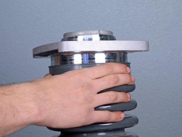

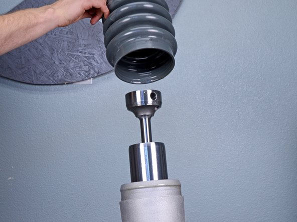

  16. Wacker 4-Stroke Rammer BS504AS REV 101 (2019) Bellows Replacement, Remove the bellows from the guide cylinder: crwdns2935265:016crwdnd2935265:01crwdnd2935265:03crwdne2935265:0 Wacker 4-Stroke Rammer BS504AS REV 101 (2019) Bellows Replacement, Remove the bellows from the guide cylinder: crwdns2935265:016crwdnd2935265:02crwdnd2935265:03crwdne2935265:0 Wacker 4-Stroke Rammer BS504AS REV 101 (2019) Bellows Replacement, Remove the bellows from the guide cylinder: crwdns2935265:016crwdnd2935265:03crwdnd2935265:03crwdne2935265:0
    • Use a rubber mallet to tap the bellows down and off of the top of the guide cylinder.
    • Tap around the entire circumference of the bellows, pulling one edge down at a time.
    • During reassembly, use the rubber mallet to tap the bellows into place onto the lip on the cylinder.
    • Once loose, pull the bellows off of the lip on the guide cylinder.

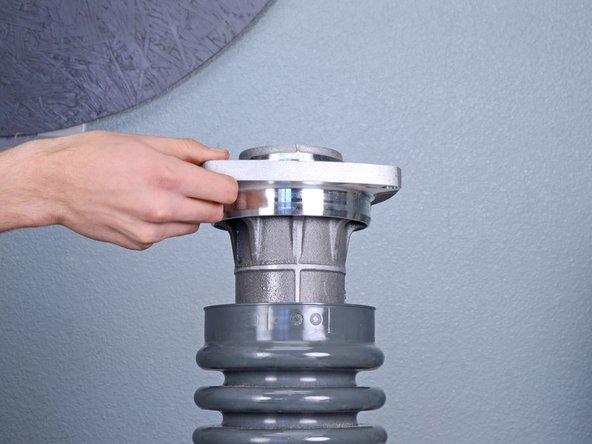

  17. Wacker 4-Stroke Rammer BS504AS REV 101 (2019) Bellows Replacement, Remove the guide cylinder: crwdns2935265:017crwdnd2935265:01crwdnd2935265:03crwdne2935265:0 Wacker 4-Stroke Rammer BS504AS REV 101 (2019) Bellows Replacement, Remove the guide cylinder: crwdns2935265:017crwdnd2935265:02crwdnd2935265:03crwdne2935265:0 Wacker 4-Stroke Rammer BS504AS REV 101 (2019) Bellows Replacement, Remove the guide cylinder: crwdns2935265:017crwdnd2935265:03crwdnd2935265:03crwdne2935265:0
    • Lift up and remove the guide cylinder.

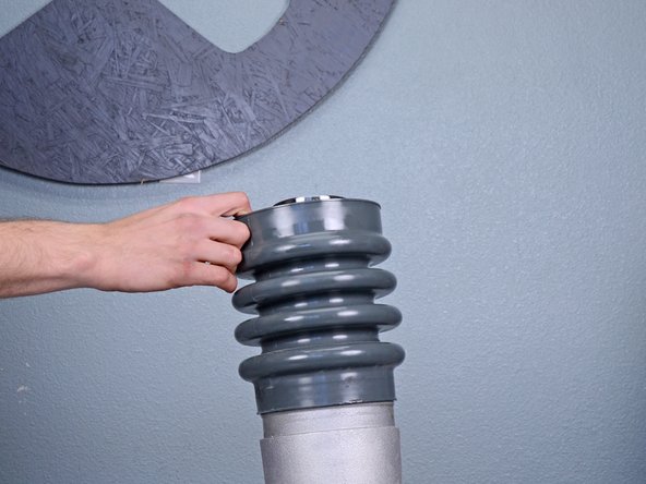

  18. Wacker 4-Stroke Rammer BS504AS REV 101 (2019) Bellows Replacement, Remove the bellows: crwdns2935265:018crwdnd2935265:01crwdnd2935265:03crwdne2935265:0 Wacker 4-Stroke Rammer BS504AS REV 101 (2019) Bellows Replacement, Remove the bellows: crwdns2935265:018crwdnd2935265:02crwdnd2935265:03crwdne2935265:0 Wacker 4-Stroke Rammer BS504AS REV 101 (2019) Bellows Replacement, Remove the bellows: crwdns2935265:018crwdnd2935265:03crwdnd2935265:03crwdne2935265:0
    • Use a rubber mallet to tap the bellows up and off of the top of the protective pipe.
    • Tap around the entire circumference of the bellows, pulling one edge up at a time.
    • During reassembly, use the rubber mallet to tap the bellows into place onto the lip on the pipe.
    • Once loose, pull the bellows off of the lip on the protective pipe.
    • Remove the bellows.
