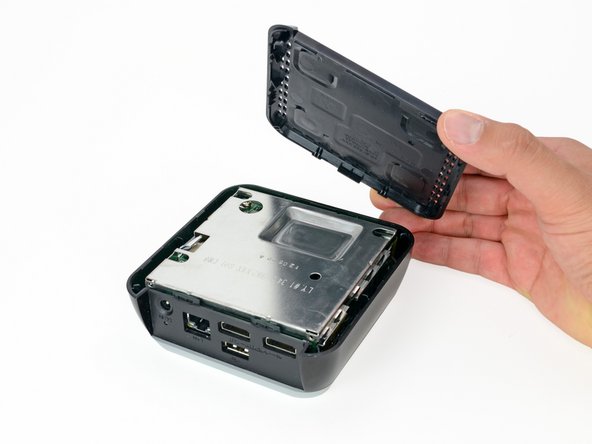

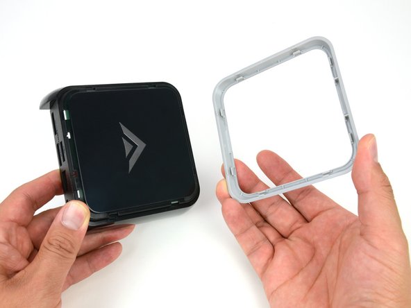

  3. Vizio Co-Star Teardown: crwdns2935265:03crwdnd2935265:01crwdnd2935265:02crwdne2935265:0 Vizio Co-Star Teardown: crwdns2935265:03crwdnd2935265:02crwdnd2935265:02crwdne2935265:0
    • A little prying around the edge with a plastic opening tool, and we've got the bottom panel free.
    • Comparatively speaking, the Apple TV required two metal spudgers to open, as opposed to a single plastic opening tool here. No need to split hairs; they're both easy to open up, and we love it.

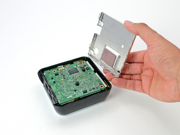

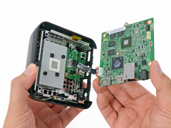

  4. Vizio Co-Star Teardown: crwdns2935265:04crwdnd2935265:01crwdnd2935265:02crwdne2935265:0 Vizio Co-Star Teardown: crwdns2935265:04crwdnd2935265:02crwdnd2935265:02crwdne2935265:0
    • We pull off what looks like an EMI shield only to find a thermal pad sitting on top of a sea of small resistors.
    • It's not often that we encounter cooling for the back side of a motherboard, but Vizio took extra precautions as this Co-Star has no fans.

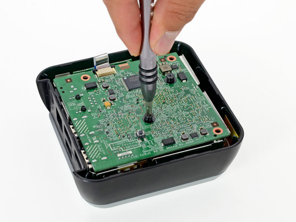

  5. Vizio Co-Star Teardown: crwdns2935265:05crwdnd2935265:01crwdnd2935265:03crwdne2935265:0 Vizio Co-Star Teardown: crwdns2935265:05crwdnd2935265:02crwdnd2935265:03crwdne2935265:0 Vizio Co-Star Teardown: crwdns2935265:05crwdnd2935265:03crwdnd2935265:03crwdne2935265:0
    • The only thing standing between us and the motherboard are some screws and two connectors. Say hello to our little friend!
    • For those of you tuning in at home, a grand total of five screws and two cables must be removed once inside the device to free the motherboard. That's going to give the Co-Star a nice ratings boost.

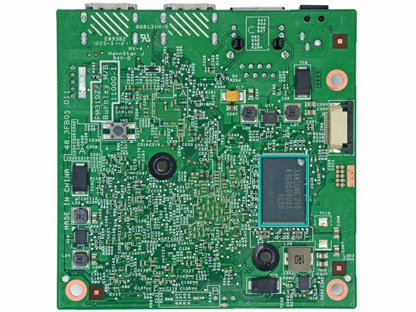

  6. Vizio Co-Star Teardown: crwdns2935265:06crwdnd2935265:01crwdnd2935265:02crwdne2935265:0 Vizio Co-Star Teardown: crwdns2935265:06crwdnd2935265:02crwdnd2935265:02crwdne2935265:0
    • And here comes the Co-Star's motherboard strolling down the red carpet:
    • Marvell Armada 1500 1.2 GHz Dual-Core Processor
    • Marvell 88DE2755 QDEO Video Processor
    • Nanya NT5CB256M8GN-DI 2 Gb DDR3 SD RAM (2 Gb x 4 for 1 GB total RAM)
    • Samsung K9GBG08U0A-SCBO 32 Gb (4 GB) NAND Flash

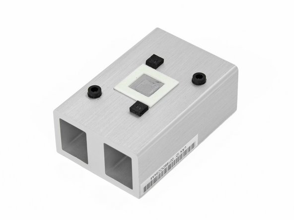

    • We're used to the innards of devices being dominated by a single component, but those space hogs are usually batteries or power supplies.
    • Over a third of the real estate in the Co-Star is inhabited by the aluminum heat sink.
    • You may be asking yourself why the Co-Star has such a huge heat sink?
    • The answer lies in air movement. Without fans to circulate air, there is no forced convection. Therefore, the Co-Star must rely on conduction and natural convection to keep the processor cool.

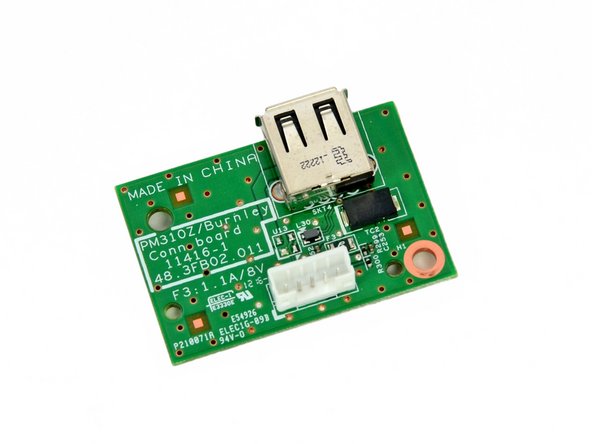

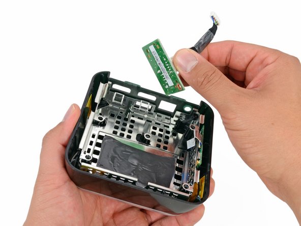

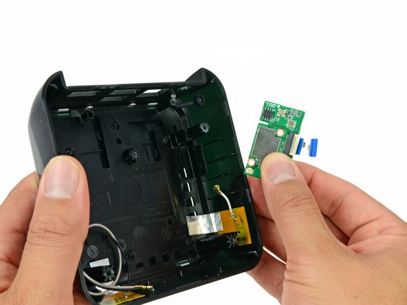

    • We remove an additional board to reveal a whole lot of nothin' underneath.
    • The board houses the USB port and, well, nothing else.

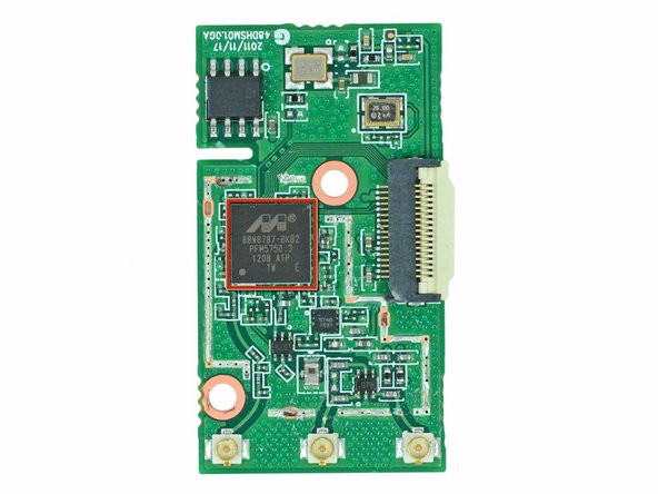

    • We use our always-trusty spudger to disconnect the Bluetooth and Wi-Fi antenna cables from the wireless board.
    • A Marvell Avastar 88W8787 WLAN/Bluetooth/FM Single-Chip SoC brings life to what would otherwise be a very bland and boring board.

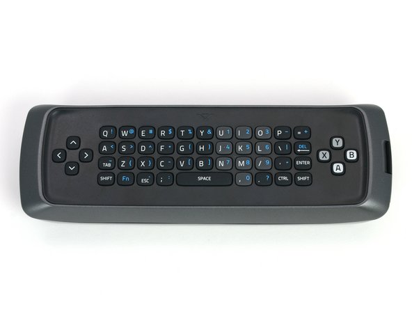

  12. Vizio Co-Star Teardown: crwdns2935265:012crwdnd2935265:01crwdnd2935265:02crwdne2935265:0 Vizio Co-Star Teardown: crwdns2935265:012crwdnd2935265:02crwdnd2935265:02crwdne2935265:0
    • Just like the Boxee Box, the Co-Star comes with a neat two-sided remote.
    • Unlike the Boxee Box though, this Vizio controller is universal and features a touch-sensitive trackpad. Point, Co-Star.
    • As a finishing touch, the Co-Star remote has ABXY buttons and a directional pad for OnLive gaming. Not only is that an incredibly unique feature, it gets us all nostalgic and stuff.

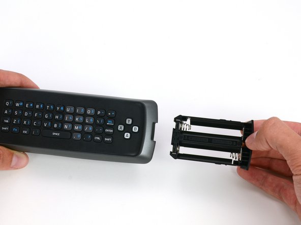

    • The battery tray comes right out, but this isn't much of a surprise. How often did you try to "fix" your TV remote by pulling out the old batteries and just switching them around?
    • A pair of AA batteries were included for the remote. That's a legitimate selling point right there.

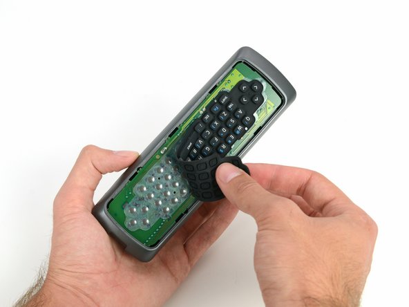

  14. Vizio Co-Star Teardown: crwdns2935265:014crwdnd2935265:01crwdnd2935265:03crwdne2935265:0 Vizio Co-Star Teardown: crwdns2935265:014crwdnd2935265:02crwdnd2935265:03crwdne2935265:0 Vizio Co-Star Teardown: crwdns2935265:014crwdnd2935265:03crwdnd2935265:03crwdne2935265:0

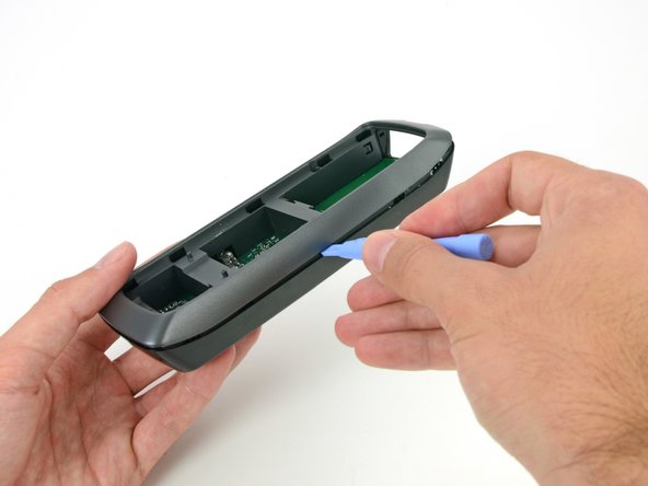

    • Here's another opportunity for the modders out there. How cool would it be to have a neon green keyboard bezel to match your Co-Star?
    • Whether you're painting it or not, the bezel pries off the keyboard quite easily.
    • Following suit, the rubber button cover peels off without a problem.
    • Since the button cover and the bezel are the components that usually get the dirtiest, it's great they are easy to remove.

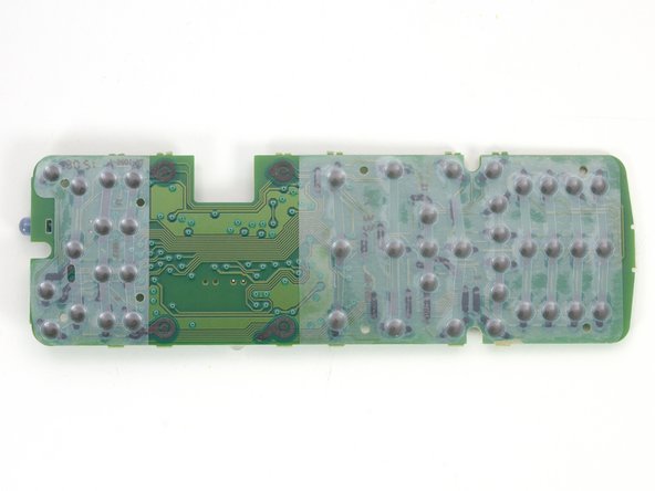

  16. Vizio Co-Star Teardown: crwdns2935265:016crwdnd2935265:01crwdnd2935265:02crwdne2935265:0 Vizio Co-Star Teardown: crwdns2935265:016crwdnd2935265:02crwdnd2935265:02crwdne2935265:0
    • The keyboard backer sports a couple of ICs:
    • Maxim MAXQ610 16-bit Microcontroller with Infrared Module
    • Broadcom BCM20733 Human Interface Device Bluetooth 3.0 single chip

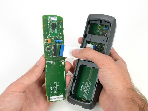

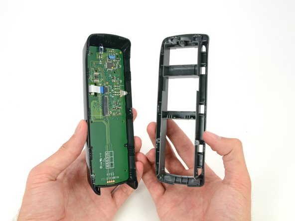

    • A few Phillips #0 screws and some prying and the lower case of the remote is gone. See ya!
    • With the case removed, we learn the screws were pulling double duty and holding the motherboard in place.

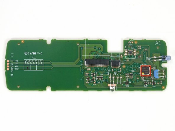

  18. Vizio Co-Star Teardown: crwdns2935265:018crwdnd2935265:01crwdnd2935265:03crwdne2935265:0 Vizio Co-Star Teardown: crwdns2935265:018crwdnd2935265:02crwdnd2935265:03crwdne2935265:0 Vizio Co-Star Teardown: crwdns2935265:018crwdnd2935265:03crwdnd2935265:03crwdne2935265:0

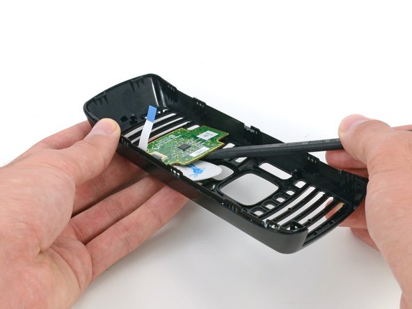

    • Yoink!
    • We grab a handy pair of tweezers and gently pluck out the trackpad data cable before removing the other board.
    • This board is powered by a Renesas R5F2133 16-bit microcontroller.
    • No flash photography, please, but this PCB does host the two IR blasters, with one conveniently on the side for the QWERTY keyboard.

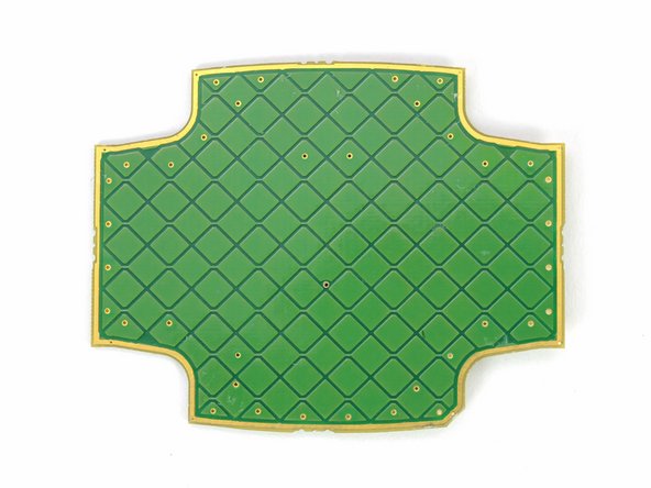

  19. Vizio Co-Star Teardown: crwdns2935265:019crwdnd2935265:01crwdnd2935265:03crwdne2935265:0 Vizio Co-Star Teardown: crwdns2935265:019crwdnd2935265:02crwdnd2935265:03crwdne2935265:0 Vizio Co-Star Teardown: crwdns2935265:019crwdnd2935265:03crwdnd2935265:03crwdne2935265:0
    iFixit Opening Picks (Set of 6)

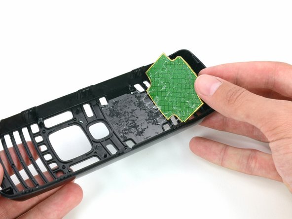

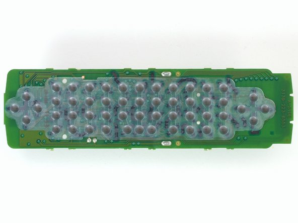

    • Peeling back the remote's keypad is as easy as peeling a banana. Underneath is the capacitive touch trackpad.
    • A lot of strong adhesive is used to hold this board in place.
    • If this comes loose, your movie night will be gone with the wind, hence the generous amount of adhesive.
    • Excess adhesive usually doesn't get in our way. With a little bit of patience, our iFixit guitar picks, and a spudger, we free the trackpad from the frame.
  20. Vizio Co-Star Teardown: crwdns2935265:020crwdnd2935265:01crwdnd2935265:02crwdne2935265:0 Vizio Co-Star Teardown: crwdns2935265:020crwdnd2935265:02crwdnd2935265:02crwdne2935265:0
    • The trackpad is controlled by the popular Synaptics T1021A Touch Controller, also used in the Logitech Revue.
