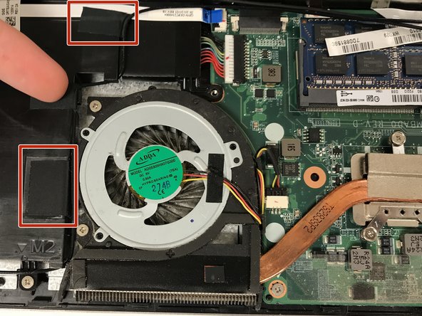

  5. Toshiba Satellite U840W Speakers Replacement, Speakers: crwdns2935265:06crwdnd2935265:01crwdnd2935265:02crwdne2935265:0 Toshiba Satellite U840W Speakers Replacement, Speakers: crwdns2935265:06crwdnd2935265:02crwdnd2935265:02crwdne2935265:0
    • Remove the two 5mm screws using a Phillips #00 screwdriver.
    • Remove the left speaker.

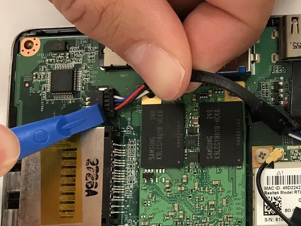

  6. Toshiba Satellite U840W Speakers Replacement: crwdns2935265:07crwdnd2935265:01crwdnd2935265:03crwdne2935265:0 Toshiba Satellite U840W Speakers Replacement: crwdns2935265:07crwdnd2935265:02crwdnd2935265:03crwdne2935265:0 Toshiba Satellite U840W Speakers Replacement: crwdns2935265:07crwdnd2935265:03crwdnd2935265:03crwdne2935265:0
    • Remove tape holding the speaker wire.
    • Follow length of wire to the connector while removing the tape.
    • Remove connector.
