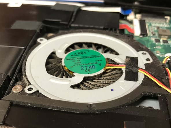

  5. Toshiba Satellite U840W Processor Fan Replacement., Processor Fan: crwdns2935265:06crwdnd2935265:01crwdnd2935265:02crwdne2935265:0 Toshiba Satellite U840W Processor Fan Replacement., Processor Fan: crwdns2935265:06crwdnd2935265:02crwdnd2935265:02crwdne2935265:0
    • Remove the three 3mm screws using a Phillips #00 screwdriver.

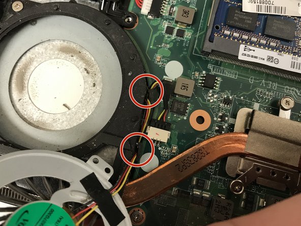

  6. Toshiba Satellite U840W Processor Fan Replacement.: crwdns2935265:07crwdnd2935265:01crwdnd2935265:02crwdne2935265:0 Toshiba Satellite U840W Processor Fan Replacement.: crwdns2935265:07crwdnd2935265:02crwdnd2935265:02crwdne2935265:0
    • A plastic prying tool can be used to help you remove the fan.
    • Plastic wire guides hold the wire in place. Manipulate the wire out from these guides.
  7. Toshiba Satellite U840W Processor Fan Replacement.: crwdns2935265:08crwdnd2935265:01crwdnd2935265:02crwdne2935265:0 Toshiba Satellite U840W Processor Fan Replacement.: crwdns2935265:08crwdnd2935265:02crwdnd2935265:02crwdne2935265:0
    • Remove the connector from the motherboard.
