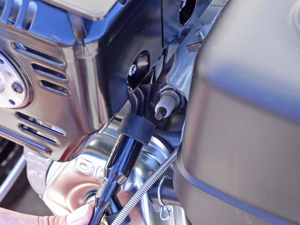

  3. Toro Stump Grinder SGR-13 22615HD 2017 Drive Belt Replacement, Disconnect the spark plug: crwdns2935265:03crwdnd2935265:01crwdnd2935265:02crwdne2935265:0 Toro Stump Grinder SGR-13 22615HD 2017 Drive Belt Replacement, Disconnect the spark plug: crwdns2935265:03crwdnd2935265:02crwdnd2935265:02crwdne2935265:0
    • Grab the plastic housing at the end of the spark plug wire.
    • Pull firmly to disconnect the wire from the spark plug.

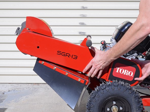

  4. Toro Stump Grinder SGR-13 22615HD 2017 Drive Belt Replacement, Tilt the cutter wheel up: crwdns2935265:04crwdnd2935265:01crwdnd2935265:01crwdne2935265:0
    • Tilt the machine so that it is resting on the handle with the cutter wheel raised.

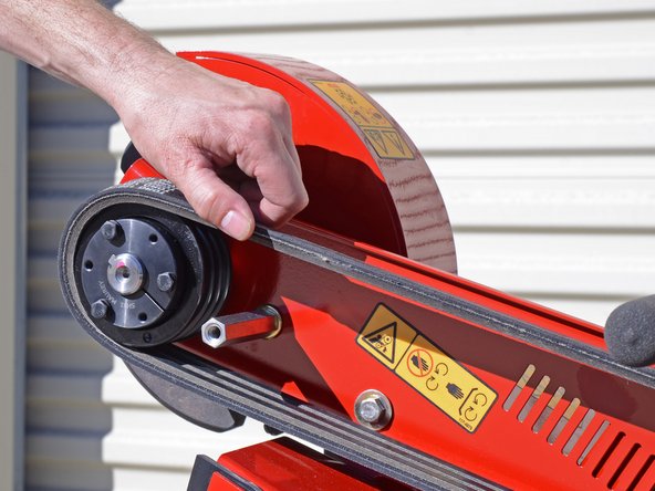

  6. Toro Stump Grinder SGR-13 22615HD 2017 Drive Belt Replacement: crwdns2935265:06crwdnd2935265:01crwdnd2935265:03crwdne2935265:0 Toro Stump Grinder SGR-13 22615HD 2017 Drive Belt Replacement: crwdns2935265:06crwdnd2935265:02crwdnd2935265:03crwdne2935265:0 Toro Stump Grinder SGR-13 22615HD 2017 Drive Belt Replacement: crwdns2935265:06crwdnd2935265:03crwdnd2935265:03crwdne2935265:0
    • Remove the belt guard.

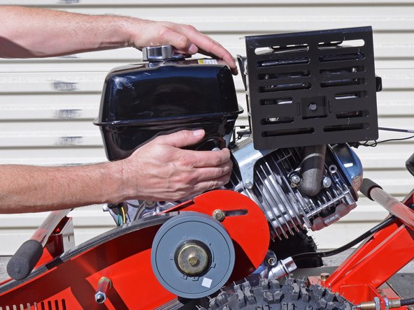

  7. Toro Stump Grinder SGR-13 22615HD 2017 Drive Belt Replacement, Remove the drive belt: crwdns2935265:07crwdnd2935265:01crwdnd2935265:03crwdne2935265:0 Toro Stump Grinder SGR-13 22615HD 2017 Drive Belt Replacement, Remove the drive belt: crwdns2935265:07crwdnd2935265:02crwdnd2935265:03crwdne2935265:0 Toro Stump Grinder SGR-13 22615HD 2017 Drive Belt Replacement, Remove the drive belt: crwdns2935265:07crwdnd2935265:03crwdnd2935265:03crwdne2935265:0
    • Use a 9/16 inch socket to loosen the four nuts securing the bottom of the motor enough to allow the motor to slide freely. Do not remove the nuts.
    • Use a 1/2 inch wrench in combination with the socket wrench to hold the bolts in place.
  8. Toro Stump Grinder SGR-13 22615HD 2017 Drive Belt Replacement: crwdns2935265:08crwdnd2935265:01crwdnd2935265:01crwdne2935265:0
    • Use a 1/2 inch wrench to loosen the two bolts behind the centrifugal clutch enough to allow the motor to slide freely. Do not remove the bolts.
  9. Toro Stump Grinder SGR-13 22615HD 2017 Drive Belt Replacement: crwdns2935265:09crwdnd2935265:01crwdnd2935265:02crwdne2935265:0 Toro Stump Grinder SGR-13 22615HD 2017 Drive Belt Replacement: crwdns2935265:09crwdnd2935265:02crwdnd2935265:02crwdne2935265:0
    • Wrap a piece of tape around the upper half of the tensioner bolt to mark the location of the second nut.
    • Use a 9/16 inch wrench to loosen the nut on the lower half of the tensioner bolt until the motor can slide forward as much as possible.
    • During reassembly, reference the tape to position the outer nut into the same location as before to ensure proper belt tension.
  10. Toro Stump Grinder SGR-13 22615HD 2017 Drive Belt Replacement: crwdns2935265:010crwdnd2935265:01crwdnd2935265:02crwdne2935265:0 Toro Stump Grinder SGR-13 22615HD 2017 Drive Belt Replacement: crwdns2935265:010crwdnd2935265:02crwdnd2935265:02crwdne2935265:0

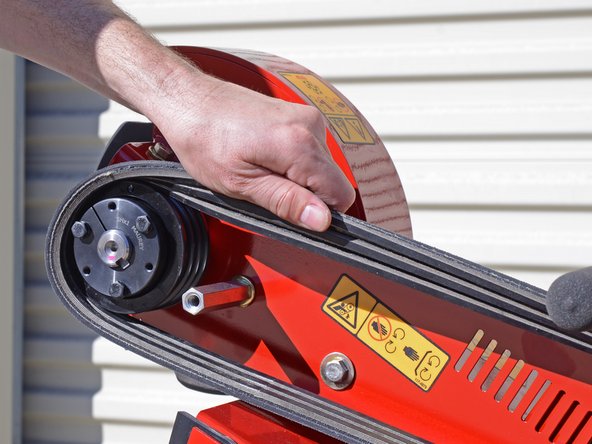

    • Slide the engine towards the cutter blade to loosen the drive belt.
  11. Toro Stump Grinder SGR-13 22615HD 2017 Drive Belt Replacement: crwdns2935265:011crwdnd2935265:01crwdnd2935265:03crwdne2935265:0 Toro Stump Grinder SGR-13 22615HD 2017 Drive Belt Replacement: crwdns2935265:011crwdnd2935265:02crwdnd2935265:03crwdne2935265:0 Toro Stump Grinder SGR-13 22615HD 2017 Drive Belt Replacement: crwdns2935265:011crwdnd2935265:03crwdnd2935265:03crwdne2935265:0
    • Lift the drive belt up and away from the machine while rolling it towards the cutter head to gradually roll it off of the pulley.
  12. Toro Stump Grinder SGR-13 22615HD 2017 Drive Belt Replacement: crwdns2935265:012crwdnd2935265:01crwdnd2935265:01crwdne2935265:0
    • Remove the drive belt.
