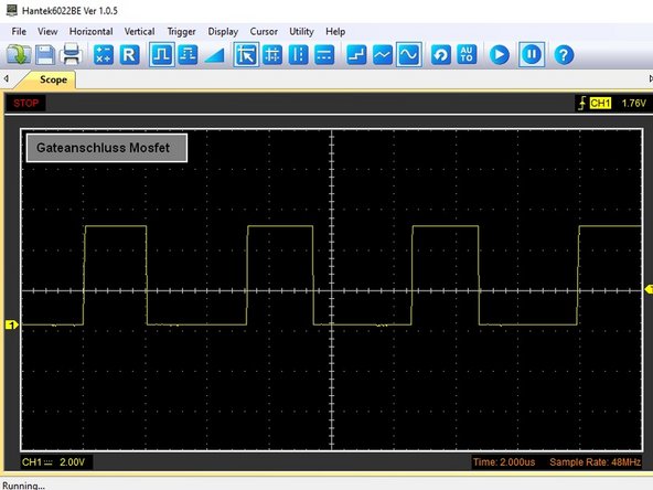

  3. Teufel Rockster electronics repair, Check your work: crwdns2935265:03crwdnd2935265:01crwdnd2935265:03crwdne2935265:0 Teufel Rockster electronics repair, Check your work: crwdns2935265:03crwdnd2935265:02crwdnd2935265:03crwdne2935265:0 Teufel Rockster electronics repair, Check your work: crwdns2935265:03crwdnd2935265:03crwdnd2935265:03crwdne2935265:0
    • Follow this step to test the power supply after a repair (as described in step 2 / option 1)
    • Connect an external 12V power supply to the board's power terminals.
    • Supply 3.3V to pin 5 of the header.
    • At the output (green and yellow crocodile clips), there should now be 25V in no-load mode. If the output is loaded with a 10 Ohm resistor, the power consumption should be ~100 watts.
    • When the output is loaded, probing the MOSFET control pin with an oscilloscope should look like the third image.
    • But before I got that far, I had to replace the following components: The PWM generator Tps40090, a gate driver UCC27324 and a feedback resistor 2R29 with 200 ohms
