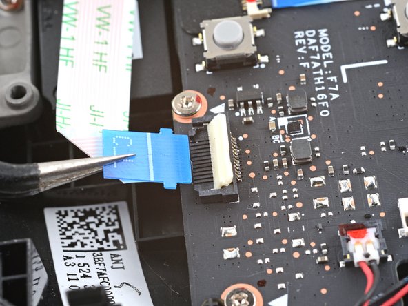

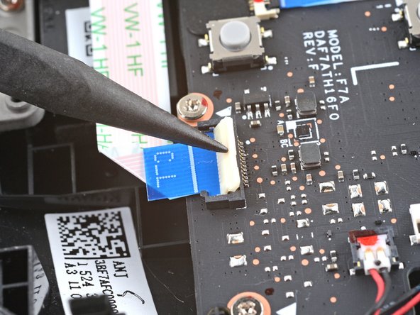

  25. Steam Deck Speakers Replacement, Disconnect the button  board interconnect cable: crwdns2935265:025crwdnd2935265:01crwdnd2935265:03crwdne2935265:0 Steam Deck Speakers Replacement, Disconnect the button  board interconnect cable: crwdns2935265:025crwdnd2935265:02crwdnd2935265:03crwdne2935265:0 Steam Deck Speakers Replacement, Disconnect the button  board interconnect cable: crwdns2935265:025crwdnd2935265:03crwdnd2935265:03crwdne2935265:0
    • Use the pointed end of a spudger to lift up the small locking flap on the button board interconnect cable's ZIF connector on the left button board.
    • Use a pair of tweezers to slide the cable out of its connector.
    • Grip the cable by the blue pull tab, not by the cable itself.

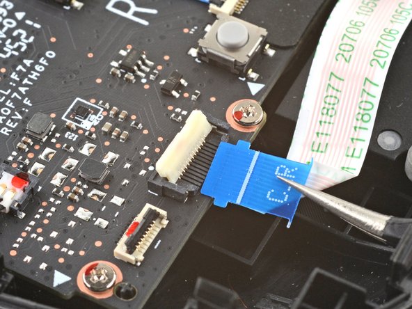

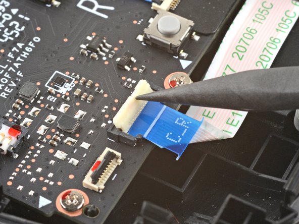

  26. Steam Deck Speakers Replacement: crwdns2935265:026crwdnd2935265:01crwdnd2935265:03crwdne2935265:0 Steam Deck Speakers Replacement: crwdns2935265:026crwdnd2935265:02crwdnd2935265:03crwdne2935265:0 Steam Deck Speakers Replacement: crwdns2935265:026crwdnd2935265:03crwdnd2935265:03crwdne2935265:0
    • Use the pointed end of a spudger to lift up the small locking flap on the button board interconnect cable's ZIF connector on the right button board.

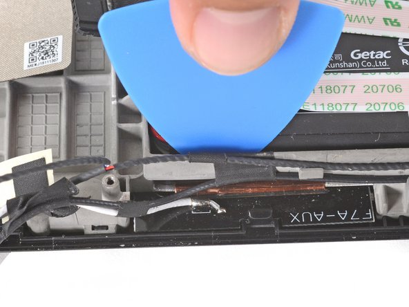

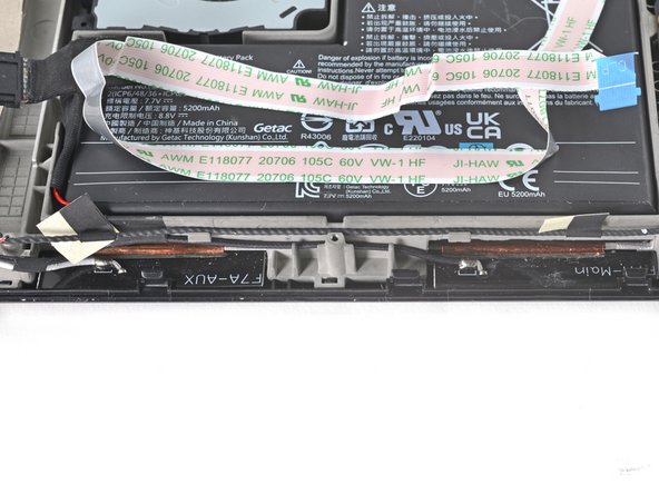

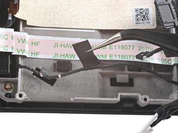

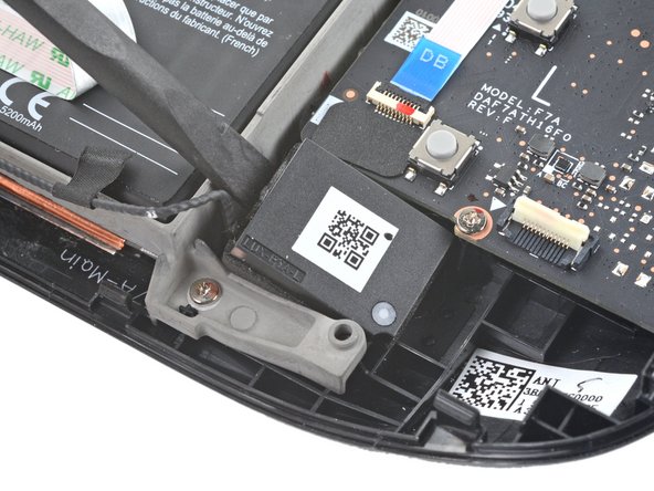

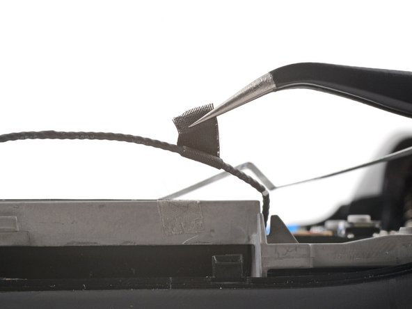

  27. Steam Deck Speakers Replacement, Isolate the speaker wire: crwdns2935265:027crwdnd2935265:01crwdnd2935265:01crwdne2935265:0
    • Use a pair of tweezers to peel up the tape bundling the speaker wire to the Wi-Fi antenna cables.

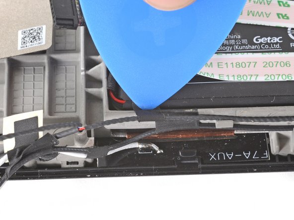

  28. Steam Deck Speakers Replacement: crwdns2935265:028crwdnd2935265:01crwdnd2935265:03crwdne2935265:0 Steam Deck Speakers Replacement: crwdns2935265:028crwdnd2935265:02crwdnd2935265:03crwdne2935265:0 Steam Deck Speakers Replacement: crwdns2935265:028crwdnd2935265:03crwdnd2935265:03crwdne2935265:0
    • Use a pair of tweezers to peel up the various strips of black tape routing the speaker wire along the bottom edge of the chassis.

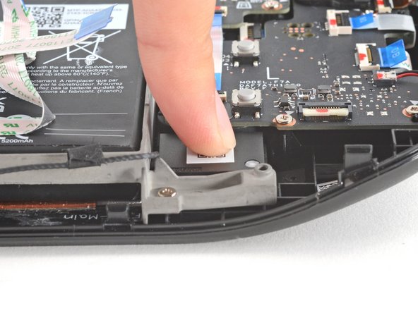

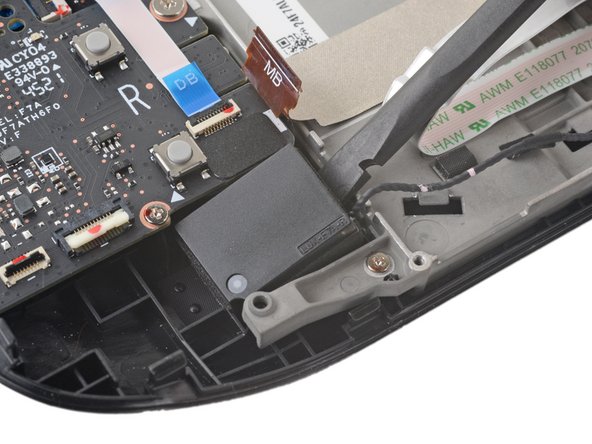

  29. Steam Deck Speakers Replacement, Remove the right speaker: crwdns2935265:029crwdnd2935265:01crwdnd2935265:02crwdne2935265:0 Steam Deck Speakers Replacement, Remove the right speaker: crwdns2935265:029crwdnd2935265:02crwdnd2935265:02crwdne2935265:0
    • Insert the flat end of a spudger between the right speaker and the frame.
    • Pivot the spudger up to separate the speaker from the light adhesive securing it against the front shell.
    • If the adhesive is stubborn, don't force the speaker out. Lightly heat it using an iOpener or a hair dryer to soften the adhesive underneath.

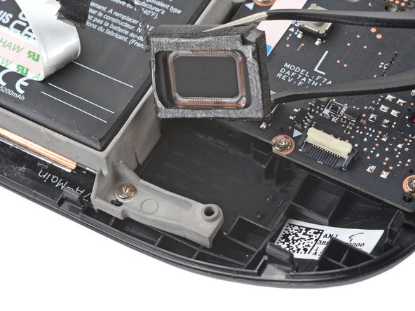

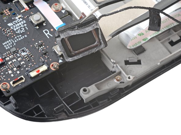

  30. Steam Deck Speakers Replacement: crwdns2935265:030crwdnd2935265:01crwdnd2935265:02crwdne2935265:0 Steam Deck Speakers Replacement: crwdns2935265:030crwdnd2935265:02crwdnd2935265:02crwdne2935265:0
    • Use a pair of tweezers to grip and remove the right speaker from its cavity.
    • When removing the speaker, ensure that the fragile speaker mesh underneath stays in place. During reassembly, make sure it's uncreased and lays flat against the front shell.

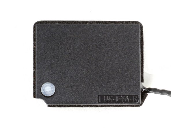

  34. Steam Deck Speakers Replacement, Reassembly tip: crwdns2935265:034crwdnd2935265:01crwdnd2935265:02crwdne2935265:0 Steam Deck Speakers Replacement, Reassembly tip: crwdns2935265:034crwdnd2935265:02crwdnd2935265:02crwdne2935265:0
    • During reassembly, note that the speakers are labeled, such as:
    • LUX-F7A-L for the left speaker.
    • LUX-F7A-R for the right speaker.

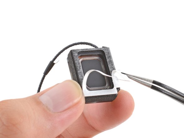

  35. Steam Deck Speakers Replacement, Prepare the surfaces: crwdns2935265:035crwdnd2935265:01crwdnd2935265:01crwdne2935265:0
    • To ensure a good adhesive bond, thoroughly clean all adhesion surfaces.
    • Use adhesive remover or isopropyl alcohol (>90%) to remove any remaining residue. Wipe with a cotton swab or microfiber cloth until all the adhesive residue is gone.
    • While isopropyl alcohol is generally safe to use on electronics, they will dissolve certain foam adhesives. Be careful to contain the alcohol when cleaning—don't use too much.
    • Allow any leftover isopropyl alcohol to completely evaporate before reassembly.
  36. Steam Deck Speakers Replacement, Remove the speaker adhesive liners: crwdns2935265:036crwdnd2935265:01crwdnd2935265:02crwdne2935265:0 Steam Deck Speakers Replacement, Remove the speaker adhesive liners: crwdns2935265:036crwdnd2935265:02crwdnd2935265:02crwdne2935265:0
    • Peel off and discard the liners on the speakers themselves, exposing the adhesive underneath.
  37. Steam Deck Speakers Replacement, Install the new speakers: crwdns2935265:037crwdnd2935265:01crwdnd2935265:02crwdne2935265:0 Steam Deck Speakers Replacement, Install the new speakers: crwdns2935265:037crwdnd2935265:02crwdnd2935265:02crwdne2935265:0
    • Place each speaker into its slot and press firmly with your fingers to set them in place.
    • The right speaker will be on your lefthand side and vice versa when working on the Steam Deck, as it's laying upside down.
  38. Steam Deck Speakers Replacement: crwdns2935265:038crwdnd2935265:01crwdnd2935265:03crwdne2935265:0 Steam Deck Speakers Replacement: crwdns2935265:038crwdnd2935265:02crwdnd2935265:03crwdne2935265:0 Steam Deck Speakers Replacement: crwdns2935265:038crwdnd2935265:03crwdnd2935265:03crwdne2935265:0
    • Fit the speaker cable into the two hooks along the bottom of the chassis.

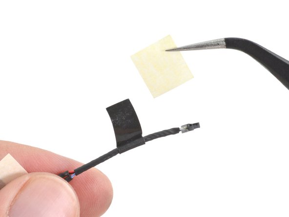

  39. Steam Deck Speakers Replacement, Remove the cable adhesive liners: crwdns2935265:039crwdnd2935265:01crwdnd2935265:02crwdne2935265:0 Steam Deck Speakers Replacement, Remove the cable adhesive liners: crwdns2935265:039crwdnd2935265:02crwdnd2935265:02crwdne2935265:0
    • Remove the adhesive liners from the tape strips along the speaker cable.
  40. Steam Deck Speakers Replacement, Route the speaker cables: crwdns2935265:040crwdnd2935265:01crwdnd2935265:03crwdne2935265:0 Steam Deck Speakers Replacement, Route the speaker cables: crwdns2935265:040crwdnd2935265:02crwdnd2935265:03crwdne2935265:0 Steam Deck Speakers Replacement, Route the speaker cables: crwdns2935265:040crwdnd2935265:03crwdnd2935265:03crwdne2935265:0
    • To ensure proper cable management, stick one speaker cable adhesive to the top edge of the chassis, leaving ~3 mm at the top unstuck.
    • Use an opening pick to wrap the adhesive over the edge of the battery tray, sticking it to the inside edge.
    • Repeat for the second cable adhesive, and continue reassembly.
