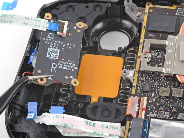

  22. Steam Deck Right Touchpad Replacement, Remove the touchpad board screws: crwdns2935265:022crwdnd2935265:01crwdnd2935265:01crwdne2935265:0
    • Use a Phillips driver to remove the four 4.7 mm screws securing the touchpad board.
  23. Steam Deck Right Touchpad Replacement, Remove the touchpad board: crwdns2935265:023crwdnd2935265:01crwdnd2935265:02crwdne2935265:0 Steam Deck Right Touchpad Replacement, Remove the touchpad board: crwdns2935265:023crwdnd2935265:02crwdnd2935265:02crwdne2935265:0
    • Remove the touchpad board.

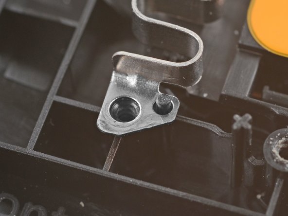

  24. Steam Deck Right Touchpad Replacement, Remove the touchpad screws: crwdns2935265:024crwdnd2935265:01crwdnd2935265:02crwdne2935265:0 Steam Deck Right Touchpad Replacement, Remove the touchpad screws: crwdns2935265:024crwdnd2935265:02crwdnd2935265:02crwdne2935265:0
    • Use a Phillips driver to remove the four 4.7 mm screws securing the touchpad.
    • You may need to temporarily remove the quick access button membrane for easier access to the bottom right screw.
    • Each of the touchpad's four mounting corners have a locating peg. During reassembly, ensure each is properly seated.

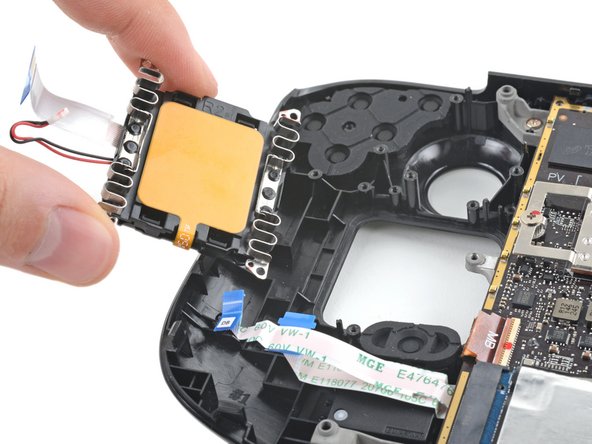

  25. Steam Deck Right Touchpad Replacement, Remove the right touchpad: crwdns2935265:025crwdnd2935265:01crwdnd2935265:03crwdne2935265:0 Steam Deck Right Touchpad Replacement, Remove the right touchpad: crwdns2935265:025crwdnd2935265:02crwdnd2935265:03crwdne2935265:0 Steam Deck Right Touchpad Replacement, Remove the right touchpad: crwdns2935265:025crwdnd2935265:03crwdnd2935265:03crwdne2935265:0
    • The touchpad's springs are very delicate and are precisely positioned. If bent, the touchpad may rattle or not work as intended.
    • From the front of the Steam Deck, use your finger to push the right touchpad partway through the front shell to unseat it.
    • Lift the touchpad out from underneath the overhanging section of the midframe.
    • Remove the touchpad.
