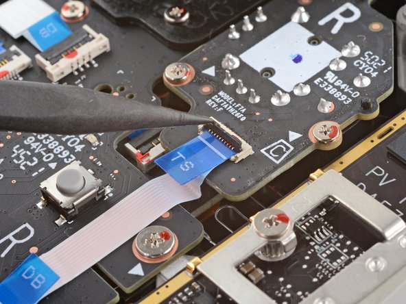

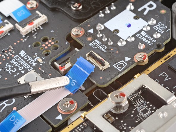

    1. Steam Deck Right Thumbstick Replacement, Disconnect the right thumbstick cable: crwdns2935265:09crwdnd2935265:01crwdnd2935265:03crwdne2935265:0 Steam Deck Right Thumbstick Replacement, Disconnect the right thumbstick cable: crwdns2935265:09crwdnd2935265:02crwdnd2935265:03crwdne2935265:0 Steam Deck Right Thumbstick Replacement, Disconnect the right thumbstick cable: crwdns2935265:09crwdnd2935265:03crwdnd2935265:03crwdne2935265:0
      • The right thumbstick will be on your left-hand side when working on the Steam Deck, as it's laying upside down.
      • Use the pointed end of a spudger to lift up the small locking flap on the thumbstick cable's ZIF connector.
      • Use a pair of tweezers to slide the cable out of its connector.
      • Grip the cable by the blue pull tab, not by the cable itself.

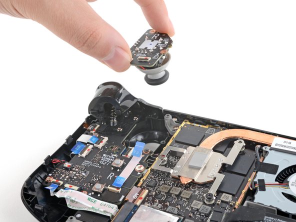

    2. Steam Deck Right Thumbstick Replacement, Remove the thumbstick screws: crwdns2935265:010crwdnd2935265:01crwdnd2935265:02crwdne2935265:0 Steam Deck Right Thumbstick Replacement, Remove the thumbstick screws: crwdns2935265:010crwdnd2935265:02crwdnd2935265:02crwdne2935265:0
      • Use a Phillips driver to remove the three 5.2 mm screws securing the thumbstick.
      • During reassembly, you may need to hold the Steam Deck off of the work surface so it isn't resting on the new thumbstick while you tighten down the screws.
    3. Steam Deck Right Thumbstick Replacement, Remove the thumbstick: crwdns2935265:011crwdnd2935265:01crwdnd2935265:02crwdne2935265:0 Steam Deck Right Thumbstick Replacement, Remove the thumbstick: crwdns2935265:011crwdnd2935265:02crwdnd2935265:02crwdne2935265:0
      • Remove the right thumbstick.
      • Replacement thumbsticks require calibration to work as expected. To calibrate new thumbsticks, follow this calibration guide.
      • Each Steam Deck ships with one of two different models of thumbsticks, Type A or Type B. Although nearly identical, capacitive touch capability relies on the correct type to be installed.
      • To identify which replacement thumbsticks you need, navigate to SettingsSystem and check the Steam Deck Controller ID.
      • If the Controller ID starts with "MEDA" that device needs Type A thumbsticks.
      • If the Controller ID starts with "MHDA" that device needs Type B thumbsticks.
