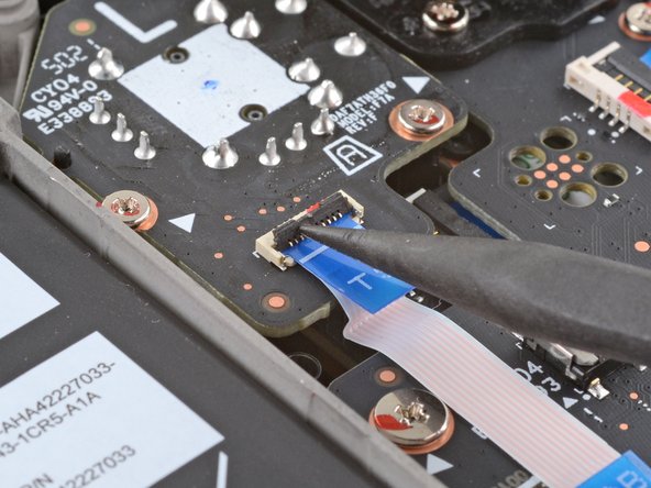

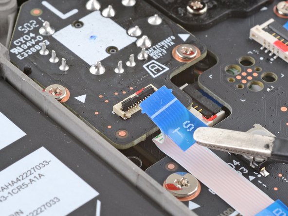

  9. Steam Deck Left Thumbstick Replacement, Disconnect the left thumbstick cable: crwdns2935265:09crwdnd2935265:01crwdnd2935265:03crwdne2935265:0 Steam Deck Left Thumbstick Replacement, Disconnect the left thumbstick cable: crwdns2935265:09crwdnd2935265:02crwdnd2935265:03crwdne2935265:0 Steam Deck Left Thumbstick Replacement, Disconnect the left thumbstick cable: crwdns2935265:09crwdnd2935265:03crwdnd2935265:03crwdne2935265:0
    • The left thumbstick will be on your right-hand side when working on the Steam Deck, as it's laying upside down.
    • Use the pointed end of a spudger to lift up the small locking flap on the thumbstick cable's ZIF connector.
    • Use a pair of tweezers to slide the cable out of its connector.
    • Grip the cable by the blue pull tab, not by the cable itself.

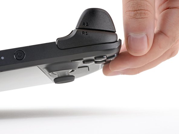

  10. Steam Deck Left Thumbstick Replacement, Remove the thumbstick screws: crwdns2935265:010crwdnd2935265:01crwdnd2935265:02crwdne2935265:0 Steam Deck Left Thumbstick Replacement, Remove the thumbstick screws: crwdns2935265:010crwdnd2935265:02crwdnd2935265:02crwdne2935265:0
    • Use a Phillips driver to remove the three 5.2 mm screws securing the thumbstick.
    • During reassembly, you may need to hold the Steam Deck off of the work surface so it isn't resting on the new thumbstick while you tighten down the screws.
