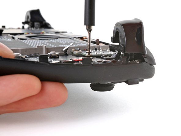

    • Use a T6 Torx driver to remove the eight 5.8 mm‑long screws securing the back cover.

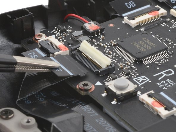

  10. Steam Deck OLED Left Thumbstick Replacement, Reassembly instructions: crwdns2935265:010crwdnd2935265:01crwdnd2935265:03crwdne2935265:0 Steam Deck OLED Left Thumbstick Replacement, Reassembly instructions: crwdns2935265:010crwdnd2935265:02crwdnd2935265:03crwdne2935265:0 Steam Deck OLED Left Thumbstick Replacement, Reassembly instructions: crwdns2935265:010crwdnd2935265:03crwdnd2935265:03crwdne2935265:0
    • During reassembly, follow this step and the above four steps to reconnect the battery.

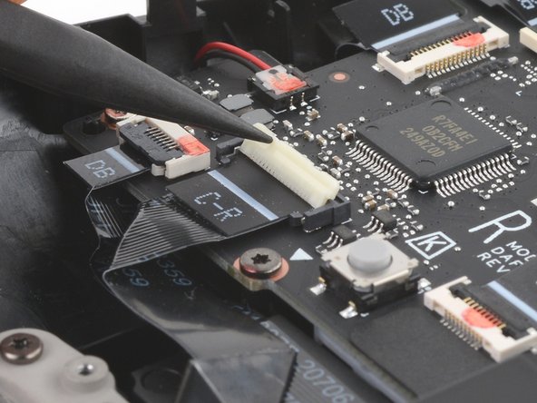

    • In this reassembly step, you'll disconnect the interconnect cable to free the motherboard shield.
    • Use a spudger to flip up the small white locking flap on the right button board interconnect cable ZIF connector.
    • Use tweezers or your fingers to grip the cable's pull tab and slide it straight out of its socket to disconnect it.
    • The pull tab may be labelled C‑R.

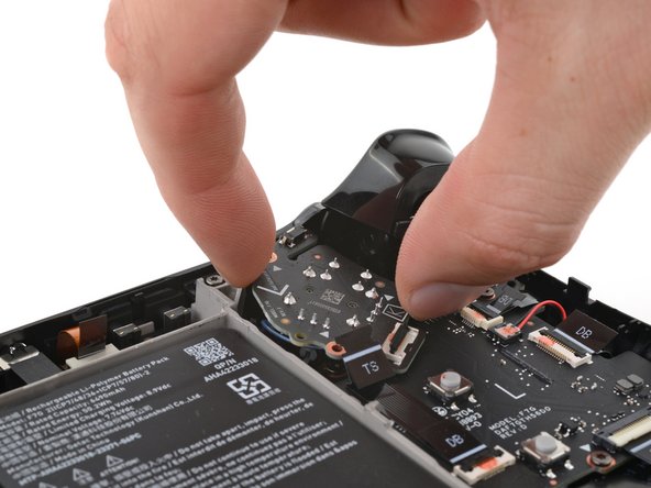

  11. Steam Deck OLED Left Thumbstick Replacement, Disconnect the left thumbstick: crwdns2935265:011crwdnd2935265:01crwdnd2935265:03crwdne2935265:0 Steam Deck OLED Left Thumbstick Replacement, Disconnect the left thumbstick: crwdns2935265:011crwdnd2935265:02crwdnd2935265:03crwdne2935265:0 Steam Deck OLED Left Thumbstick Replacement, Disconnect the left thumbstick: crwdns2935265:011crwdnd2935265:03crwdnd2935265:03crwdne2935265:0
    • Use the point of a spudger to flip up the small locking flap on the left thumbstick ZIF connector.
    • The pull tab on this connector may be labeled TS.
    • Use tweezers or your fingers to grip the cable's pull tab and slide the connector straight out of its socket to disconnect it.
  12. Steam Deck OLED Left Thumbstick Replacement, Remove the left thumbstick screws: crwdns2935265:012crwdnd2935265:01crwdnd2935265:02crwdne2935265:0 Steam Deck OLED Left Thumbstick Replacement, Remove the left thumbstick screws: crwdns2935265:012crwdnd2935265:02crwdnd2935265:02crwdne2935265:0
    • Use your T6 Torx driver to remove the three 5.9 mm‑long screws securing the left thumbstick.
    • During reassembly, hold the Steam Deck OLED off your work surface so it doesn't rest on your thumbstick as you tighten the screws.

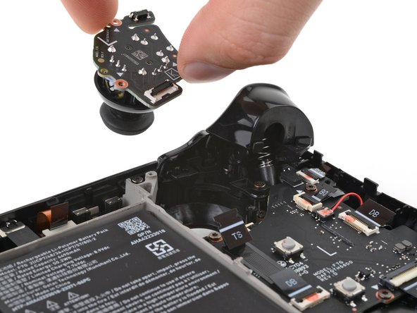

  13. Steam Deck OLED Left Thumbstick Replacement, Remove the left thumbstick: crwdns2935265:013crwdnd2935265:01crwdnd2935265:03crwdne2935265:0 Steam Deck OLED Left Thumbstick Replacement, Remove the left thumbstick: crwdns2935265:013crwdnd2935265:02crwdnd2935265:03crwdne2935265:0 Steam Deck OLED Left Thumbstick Replacement, Remove the left thumbstick: crwdns2935265:013crwdnd2935265:03crwdnd2935265:03crwdne2935265:0
    • Grip the edges of the thumbstick board and rotate it counterclockwise to clear the trigger.
    • Remove the thumbstick.
