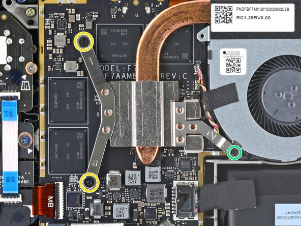

    1. Steam Deck Motherboard Replacement, Remove the heatsink screws: crwdns2935265:012crwdnd2935265:01crwdnd2935265:02crwdne2935265:0 Steam Deck Motherboard Replacement, Remove the heatsink screws: crwdns2935265:012crwdnd2935265:02crwdnd2935265:02crwdne2935265:0
      • For original Steam Decks: Use a Phillips driver to loosen and remove the two screws securing the heatsink to the motherboard:
      • One captive 3.5 mm screw
      • One 3.4 mm screw
      • No, your eyes don't deceive you! The third heatsink screw was removed earlier in the disassembly: it doubles as the hidden board shield screw.
      • For refreshed Steam Decks: Use a Phillips driver to remove the three screws securing the heatsink to the motherboard:
      • Two 2.9 mm screws
      • One 3.7 mm screw
      • During reassembly on both versions, tighten these screws in order (1, 2, 3) as stamped into the heatsink.
    2. Steam Deck Motherboard Replacement, Remove the heatsink: crwdns2935265:013crwdnd2935265:01crwdnd2935265:03crwdne2935265:0 Steam Deck Motherboard Replacement, Remove the heatsink: crwdns2935265:013crwdnd2935265:02crwdnd2935265:03crwdne2935265:0 Steam Deck Motherboard Replacement, Remove the heatsink: crwdns2935265:013crwdnd2935265:03crwdnd2935265:03crwdne2935265:0
      • Lift and remove the heatsink.
      • Before reinstalling the heatsink, follow this guide to clean the heatsink and APU and reapply thermal paste.

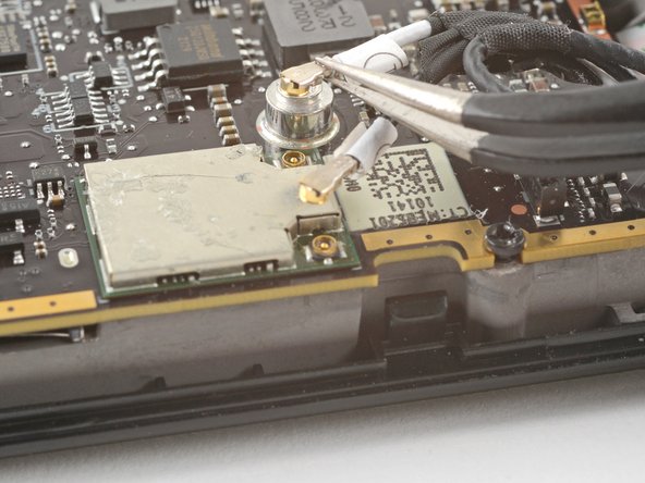

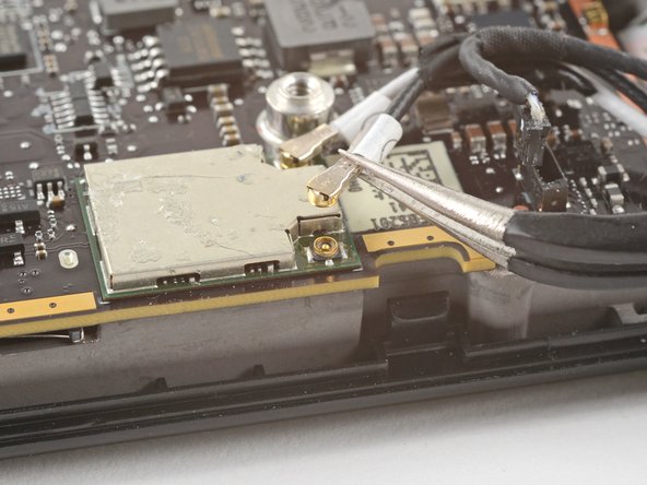

    4. Steam Deck Motherboard Replacement, Disconnect the Wi-Fi: crwdns2935265:017crwdnd2935265:01crwdnd2935265:03crwdne2935265:0 Steam Deck Motherboard Replacement, Disconnect the Wi-Fi: crwdns2935265:017crwdnd2935265:02crwdnd2935265:03crwdne2935265:0 Steam Deck Motherboard Replacement, Disconnect the Wi-Fi: crwdns2935265:017crwdnd2935265:03crwdnd2935265:03crwdne2935265:0
      • The Wi-Fi module is located next to the SSD on refreshed Steam Decks.
      • Use a pair of tweezers to grip the antenna connector close to its base.
      • Pull straight up to disconnect the cable.
      • Repeat for the second antenna cable.
      • During reassembly, ensure that both antenna cables are reconnected at their appropriate connectors. The labels on the cables match the markings on the Wi-Fi module.
      • To reconnect each cable, align the connector directly over its socket, and then press down so it snaps into place.

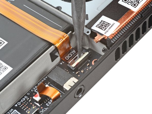

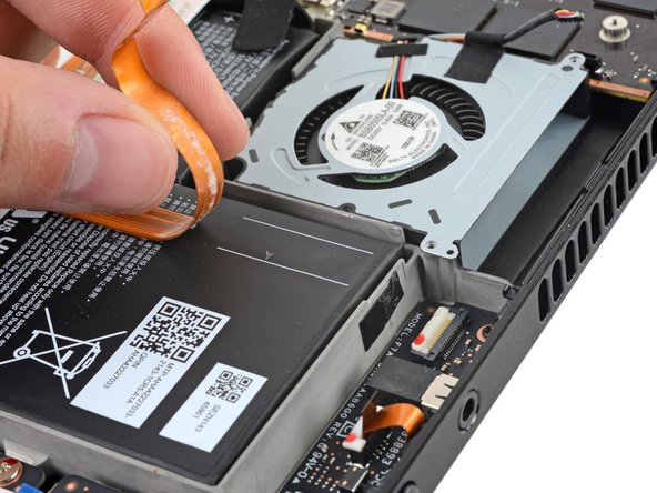

    6. Steam Deck Motherboard Replacement, Disconnect the audio cable: crwdns2935265:019crwdnd2935265:01crwdnd2935265:02crwdne2935265:0 Steam Deck Motherboard Replacement, Disconnect the audio cable: crwdns2935265:019crwdnd2935265:02crwdnd2935265:02crwdne2935265:0
      • Refreshed Steam Decks don't have this audio cable. If you have a refreshed version, skip the next three steps.
      • Use the pointed end of a spudger to lift up the small locking flap on the audio cable's ZIF connector.
    7. Steam Deck Motherboard Replacement: crwdns2935265:020crwdnd2935265:01crwdnd2935265:02crwdne2935265:0 Steam Deck Motherboard Replacement: crwdns2935265:020crwdnd2935265:02crwdnd2935265:02crwdne2935265:0
      • Use a pair of tweezers to slide the cable out of its connector.
      • Grip the cable by its pull tab, not by the cable itself.
    8. Steam Deck Motherboard Replacement: crwdns2935265:021crwdnd2935265:01crwdnd2935265:03crwdne2935265:0 Steam Deck Motherboard Replacement: crwdns2935265:021crwdnd2935265:02crwdnd2935265:03crwdne2935265:0 Steam Deck Motherboard Replacement: crwdns2935265:021crwdnd2935265:03crwdnd2935265:03crwdne2935265:0
      • Carefully peel the audio cable off of the battery.
      • The audio cable is secured to the battery with some light adhesive.
      • If the adhesive is stubborn, don't force the cable. Lightly heat the audio cable using an iOpener or a hair dryer to soften the adhesive.

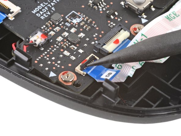

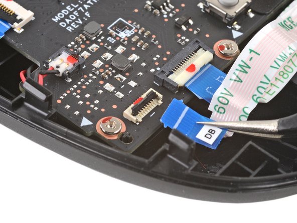

    9. Steam Deck Motherboard Replacement, Disconnect the button board: crwdns2935265:022crwdnd2935265:01crwdnd2935265:03crwdne2935265:0 Steam Deck Motherboard Replacement, Disconnect the button board: crwdns2935265:022crwdnd2935265:02crwdnd2935265:03crwdne2935265:0 Steam Deck Motherboard Replacement, Disconnect the button board: crwdns2935265:022crwdnd2935265:03crwdnd2935265:03crwdne2935265:0
      • Use the pointed end of a spudger to lift up the small locking flap on the button board cable's ZIF connector.
      • Grip the cable by the blue pull tab, not by the cable itself.
