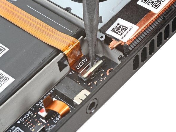

    1. Steam Deck Battery Replacement, Disconnect the audio cable: crwdns2935265:09crwdnd2935265:01crwdnd2935265:02crwdne2935265:0 Steam Deck Battery Replacement, Disconnect the audio cable: crwdns2935265:09crwdnd2935265:02crwdnd2935265:02crwdne2935265:0
      • Use the pointed end of a spudger to lift up the small locking flap on the audio cable's ZIF connector.
    2. Steam Deck Battery Replacement: crwdns2935265:010crwdnd2935265:01crwdnd2935265:02crwdne2935265:0 Steam Deck Battery Replacement: crwdns2935265:010crwdnd2935265:02crwdnd2935265:02crwdne2935265:0

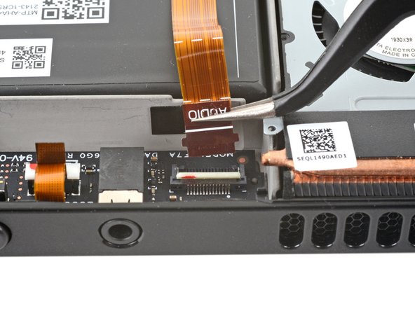

      • Use a pair of tweezers to slide the cable out of its connector.
      • Grip the cable by its pull tab, not by the cable itself.

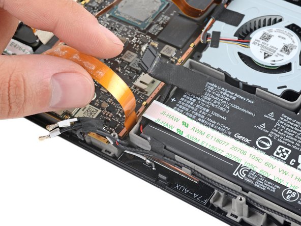

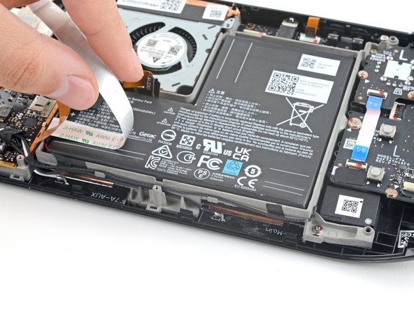

    3. Steam Deck Battery Replacement, Peel back the audio cable: crwdns2935265:011crwdnd2935265:01crwdnd2935265:03crwdne2935265:0 Steam Deck Battery Replacement, Peel back the audio cable: crwdns2935265:011crwdnd2935265:02crwdnd2935265:03crwdne2935265:0 Steam Deck Battery Replacement, Peel back the audio cable: crwdns2935265:011crwdnd2935265:03crwdnd2935265:03crwdne2935265:0
      • Carefully peel the audio cable off of the battery.
      • The audio cable is secured to the battery with some light adhesive.
      • If the adhesive is stubborn, don't force the cable. Lightly heat the audio cable using an iOpener or a hair dryer to soften the adhesive.

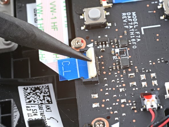

    4. Steam Deck Battery Replacement, Disconnect the button board cable: crwdns2935265:012crwdnd2935265:01crwdnd2935265:03crwdne2935265:0 Steam Deck Battery Replacement, Disconnect the button board cable: crwdns2935265:012crwdnd2935265:02crwdnd2935265:03crwdne2935265:0 Steam Deck Battery Replacement, Disconnect the button board cable: crwdns2935265:012crwdnd2935265:03crwdnd2935265:03crwdne2935265:0
      • Use the pointed end of a spudger to lift up the small locking flap on the button board cable's ZIF connector.
      • Grip the cable by the blue pull tab, not by the cable itself.

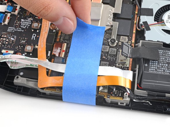

    5. Steam Deck Battery Replacement, Peel back the button board cable: crwdns2935265:013crwdnd2935265:01crwdnd2935265:03crwdne2935265:0 Steam Deck Battery Replacement, Peel back the button board cable: crwdns2935265:013crwdnd2935265:02crwdnd2935265:03crwdne2935265:0 Steam Deck Battery Replacement, Peel back the button board cable: crwdns2935265:013crwdnd2935265:03crwdnd2935265:03crwdne2935265:0
      • Carefully peel the button board cable off of the battery.
      • The button board cable is secured to the battery with some light adhesive.
      • If the adhesive is stubborn, don't force the cable. Lightly heat the button board cable using an iOpener or a hair dryer to soften the adhesive.
      • You may want to tape the audio and button board cables out of the way as you remove the battery.

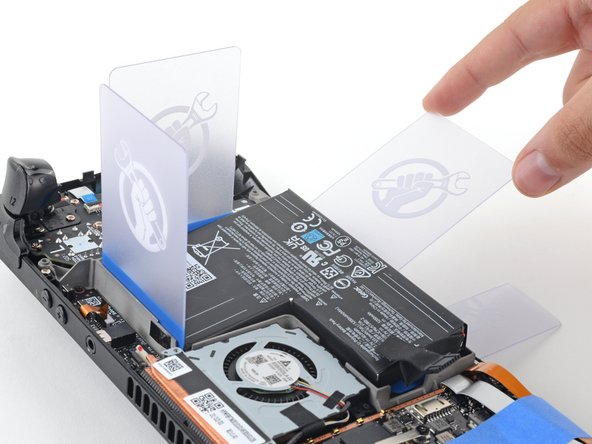

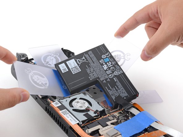

    8. Steam Deck Battery Replacement, Begin to pry up the battery: crwdns2935265:016crwdnd2935265:01crwdnd2935265:03crwdne2935265:0 Steam Deck Battery Replacement, Begin to pry up the battery: crwdns2935265:016crwdnd2935265:02crwdnd2935265:03crwdne2935265:0 Steam Deck Battery Replacement, Begin to pry up the battery: crwdns2935265:016crwdnd2935265:03crwdnd2935265:03crwdne2935265:0
      • Insert an uncut plastic card between the top edge of the battery and the frame.
      • Insert a second plastic card between the right edge of the battery and the frame.
      • Don't use excessive force or pry at the battery with metal tools.
      • Try your best not to deform the battery during this process. Soft-shell lithium-polymer batteries can leak dangerous chemicals, catch fire, or even explode if damaged.
      • The battery most likely won't budge at this step, but these cards will be helpful as leverage as you continue.

    12. Steam Deck Battery Replacement, Pry out the battery: crwdns2935265:020crwdnd2935265:01crwdnd2935265:03crwdne2935265:0 Steam Deck Battery Replacement, Pry out the battery: crwdns2935265:020crwdnd2935265:02crwdnd2935265:03crwdne2935265:0 Steam Deck Battery Replacement, Pry out the battery: crwdns2935265:020crwdnd2935265:03crwdnd2935265:03crwdne2935265:0
      • Insert a plastic card along the bottom edge of the battery to pry the battery away from the frame.
      • Lift the battery up, away from the Steam Deck to fully separate it from all adhesive.
      • Don't use excessive force—try your best not to deform the battery during this process.
      • If you're having trouble, repeat the heating and prying process around all edges until the battery becomes loose.
