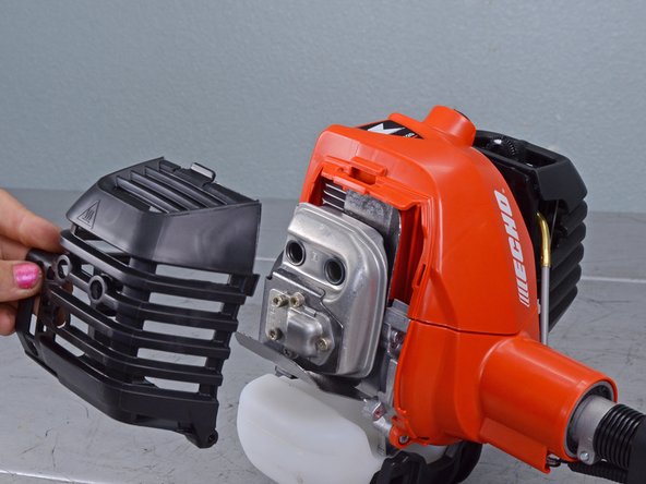

  2. Spark Test, Remove the muffler cover: crwdns2935265:02crwdnd2935265:01crwdnd2935265:02crwdne2935265:0 Spark Test, Remove the muffler cover: crwdns2935265:02crwdnd2935265:02crwdnd2935265:02crwdne2935265:0
    • Use a T27 Torx screwdriver to remove the two screws securing the bottom of the muffler cover to the motor.

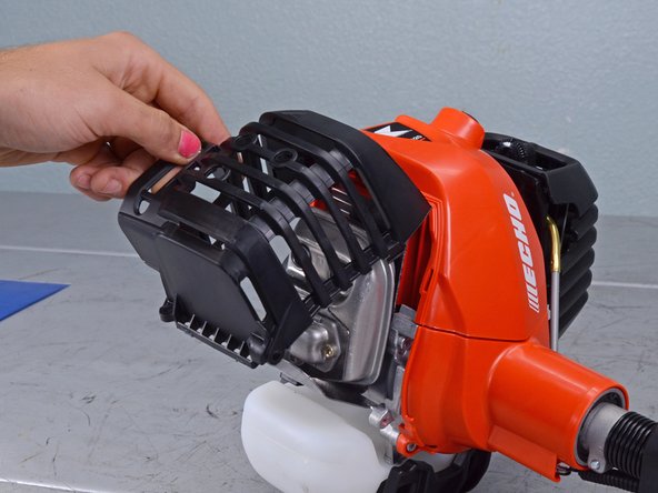

  3. Spark Test: crwdns2935265:03crwdnd2935265:01crwdnd2935265:03crwdne2935265:0 Spark Test: crwdns2935265:03crwdnd2935265:02crwdnd2935265:03crwdne2935265:0 Spark Test: crwdns2935265:03crwdnd2935265:03crwdnd2935265:03crwdne2935265:0
    • Tilt the muffler cover up, hinging along the top edge, until it can be removed from the motor cover.
    • Remove the muffler cover.

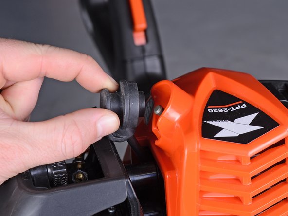

  4. Spark Test: crwdns2935265:04crwdnd2935265:01crwdnd2935265:02crwdne2935265:0 Spark Test: crwdns2935265:04crwdnd2935265:02crwdnd2935265:02crwdne2935265:0
    • Pull the spark plug boot straight off of the spark plug.

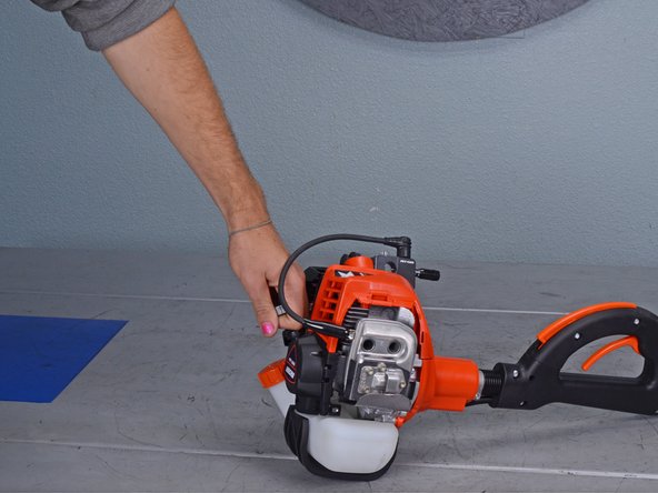

  5. Spark Test, Connect the spark tester: crwdns2935265:05crwdnd2935265:01crwdnd2935265:02crwdne2935265:0 Spark Test, Connect the spark tester: crwdns2935265:05crwdnd2935265:02crwdnd2935265:02crwdne2935265:0
    • Connect the spark plug boot to the left terminal of the ignition checker.
  6. Spark Test: crwdns2935265:06crwdnd2935265:01crwdnd2935265:01crwdne2935265:0
    • Connect the ignition checker alligator clip to a metal surface on the motor to ground the accessory cord.
  7. Spark Test: crwdns2935265:07crwdnd2935265:01crwdnd2935265:01crwdne2935265:0
    • Set the spark gap to 6 mm by turning the spark gap adjustment knob counterclockwise.
    • Do not set the spark gap unnecessarily wide—a high voltage may damage the ignition coil.

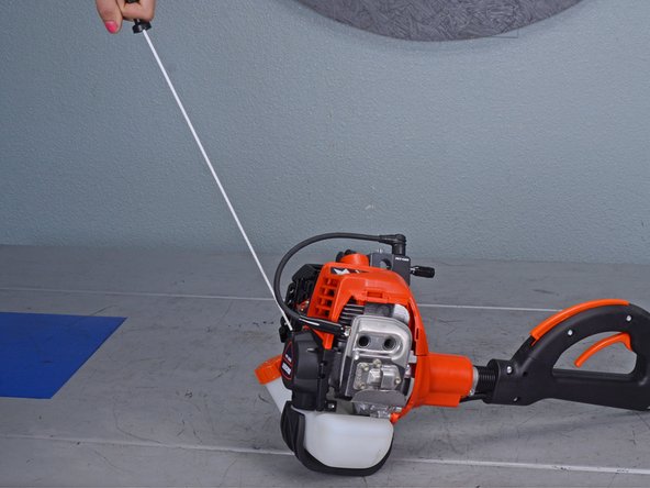

  8. Spark Test: crwdns2935265:08crwdnd2935265:01crwdnd2935265:01crwdne2935265:0
    • Flip the power switch into the ON position.
  9. Spark Test: crwdns2935265:09crwdnd2935265:01crwdnd2935265:03crwdne2935265:0 Spark Test: crwdns2935265:09crwdnd2935265:02crwdnd2935265:03crwdne2935265:0 Spark Test: crwdns2935265:09crwdnd2935265:03crwdnd2935265:03crwdne2935265:0
    • Hold the spark tester by the handle on the bottom. Do not touch the terminals or spark window while the test is being conducted.
    • Watch for a spark in the spark window while a second person pulls the starter to crank the engine.
    • Consult the ignition checker instruction manual to troubleshoot the device.
