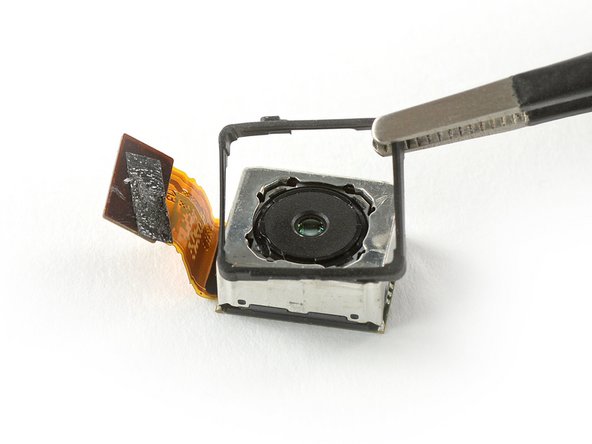

    • Use a spudger to pry up and disconnect the rear camera flex cable.
  6. Sony Xperia Z5 Rear Camera Replacement: crwdns2935265:06crwdnd2935265:01crwdnd2935265:03crwdne2935265:0 Sony Xperia Z5 Rear Camera Replacement: crwdns2935265:06crwdnd2935265:02crwdnd2935265:03crwdne2935265:0 Sony Xperia Z5 Rear Camera Replacement: crwdns2935265:06crwdnd2935265:03crwdnd2935265:03crwdne2935265:0
    • Remove the rear camera with a pair of tweezers.
    • Compare your new replacement part to the original part — you may need to transfer a rubber gasket to your new part before installing.
