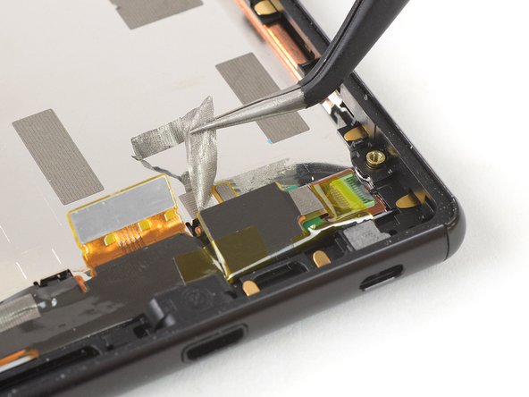

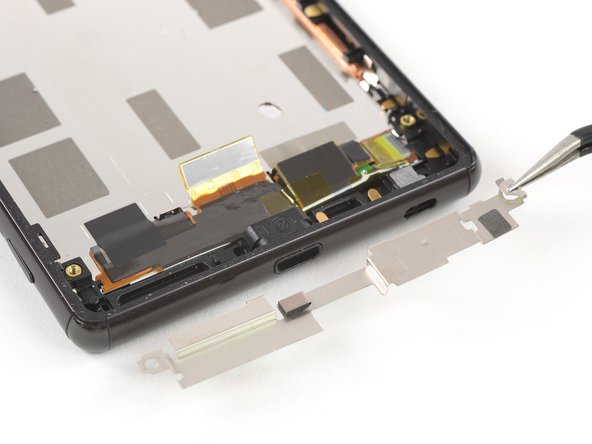

  38. Sony Xperia Z4 LCD & Digitizer Replacement: crwdns2935265:038crwdnd2935265:01crwdnd2935265:02crwdne2935265:0 Sony Xperia Z4 LCD & Digitizer Replacement: crwdns2935265:038crwdnd2935265:02crwdnd2935265:02crwdne2935265:0
    • Use a pair of tweezers to unhook the metal shield on top of the display cable assembly and remove .

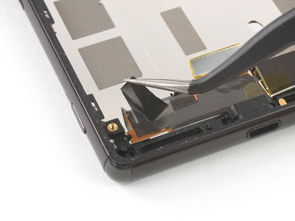

  39. Sony Xperia Z4 LCD & Digitizer Replacement: crwdns2935265:039crwdnd2935265:01crwdnd2935265:03crwdne2935265:0 Sony Xperia Z4 LCD & Digitizer Replacement: crwdns2935265:039crwdnd2935265:02crwdnd2935265:03crwdne2935265:0 Sony Xperia Z4 LCD & Digitizer Replacement: crwdns2935265:039crwdnd2935265:03crwdnd2935265:03crwdne2935265:0
    • Use a pair of tweezers to peel off the black adhesive on the left side of the display cable assembly.
    • Also remove the silver adhesive strip on the right side of the display cable assembly.

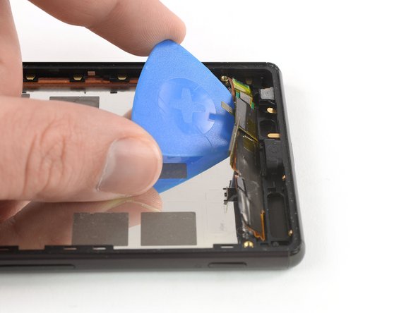

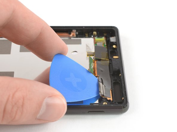

  40. Sony Xperia Z4 LCD & Digitizer Replacement: crwdns2935265:040crwdnd2935265:01crwdnd2935265:03crwdne2935265:0 Sony Xperia Z4 LCD & Digitizer Replacement: crwdns2935265:040crwdnd2935265:02crwdnd2935265:03crwdne2935265:0 Sony Xperia Z4 LCD & Digitizer Replacement: crwdns2935265:040crwdnd2935265:03crwdnd2935265:03crwdne2935265:0

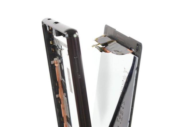

    • Get an opening pick under the left side of the display cable assembly.
    • Use the opening pick to pry up the display cable assembly.
    • Carefully slide the opening pick from left to right to separate the display cable assembly from the midframe.

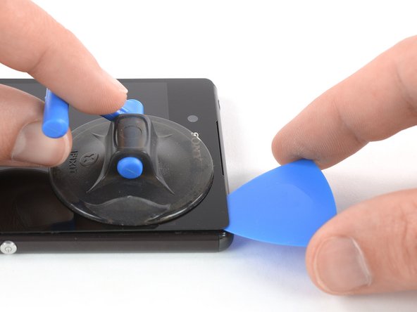

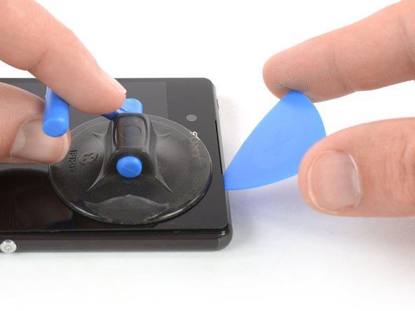

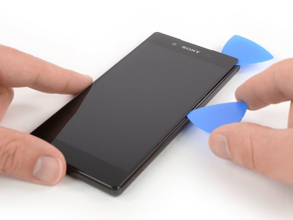

  42. Sony Xperia Z4 LCD & Digitizer Replacement: crwdns2935265:042crwdnd2935265:01crwdnd2935265:03crwdne2935265:0 Sony Xperia Z4 LCD & Digitizer Replacement: crwdns2935265:042crwdnd2935265:02crwdnd2935265:03crwdne2935265:0 Sony Xperia Z4 LCD & Digitizer Replacement: crwdns2935265:042crwdnd2935265:03crwdnd2935265:03crwdne2935265:0
    • Apply a suction handle near the top edge of the phone right under the earpiece speaker.
    • If the phone's screen is cracked, the suction handle may not stick. Try lifting it with strong tape, or superglue the suction handle in place and allow it to cure so you can proceed.
    • Use the suction handle to pull up the screen and insert just the tip of an opening pick under the right edge of the speaker recess.
    • Slide the opening pick to the top right corner to loosen the adhesive.
    • Leave the opening pick in its position to prevent the adhesive from resealing.

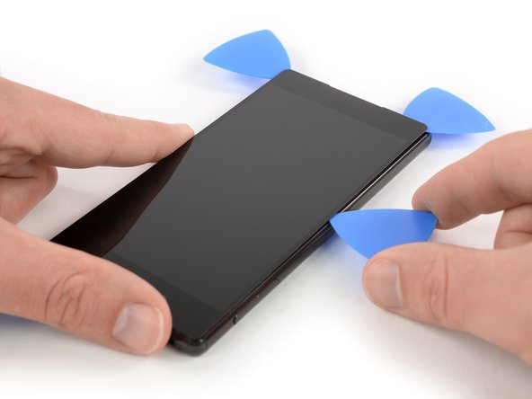

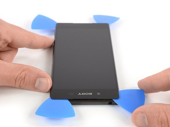

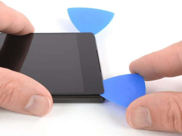

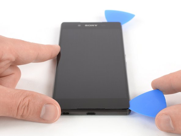

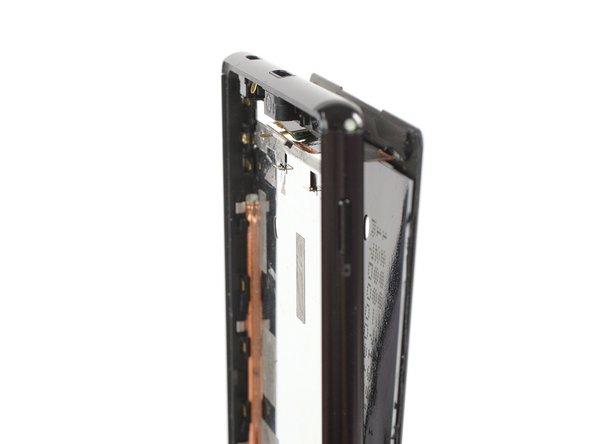

  43. Sony Xperia Z4 LCD & Digitizer Replacement: crwdns2935265:043crwdnd2935265:01crwdnd2935265:03crwdne2935265:0 Sony Xperia Z4 LCD & Digitizer Replacement: crwdns2935265:043crwdnd2935265:02crwdnd2935265:03crwdne2935265:0 Sony Xperia Z4 LCD & Digitizer Replacement: crwdns2935265:043crwdnd2935265:03crwdnd2935265:03crwdne2935265:0
    • Insert a second opening pick at the top right corner of the screen.
    • Slide the opening pick along the midframe to loosen the adhesive under the right edge of the screen.
    • Leave the opening pick in the bottom right corner to prevent the adhesive from resealing.
  44. Sony Xperia Z4 LCD & Digitizer Replacement: crwdns2935265:044crwdnd2935265:01crwdnd2935265:02crwdne2935265:0 Sony Xperia Z4 LCD & Digitizer Replacement: crwdns2935265:044crwdnd2935265:02crwdnd2935265:02crwdne2935265:0
    • Apply more heat if the adhesive becomes hard to cut.
    • Insert a third opening pick under the bottom right edge of the screen.
    • Slide the opening pick to the bottom left corner to loosen the adhesive underneath the screen.
    • Leave the opening pick in the bottom left corner to prevent the adhesive from resealing.
  45. Sony Xperia Z4 LCD & Digitizer Replacement: crwdns2935265:045crwdnd2935265:01crwdnd2935265:03crwdne2935265:0 Sony Xperia Z4 LCD & Digitizer Replacement: crwdns2935265:045crwdnd2935265:02crwdnd2935265:03crwdne2935265:0 Sony Xperia Z4 LCD & Digitizer Replacement: crwdns2935265:045crwdnd2935265:03crwdnd2935265:03crwdne2935265:0
    • Insert a fourth opening pick under the bottom left edge of the screen.
    • Slide the opening pick along the midframe to loosen the adhesive under the left side of the screen.
    • Slide the opening pick around the top left corner of the screen to loosen the remaining adhesive.
    • Try not to remove the display all the way yet. The display flex cable is still threaded through the midframe.
  46. Sony Xperia Z4 LCD & Digitizer Replacement: crwdns2935265:046crwdnd2935265:01crwdnd2935265:03crwdne2935265:0 Sony Xperia Z4 LCD & Digitizer Replacement: crwdns2935265:046crwdnd2935265:02crwdnd2935265:03crwdne2935265:0 Sony Xperia Z4 LCD & Digitizer Replacement: crwdns2935265:046crwdnd2935265:03crwdnd2935265:03crwdne2935265:0
    • Slowly separate the screen from the frame and cut any remaining adhesive. Make sure the flex cable is no longer stuck to the frame and carefully thread it through its gap.
    • Remove the screen.
  47. Sony Xperia Z4 LCD & Digitizer Replacement: crwdns2935265:047crwdnd2935265:01crwdnd2935265:01crwdne2935265:0
    • Remove any remaining adhesive from the midframe, and clean the glued areas with isopropyl alcohol and a lint-free cloth before installing a new screen.
The best way to secure the new screen is with a sheet of custom-cut double-sided tape. Apply the tape to the back of the screen, then carefully feed the display cable through the frame. Align the screen and press it into place.
If possible, turn on your phone and test your repair before installing new adhesive and resealing the phone.
