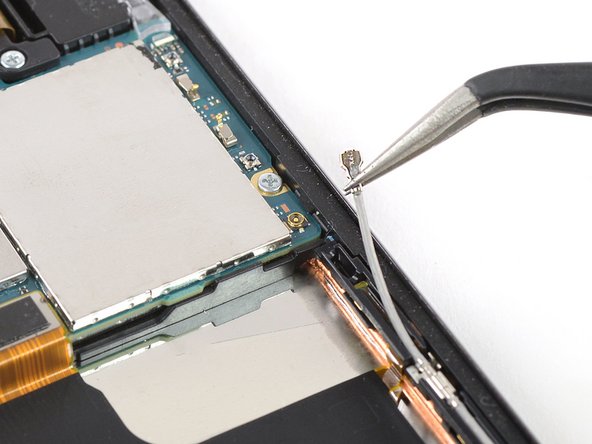

    • Use a pair of tweezers to pry up and disconnect the antenna cable.

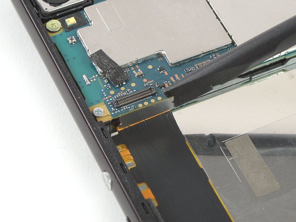

    • Use the flat end of a spudger to pry up and disconnect the main flex cable connector.

    • Use a pair of tweezers to pry up and disconnect the upper connector of the antenna cable.

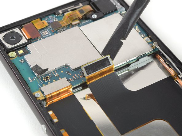

    • Use a spudger to pry up and disconnect the main flex cable from the motherboard.

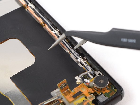

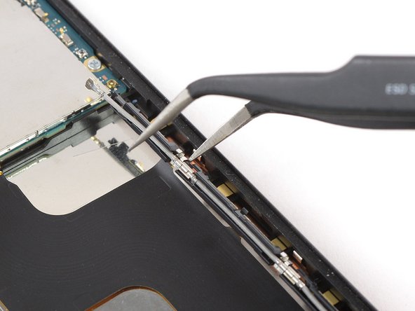

  25. Sony Xperia Z4 Flex Cable Assemblies and Loudspeaker Replacement: crwdns2935265:025crwdnd2935265:01crwdnd2935265:03crwdne2935265:0 Sony Xperia Z4 Flex Cable Assemblies and Loudspeaker Replacement: crwdns2935265:025crwdnd2935265:02crwdnd2935265:03crwdne2935265:0 Sony Xperia Z4 Flex Cable Assemblies and Loudspeaker Replacement: crwdns2935265:025crwdnd2935265:03crwdnd2935265:03crwdne2935265:0
    • Insert one arm of the tweezer into the gaps between antenna cable routing and midframe.
    • Loosen the clips along the antenna cable on the right side of the midframe by gently twisting the tweezers sideways until the cable routing pops out of the clips.

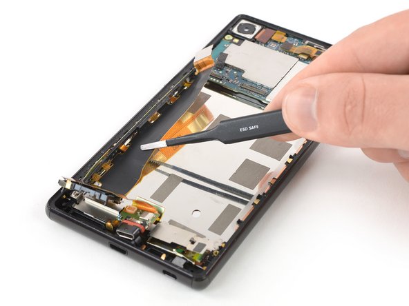

  26. Sony Xperia Z4 Flex Cable Assemblies and Loudspeaker Replacement: crwdns2935265:026crwdnd2935265:01crwdnd2935265:02crwdne2935265:0 Sony Xperia Z4 Flex Cable Assemblies and Loudspeaker Replacement: crwdns2935265:026crwdnd2935265:02crwdnd2935265:02crwdne2935265:0
    • Use a pair of tweezers to peel up the main flex cable and separate it from the midframe.
    • In case you're having trouble to separate the main flex cable from the mid frame you can place an iOpener onto the display to loosen the adhesive underneath the flex cable.

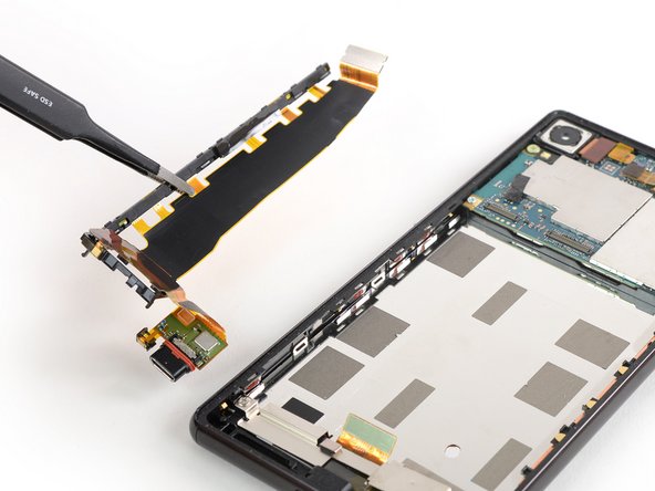

  27. Sony Xperia Z4 Flex Cable Assemblies and Loudspeaker Replacement: crwdns2935265:027crwdnd2935265:01crwdnd2935265:02crwdne2935265:0 Sony Xperia Z4 Flex Cable Assemblies and Loudspeaker Replacement: crwdns2935265:027crwdnd2935265:02crwdnd2935265:02crwdne2935265:0
    • Use a pair of tweezers to remove the main flex cable assembly including the vibration motor and the microphone.

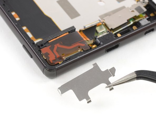

  28. Sony Xperia Z4 Flex Cable Assemblies and Loudspeaker Replacement, Loudspeaker: crwdns2935265:028crwdnd2935265:01crwdnd2935265:02crwdne2935265:0 Sony Xperia Z4 Flex Cable Assemblies and Loudspeaker Replacement, Loudspeaker: crwdns2935265:028crwdnd2935265:02crwdnd2935265:02crwdne2935265:0
    • Unhook and remove the metal shield above the loudspeaker cover located at the bottom left.

  33. Sony Xperia Z4 Flex Cable Assemblies and Loudspeaker Replacement, Sidebutton Flex Cable including Charging Port: crwdns2935265:033crwdnd2935265:01crwdnd2935265:02crwdne2935265:0 Sony Xperia Z4 Flex Cable Assemblies and Loudspeaker Replacement, Sidebutton Flex Cable including Charging Port: crwdns2935265:033crwdnd2935265:02crwdnd2935265:02crwdne2935265:0
    • Use a pair of blunt nose tweezers to grab the flex cable between the charging port and the loudspeaker cover.
    • Carefully pull the charging port out of its housing.
  34. Sony Xperia Z4 Flex Cable Assemblies and Loudspeaker Replacement: crwdns2935265:034crwdnd2935265:01crwdnd2935265:02crwdne2935265:0 Sony Xperia Z4 Flex Cable Assemblies and Loudspeaker Replacement: crwdns2935265:034crwdnd2935265:02crwdnd2935265:02crwdne2935265:0
    • Use a spudger to pry up and disconnect the side button flex cable on the left side of the motherboard.
  35. Sony Xperia Z4 Flex Cable Assemblies and Loudspeaker Replacement: crwdns2935265:035crwdnd2935265:01crwdnd2935265:03crwdne2935265:0 Sony Xperia Z4 Flex Cable Assemblies and Loudspeaker Replacement: crwdns2935265:035crwdnd2935265:02crwdnd2935265:03crwdne2935265:0 Sony Xperia Z4 Flex Cable Assemblies and Loudspeaker Replacement: crwdns2935265:035crwdnd2935265:03crwdnd2935265:03crwdne2935265:0
    • Use a pair of tweezers to loosen the plastic clips along the side button flex cable on the left side of the midframe.
  36. Sony Xperia Z4 Flex Cable Assemblies and Loudspeaker Replacement: crwdns2935265:036crwdnd2935265:01crwdnd2935265:03crwdne2935265:0 Sony Xperia Z4 Flex Cable Assemblies and Loudspeaker Replacement: crwdns2935265:036crwdnd2935265:02crwdnd2935265:03crwdne2935265:0 Sony Xperia Z4 Flex Cable Assemblies and Loudspeaker Replacement: crwdns2935265:036crwdnd2935265:03crwdnd2935265:03crwdne2935265:0
    • Peel up the side button flex cable and separate it from the midframe.
    • In case you're having trouble separating the side button flex cable from the midframe you can place an iOpener onto the display to loosen the adhesive underneath the flex cable.
    • Remove the side button flex cable including the loudspeaker cover and the charging port.
