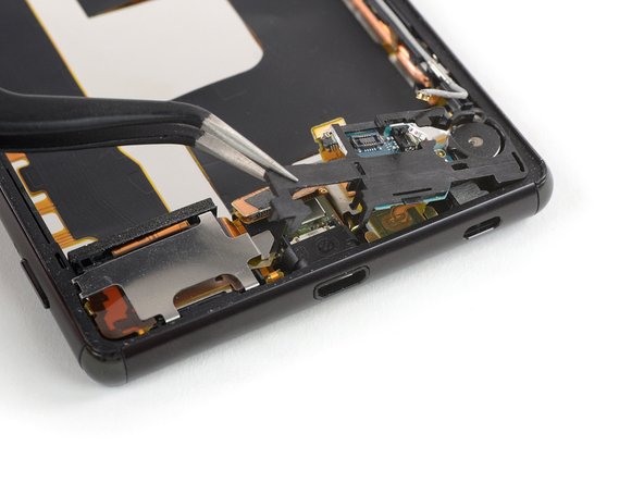

  15. Sony Xperia Z4 Daughterboard Replacement, Daughterboard with Cover: crwdns2935265:015crwdnd2935265:01crwdnd2935265:01crwdne2935265:0
    • Remove the Phillips #00 screw (3 mm length).

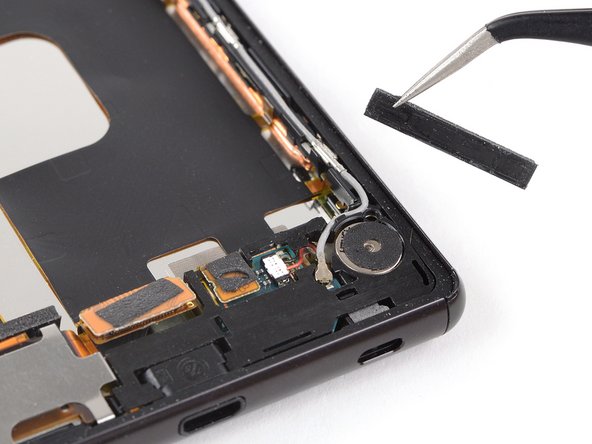

  16. Sony Xperia Z4 Daughterboard Replacement: crwdns2935265:016crwdnd2935265:01crwdnd2935265:02crwdne2935265:0 Sony Xperia Z4 Daughterboard Replacement: crwdns2935265:016crwdnd2935265:02crwdnd2935265:02crwdne2935265:0
    • Use a pair of tweezers to peel off and remove the foam pad on top of the daughterboard.

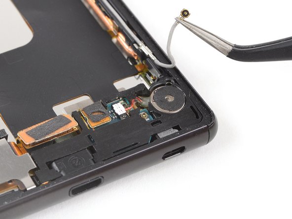

  17. Sony Xperia Z4 Daughterboard Replacement: crwdns2935265:017crwdnd2935265:01crwdnd2935265:02crwdne2935265:0 Sony Xperia Z4 Daughterboard Replacement: crwdns2935265:017crwdnd2935265:02crwdnd2935265:02crwdne2935265:0
    • Use a pair of tweezers to pry up and disconnect the antenna cable.

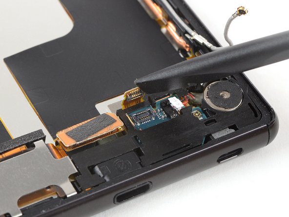

  18. Sony Xperia Z4 Daughterboard Replacement: crwdns2935265:018crwdnd2935265:01crwdnd2935265:02crwdne2935265:0 Sony Xperia Z4 Daughterboard Replacement: crwdns2935265:018crwdnd2935265:02crwdnd2935265:02crwdne2935265:0
    • Use a spudger to pry up and disconnect the vibration motor connector.
  19. Sony Xperia Z4 Daughterboard Replacement: crwdns2935265:019crwdnd2935265:01crwdnd2935265:02crwdne2935265:0 Sony Xperia Z4 Daughterboard Replacement: crwdns2935265:019crwdnd2935265:02crwdnd2935265:02crwdne2935265:0
    • Use the flat end of a spudger to pry up and disconnect the small main flex connector next to the vibration motor connector.
  20. Sony Xperia Z4 Daughterboard Replacement: crwdns2935265:020crwdnd2935265:01crwdnd2935265:03crwdne2935265:0 Sony Xperia Z4 Daughterboard Replacement: crwdns2935265:020crwdnd2935265:02crwdnd2935265:03crwdne2935265:0 Sony Xperia Z4 Daughterboard Replacement: crwdns2935265:020crwdnd2935265:03crwdnd2935265:03crwdne2935265:0
    • Lift the daughterboard cover using a pair of tweezers or a spudger by prying it up from its left side.
    • Remove the daughterboard cover carrying the daughterboard.
    • In case you only want to replace the daughterboard you can easily separate it from the plastic cover with an opening pick or a pair of tweezers.
