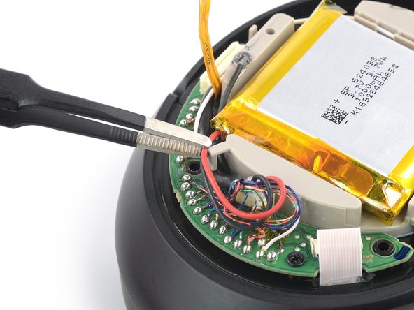

  11. Sony WH-1000XM3 Battery Replacement, Free the battery cables: crwdns2935265:011crwdnd2935265:01crwdnd2935265:02crwdne2935265:0 Sony WH-1000XM3 Battery Replacement, Free the battery cables: crwdns2935265:011crwdnd2935265:02crwdnd2935265:02crwdne2935265:0
    • The black and red battery cables are routed underneath a little plastic hook on the battery frame.
    • Use a pair of tweezers to carefully free the battery cables.
  12. Sony WH-1000XM3 Battery Replacement, Free the battery connector: crwdns2935265:012crwdnd2935265:01crwdnd2935265:02crwdne2935265:0 Sony WH-1000XM3 Battery Replacement, Free the battery connector: crwdns2935265:012crwdnd2935265:02crwdnd2935265:02crwdne2935265:0
    • Use the flat end of a spudger or an opening pick to carefully fold the cables blocking the battery connector to the side until you get free access to the connector.
