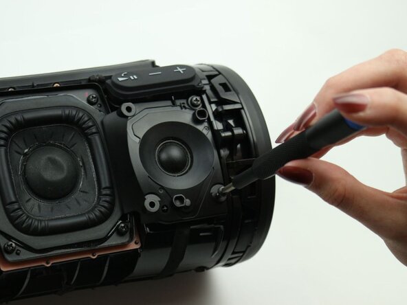

    • Remove the four 12 mm screws on the corners of the right tweeter using the Phillips #1 screwdriver.

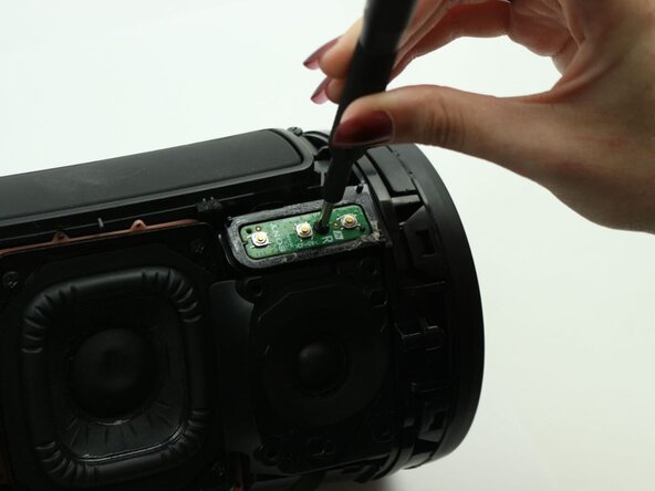

    • Remove the one 7.5 mm screw in the middle of the control panel using the Phillips #1 screwdriver.

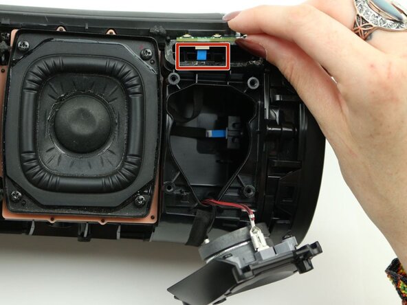

    • Use the metal spudger to carefully lift up the control panel.
    • Make sure to do this slowly and not lift it all the way up, as it can tear the cables.
    • Detach the blue ribbon cable from the button board.
    • If not visible, lift the right tweeter to see a better view of the cable internally.
    • Remove the button board from the speaker.
