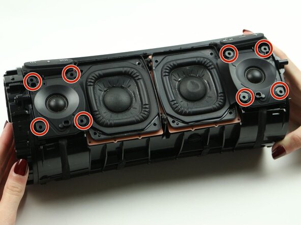

    • Remove the four 12 mm screws on the corners of each tweeter using the Phillips #1 screwdriver.
    • The tweeters are smaller compared to the two woofers in the center of the speaker.

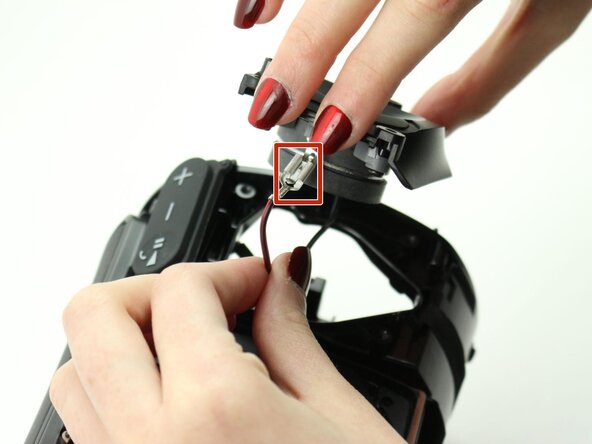

    • Disconnect the microphone by pulling on the white end of the microphone cable.

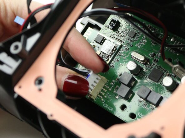

  12. Sony SRS-XG300 Battery Replacement, Battery: crwdns2935265:012crwdnd2935265:01crwdnd2935265:02crwdne2935265:0 Sony SRS-XG300 Battery Replacement, Battery: crwdns2935265:012crwdnd2935265:02crwdnd2935265:02crwdne2935265:0
    • Disconnect the second blue film cable on the left edge of the speaker’s motherboard.
    • If experiencing difficulties with this step, consider using angled tweezers.

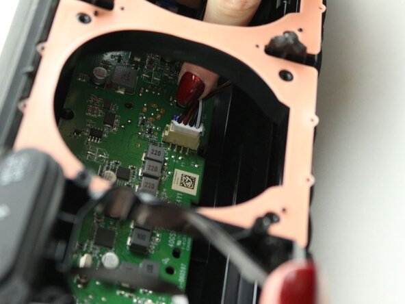

  13. Sony SRS-XG300 Battery Replacement: crwdns2935265:013crwdnd2935265:01crwdnd2935265:02crwdne2935265:0 Sony SRS-XG300 Battery Replacement: crwdns2935265:013crwdnd2935265:02crwdnd2935265:02crwdne2935265:0
    • Pull the white end of the left cable cluster to disconnect the set of cables from the motherboard.
    • Be careful to not pull directly on the wires as they are not as durable as the plastic ends.

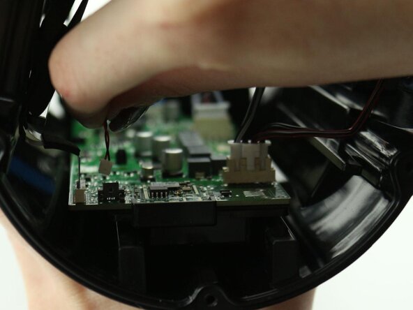

  14. Sony SRS-XG300 Battery Replacement: crwdns2935265:014crwdnd2935265:01crwdnd2935265:02crwdne2935265:0 Sony SRS-XG300 Battery Replacement: crwdns2935265:014crwdnd2935265:02crwdnd2935265:02crwdne2935265:0
    • Pull the white end of the right cable cluster to disconnect the set of cables from the motherboard.

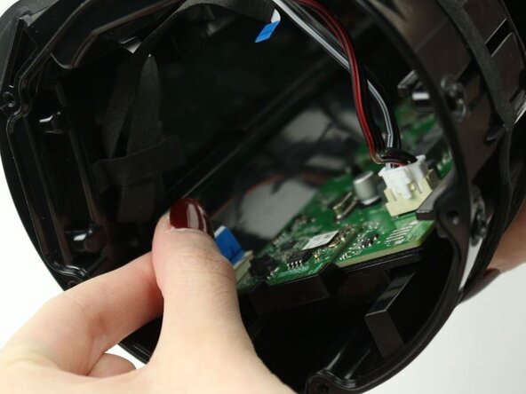

  16. Sony SRS-XG300 Battery Replacement: crwdns2935265:016crwdnd2935265:01crwdnd2935265:02crwdne2935265:0 Sony SRS-XG300 Battery Replacement: crwdns2935265:016crwdnd2935265:02crwdnd2935265:02crwdne2935265:0
    • Remove the two 12 mm screws at the bottom of the battery box using the Phillips #1 screwdriver.
  17. Sony SRS-XG300 Battery Replacement: crwdns2935265:017crwdnd2935265:01crwdnd2935265:02crwdne2935265:0 Sony SRS-XG300 Battery Replacement: crwdns2935265:017crwdnd2935265:02crwdnd2935265:02crwdne2935265:0

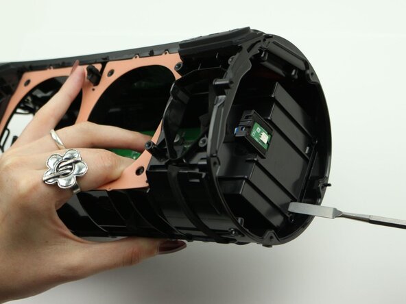

    • Use the metal spudger to push in the two bottom clips and release the entire motherboard and battery unit.
  18. Sony SRS-XG300 Battery Replacement: crwdns2935265:018crwdnd2935265:01crwdnd2935265:01crwdne2935265:0
    • Pull the motherboard out.
    • The motherboard should be easy to remove, so do not apply too much force during this step.

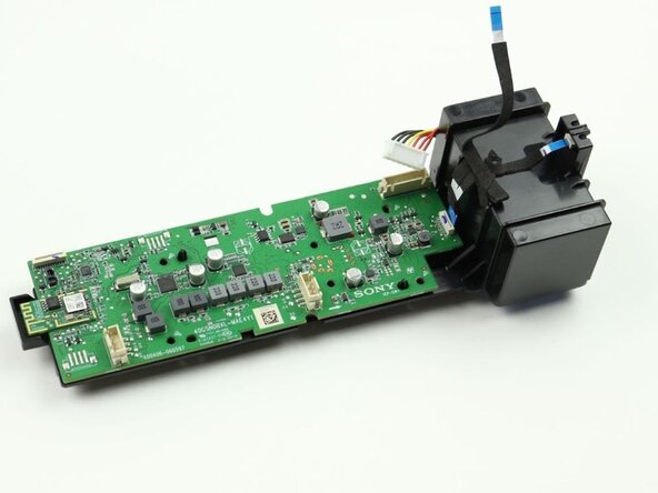

  19. Sony SRS-XG300 Battery Replacement: crwdns2935265:019crwdnd2935265:01crwdnd2935265:02crwdne2935265:0 Sony SRS-XG300 Battery Replacement: crwdns2935265:019crwdnd2935265:02crwdnd2935265:02crwdne2935265:0
    • Disconnect the battery cable plug at the top right of corner the motherboard.
    • Pull the white end of the plug to disconnect the battery.

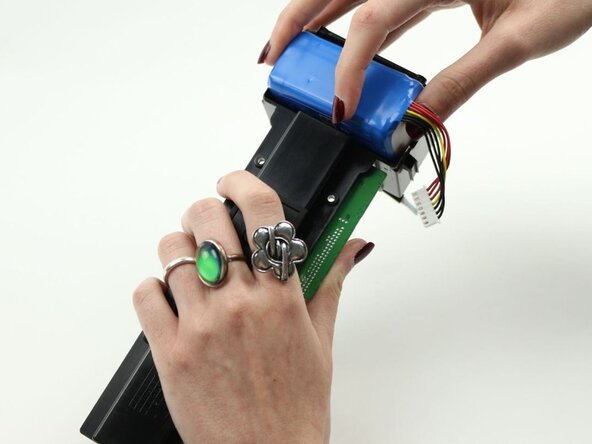

  20. Sony SRS-XG300 Battery Replacement: crwdns2935265:020crwdnd2935265:01crwdnd2935265:03crwdne2935265:0 Sony SRS-XG300 Battery Replacement: crwdns2935265:020crwdnd2935265:02crwdnd2935265:03crwdne2935265:0 Sony SRS-XG300 Battery Replacement: crwdns2935265:020crwdnd2935265:03crwdnd2935265:03crwdne2935265:0

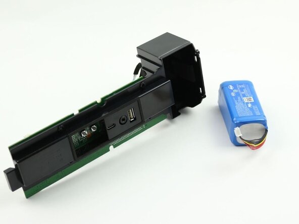

    • Flip the motherboard and battery unit upside-down.
    • Use your hands to pry the battery up and out of the case.
    • Replace with a new battery.
