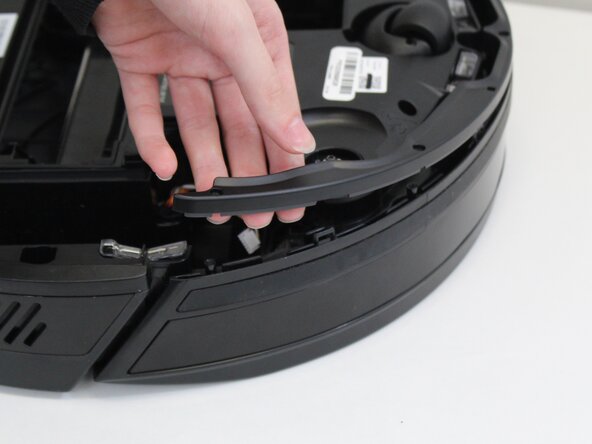

    • Remove the 5 9.30 mm screws securing the bumper trim using a Torx TR8 screwdriver.
    • Use an opening tool or spudger to release the clips securing the bumper trip.
    • Carefully pull the bumper trim off the vacuum.
    • Lift the front bumper off of the vacuum.

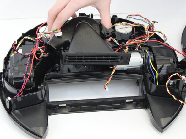

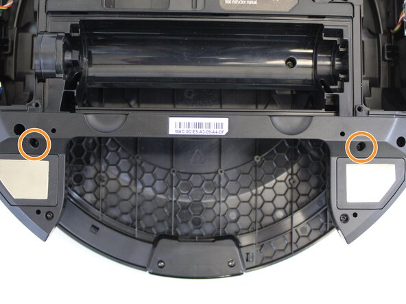

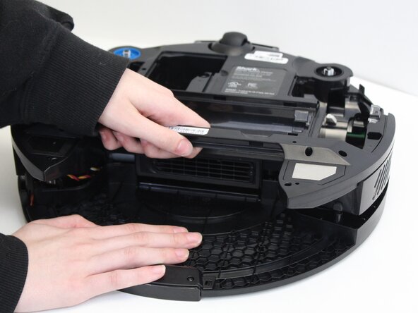

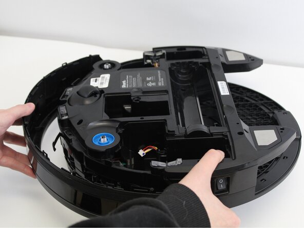

  7. Shark ION RV754 Suction Motor Replacement: crwdns2935265:07crwdnd2935265:01crwdnd2935265:03crwdne2935265:0 Shark ION RV754 Suction Motor Replacement: crwdns2935265:07crwdnd2935265:02crwdnd2935265:03crwdne2935265:0 Shark ION RV754 Suction Motor Replacement: crwdns2935265:07crwdnd2935265:03crwdnd2935265:03crwdne2935265:0
    • Use a TR8 Torx Security screwdriver to remove the five 13.9 mm screws from the bottom of the vacuum.
    • These 13.9 mm screws are in deep recesses and the TR8 screwdriver will need an extension or a narrow shaft to reach them.
    • Remove the two 9.3 mm screws from the bottom of the vacuum near the dust bin cavity using a TR15 Torx Security screwdriver.
    • To separate the vacuum body, place one hand on the bottom and pull with the other from the brush roll recess.

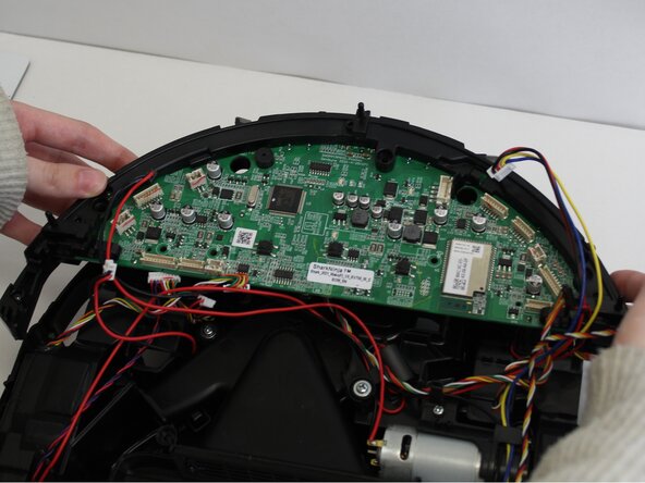

  8. Shark ION RV754 Suction Motor Replacement: crwdns2935265:08crwdnd2935265:01crwdnd2935265:03crwdne2935265:0 Shark ION RV754 Suction Motor Replacement: crwdns2935265:08crwdnd2935265:02crwdnd2935265:03crwdne2935265:0 Shark ION RV754 Suction Motor Replacement: crwdns2935265:08crwdnd2935265:03crwdnd2935265:03crwdne2935265:0

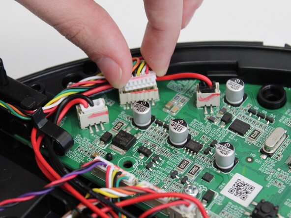

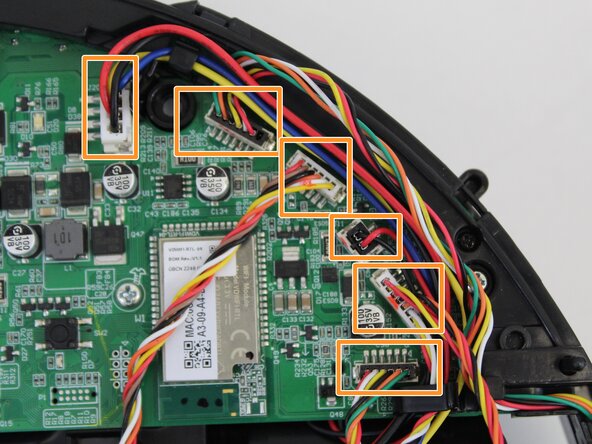

    • Remove the 6 circuit board wire connectors on the left side of the board as shown.
    • Remove the 6 circuit board wire connectors on the right side of the board using the same method.
    • For helpful tips on removing the cables from the board, take a look at the Recognizing and Disconnecting Cable Connectors guide.
    • Be careful when disconnecting the wire connectors from the circuit board to avoid damage to the wires, sockets, or circuit board.
    • It is a good idea to keep a reference picture for reattaching the wires later, since many of them are very similar in color and size.
  9. Shark ION RV754 Suction Motor Replacement: crwdns2935265:09crwdnd2935265:01crwdnd2935265:02crwdne2935265:0 Shark ION RV754 Suction Motor Replacement: crwdns2935265:09crwdnd2935265:02crwdnd2935265:02crwdne2935265:0
    • Use a Phillips #1 screwdriver to remove the five 9.80 mm screws from the circuit board.
    • Gently remove the circuit board by pulling up on it as shown and set it aside.
  10. Shark ION RV754 Suction Motor Replacement: crwdns2935265:010crwdnd2935265:01crwdnd2935265:03crwdne2935265:0 Shark ION RV754 Suction Motor Replacement: crwdns2935265:010crwdnd2935265:02crwdnd2935265:03crwdne2935265:0 Shark ION RV754 Suction Motor Replacement: crwdns2935265:010crwdnd2935265:03crwdnd2935265:03crwdne2935265:0

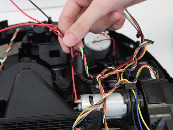

    • Remove the three 11.6 mm screws securing the suction motor using a Phillips #1 screwdriver.
    • Disconnect the remaining wires connected to the suction motor and move the wires aside to avoid pulling on them when removing the suction motor.
    • Pull up on the suction motor to remove it.
