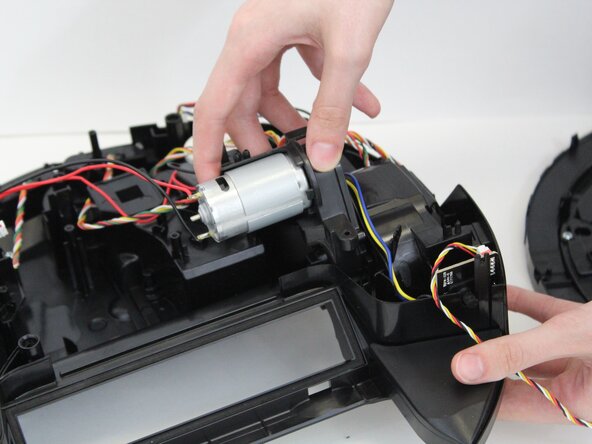

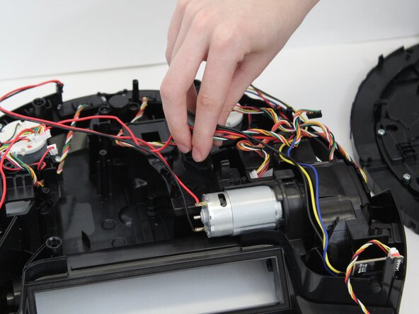

  11. Shark ION RV754 Brush Roll Motor Replacement, Brush Roll Motor: crwdns2935265:011crwdnd2935265:01crwdnd2935265:03crwdne2935265:0 Shark ION RV754 Brush Roll Motor Replacement, Brush Roll Motor: crwdns2935265:011crwdnd2935265:02crwdnd2935265:03crwdne2935265:0 Shark ION RV754 Brush Roll Motor Replacement, Brush Roll Motor: crwdns2935265:011crwdnd2935265:03crwdnd2935265:03crwdne2935265:0
    • Use a Phillips #1 screwdriver to remove the two 4.8 mm screws holding the brush roll motor.
    • Remove the wires attached to the clip by pulling them away gently.
    • For helpful tips on removing the cables from the board, take a look at the Recognizing and Disconnecting Cable Connectors guide.
    • Pull the brush roll motor up to remove it.
