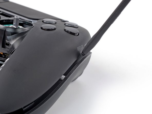

  3. Scuf Reflex Battery Replacement, Pry up the L1 bumper: crwdns2935265:03crwdnd2935265:01crwdnd2935265:03crwdne2935265:0 Scuf Reflex Battery Replacement, Pry up the L1 bumper: crwdns2935265:03crwdnd2935265:02crwdnd2935265:03crwdne2935265:0 Scuf Reflex Battery Replacement, Pry up the L1 bumper: crwdns2935265:03crwdnd2935265:03crwdnd2935265:03crwdne2935265:0
    • Insert the flat end of a spudger between the faceplate and the L1 bumper.
    • Pry up with the spudger to release the clips securing the bumper.

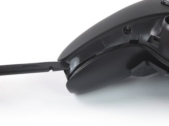

  5. Scuf Reflex Battery Replacement, Pry up the right faceplate trim edge: crwdns2935265:05crwdnd2935265:01crwdnd2935265:03crwdne2935265:0 Scuf Reflex Battery Replacement, Pry up the right faceplate trim edge: crwdns2935265:05crwdnd2935265:02crwdnd2935265:03crwdne2935265:0 Scuf Reflex Battery Replacement, Pry up the right faceplate trim edge: crwdns2935265:05crwdnd2935265:03crwdnd2935265:03crwdne2935265:0
    • The faceplate trim is secured by plastic clips.
    • At the bottom tip of the right grip, insert the flat end of a spudger or a clean fingernail between the faceplate trim and the back cover.
    • Pry up to release the faceplate trim’s bottom right clip.

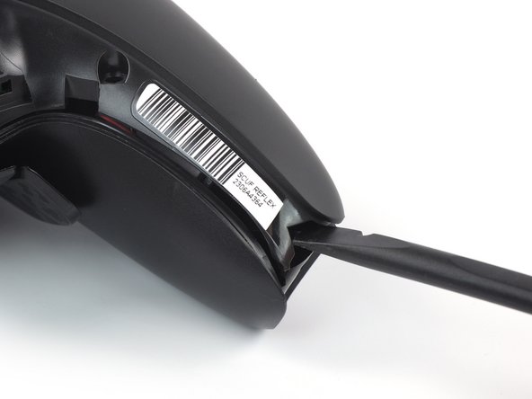

  6. Scuf Reflex Battery Replacement, Pry up the left faceplate trim edge: crwdns2935265:06crwdnd2935265:01crwdnd2935265:03crwdne2935265:0 Scuf Reflex Battery Replacement, Pry up the left faceplate trim edge: crwdns2935265:06crwdnd2935265:02crwdnd2935265:03crwdne2935265:0 Scuf Reflex Battery Replacement, Pry up the left faceplate trim edge: crwdns2935265:06crwdnd2935265:03crwdnd2935265:03crwdne2935265:0
    • At the bottom tip of the left grip, insert the flat end of a spudger or a clean fingernail between the faceplate trim and the back cover.
    • Pry up to release the faceplate trim’s bottom left clip.

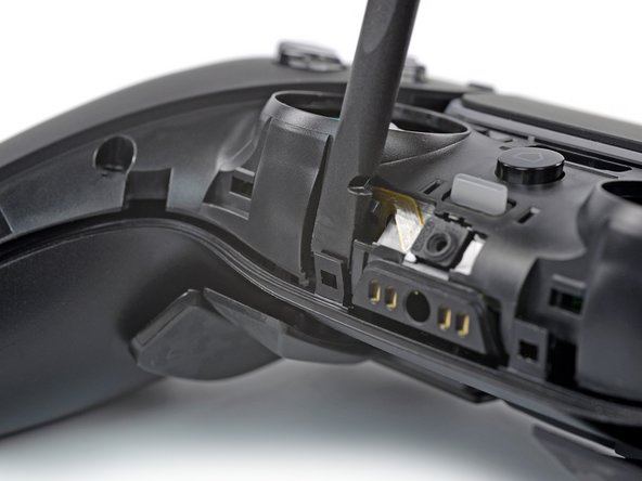

  7. Scuf Reflex Battery Replacement, Pry up the center of the faceplate trim: crwdns2935265:07crwdnd2935265:01crwdnd2935265:02crwdne2935265:0 Scuf Reflex Battery Replacement, Pry up the center of the faceplate trim: crwdns2935265:07crwdnd2935265:02crwdnd2935265:02crwdne2935265:0
    • Insert the flat end of a spudger between the faceplate trim and the back cover, next to the headphone jack.
    • Pry up to release the plastic clips securing the center of the faceplate trim.

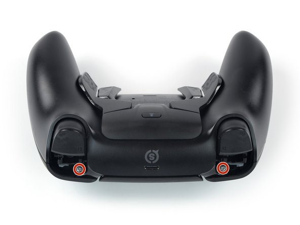

  10. Scuf Reflex Battery Replacement, Unfasten the back cover: crwdns2935265:010crwdnd2935265:01crwdnd2935265:02crwdne2935265:0 Scuf Reflex Battery Replacement, Unfasten the back cover: crwdns2935265:010crwdnd2935265:02crwdnd2935265:02crwdne2935265:0
    • Use a Phillips screwdriver to remove the four 6.5 mm-long screws securing the back cover, two near the triggers and two at the bottoms of the grips.

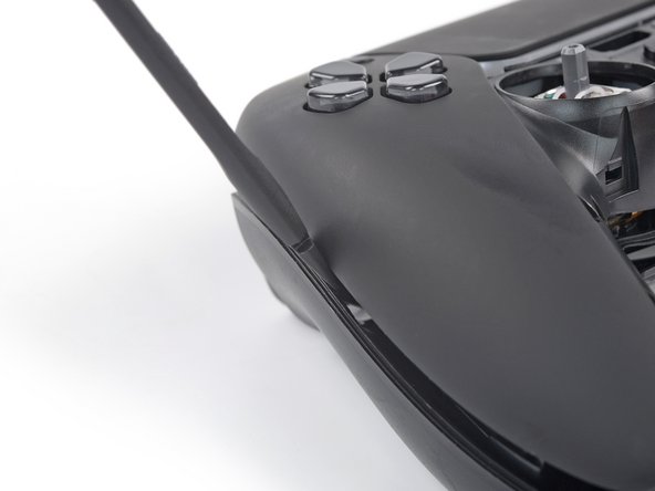

  11. Scuf Reflex Battery Replacement, Pry up the faceplate: crwdns2935265:011crwdnd2935265:01crwdnd2935265:02crwdne2935265:0 Scuf Reflex Battery Replacement, Pry up the faceplate: crwdns2935265:011crwdnd2935265:02crwdnd2935265:02crwdne2935265:0
    • The faceplate is secured by plastic clips.
    • Insert a spudger underneath the bottom right corner of the faceplate and pry up to release the plastic clip.

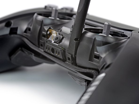

    • Insert the flat end of a spudger between the plastic clip next to the headphone jack and the faceplate.
    • Pry the plastic clip away from the faceplate to release it.
    • Repeat to release the second clip.

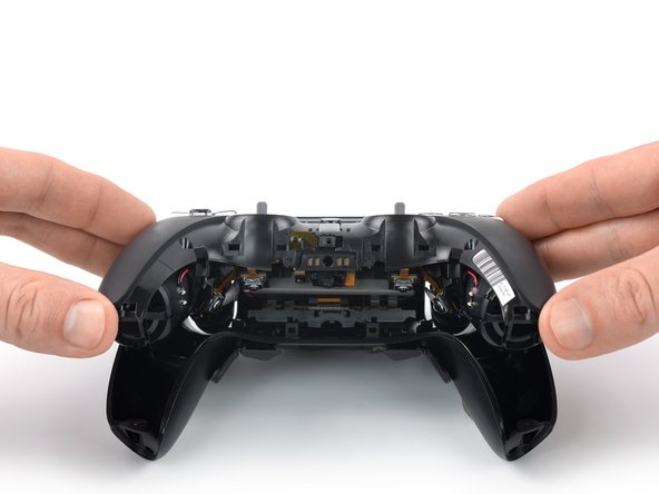

  16. Scuf Reflex Battery Replacement, Remove the front cover assembly: crwdns2935265:016crwdnd2935265:01crwdnd2935265:03crwdne2935265:0 Scuf Reflex Battery Replacement, Remove the front cover assembly: crwdns2935265:016crwdnd2935265:02crwdnd2935265:03crwdne2935265:0 Scuf Reflex Battery Replacement, Remove the front cover assembly: crwdns2935265:016crwdnd2935265:03crwdnd2935265:03crwdne2935265:0
    • Carefully lift up the bottom of the faceplate assembly.
    • Pull the faceplate assembly down and remove it.
    • During reassembly, guide the triggers and the profile button through their cutouts in the back cover. Then press the faceplate assembly firmly into the back cover to engage the plastic clips securing it.

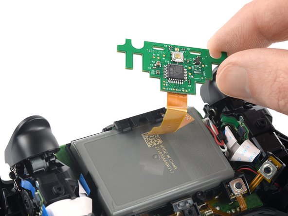

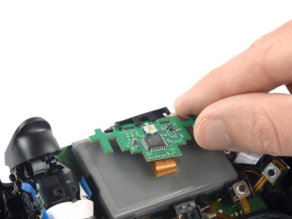

  17. Scuf Reflex Battery Replacement, Free the daughterboard: crwdns2935265:017crwdnd2935265:01crwdnd2935265:03crwdne2935265:0 Scuf Reflex Battery Replacement, Free the daughterboard: crwdns2935265:017crwdnd2935265:02crwdnd2935265:03crwdne2935265:0 Scuf Reflex Battery Replacement, Free the daughterboard: crwdns2935265:017crwdnd2935265:03crwdnd2935265:03crwdne2935265:0
    • Two delicate plastic clips secure the daughterboard.
    • Gently pull the right side of the daughterboard down to release the first plastic clip.
    • Pull the left side of the daughterboard down to release the second clip and free the board.
    • Move the daughterboard to the side to get free access to the battery connector.
    • Avoid straining or sharply folding the daughterboard cable.

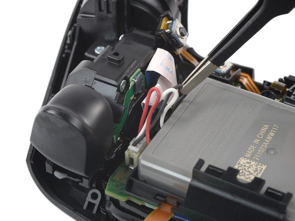

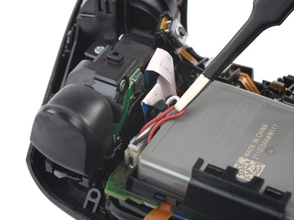

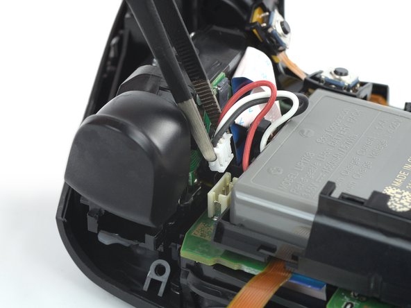

  18. Scuf Reflex Battery Replacement, Free the battery connector cables: crwdns2935265:018crwdnd2935265:01crwdnd2935265:03crwdne2935265:0 Scuf Reflex Battery Replacement, Free the battery connector cables: crwdns2935265:018crwdnd2935265:02crwdnd2935265:03crwdne2935265:0 Scuf Reflex Battery Replacement, Free the battery connector cables: crwdns2935265:018crwdnd2935265:03crwdnd2935265:03crwdne2935265:0
    • The battery connector cables are routed underneath a small plastic hook next to the battery connector.
    • Use tweezers to carefully pull all three battery cables out from under their plastic hook.
    • During reassembly, make sure to thread the cables back underneath the plastic hook.

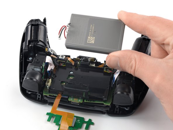

  19. Scuf Reflex Battery Replacement, Disconnect the battery: crwdns2935265:019crwdnd2935265:01crwdnd2935265:02crwdne2935265:0 Scuf Reflex Battery Replacement, Disconnect the battery: crwdns2935265:019crwdnd2935265:02crwdnd2935265:02crwdne2935265:0
  20. Scuf Reflex Battery Replacement, Remove the battery: crwdns2935265:020crwdnd2935265:01crwdnd2935265:02crwdne2935265:0 Scuf Reflex Battery Replacement, Remove the battery: crwdns2935265:020crwdnd2935265:02crwdnd2935265:02crwdne2935265:0
    • Remove the battery.
    • Never reuse a deformed or damaged battery—it's a fire hazard. Replace it with a new battery.
