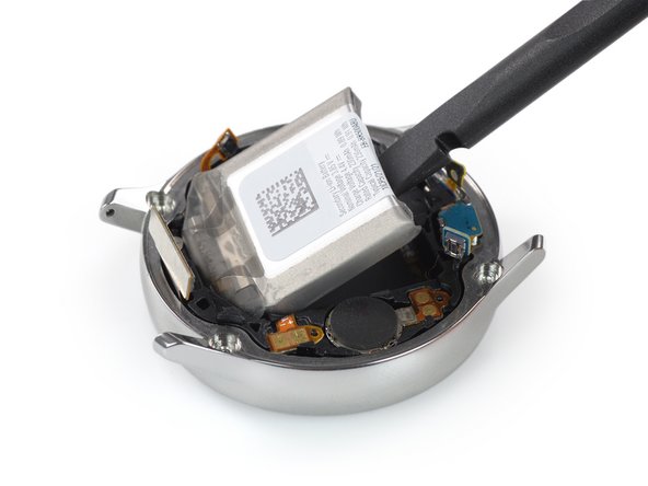

    1. Samsung Watch Active Battery Replacement, Lift the battery: crwdns2935265:011crwdnd2935265:01crwdnd2935265:03crwdne2935265:0 Samsung Watch Active Battery Replacement, Lift the battery: crwdns2935265:011crwdnd2935265:02crwdnd2935265:03crwdne2935265:0 Samsung Watch Active Battery Replacement, Lift the battery: crwdns2935265:011crwdnd2935265:03crwdnd2935265:03crwdne2935265:0
      • Insert the flat end of a spudger between the bottom of the battery and the core frame.
      • The battery is secured with some mild adhesive.
      • Use the spudger to lever up the battery.

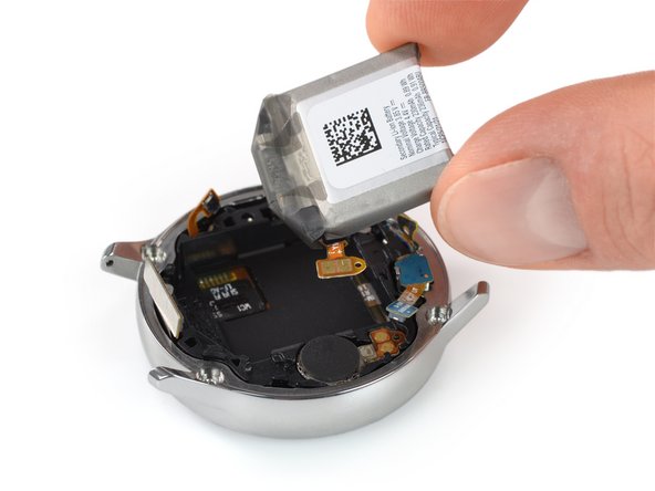

    2. Samsung Watch Active Battery Replacement, Remove the battery: crwdns2935265:012crwdnd2935265:01crwdnd2935265:03crwdne2935265:0 Samsung Watch Active Battery Replacement, Remove the battery: crwdns2935265:012crwdnd2935265:02crwdnd2935265:03crwdne2935265:0 Samsung Watch Active Battery Replacement, Remove the battery: crwdns2935265:012crwdnd2935265:03crwdnd2935265:03crwdne2935265:0
      • Remove the battery from the core assembly.
      • The battery connector is fixed with mild adhesive.
      • When installing a new battery make sure the tiny hole on the battery connector aligns with the pin on the core frame.
Secure the new battery with pre-cut adhesive or double-sided adhesive tape. Press the new battery firmly into place.
For optimal performance, calibrate your newly installed battery: Charge it to 100% and keep charging it for at least 1 more hour. Then use your device until it shuts off due to low battery. Finally, charge it uninterrupted to 100%.
