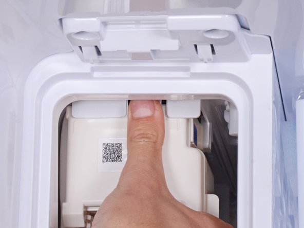

      • A plastic clip holds the icemaker in place.
      • Use your fingers to press and release the plastic clip.
      • This clip is stiff and may require substantial force.
    9. Samsung Refrigerator Icemaker Assembly Replacement: crwdns2935265:014crwdnd2935265:01crwdnd2935265:02crwdne2935265:0 Samsung Refrigerator Icemaker Assembly Replacement: crwdns2935265:014crwdnd2935265:02crwdnd2935265:02crwdne2935265:0
      • Pull the front edge of the icemaker assembly down slightly to loosen it.
      • Be careful not to bend the refrigerant loop too much as you pull the front edge, or you'll damage the loop.
      • Carefully slide the icemaker assembly out of its housing.
