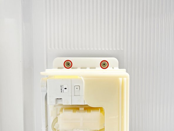

      • Use a Phillips screwdriver to remove the screws securing the icemaker assembly to the freezer ceiling.

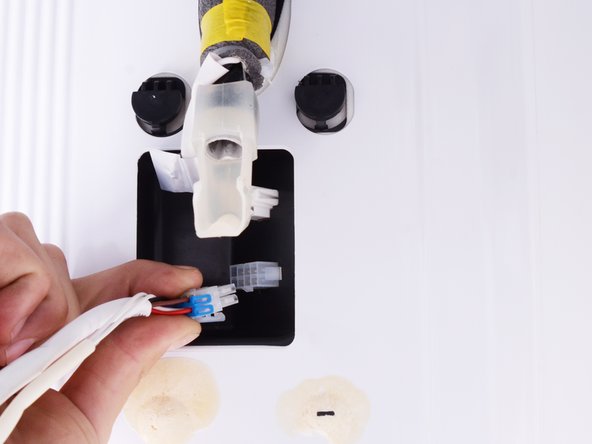

      • Use your fingers to guide the wire harness out of the icemaker assembly.
    9. Samsung Refrigerator Icemaker Assembly Replacement (Freezer Icemaker): crwdns2935265:09crwdnd2935265:01crwdnd2935265:03crwdne2935265:0 Samsung Refrigerator Icemaker Assembly Replacement (Freezer Icemaker): crwdns2935265:09crwdnd2935265:02crwdnd2935265:03crwdne2935265:0 Samsung Refrigerator Icemaker Assembly Replacement (Freezer Icemaker): crwdns2935265:09crwdnd2935265:03crwdnd2935265:03crwdne2935265:0
      • Squeeze the icemaker cable connector and pull to disconnect it.

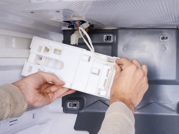

    10. Samsung Refrigerator Icemaker Assembly Replacement (Freezer Icemaker): crwdns2935265:010crwdnd2935265:01crwdnd2935265:01crwdne2935265:0
      • Remove the icemaker assembly.
