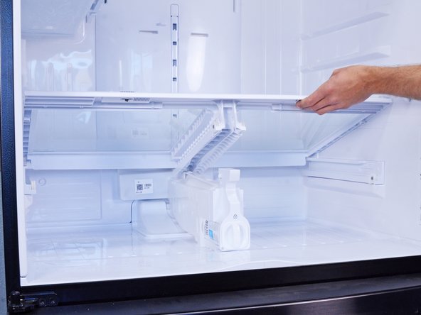

  3. Samsung Refrigerator Evaporator Fan (Refrigerator Compartment) Replacement, Remove the shelves: crwdns2935265:03crwdnd2935265:01crwdnd2935265:02crwdne2935265:0 Samsung Refrigerator Evaporator Fan (Refrigerator Compartment) Replacement, Remove the shelves: crwdns2935265:03crwdnd2935265:02crwdnd2935265:02crwdne2935265:0
    • Remove all the loose shelves and bins from the refrigerator compartment.
    • The bottom shelf is clipped in place. Follow the next step to remove it.

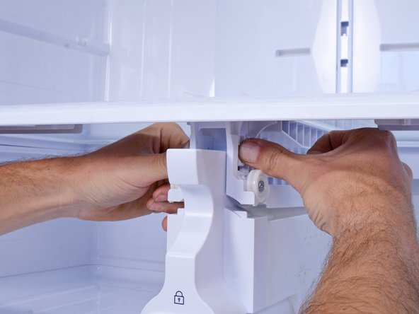

  4. Samsung Refrigerator Evaporator Fan (Refrigerator Compartment) Replacement: crwdns2935265:04crwdnd2935265:01crwdnd2935265:03crwdne2935265:0 Samsung Refrigerator Evaporator Fan (Refrigerator Compartment) Replacement: crwdns2935265:04crwdnd2935265:02crwdnd2935265:03crwdne2935265:0 Samsung Refrigerator Evaporator Fan (Refrigerator Compartment) Replacement: crwdns2935265:04crwdnd2935265:03crwdnd2935265:03crwdne2935265:0
    • Two stiff plastic tabs (one on each side) secure the bottom shelf in place.
    • Press both plastic tabs firmly with your fingers and lift upward to unclip the bottom shelf.
    • If the shelf doesn't unclip, you can try using a flathead screwdriver to press each clip in.
    • Remove the bottom shelf.

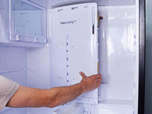

  5. Samsung Refrigerator Evaporator Fan (Refrigerator Compartment) Replacement, Remove the refrigerator evaporator cover: crwdns2935265:05crwdnd2935265:01crwdnd2935265:03crwdne2935265:0 Samsung Refrigerator Evaporator Fan (Refrigerator Compartment) Replacement, Remove the refrigerator evaporator cover: crwdns2935265:05crwdnd2935265:02crwdnd2935265:03crwdne2935265:0 Samsung Refrigerator Evaporator Fan (Refrigerator Compartment) Replacement, Remove the refrigerator evaporator cover: crwdns2935265:05crwdnd2935265:03crwdnd2935265:03crwdne2935265:0
    • Use a flathead screwdriver to pry and remove the top screw cover on the evaporator cover.
  6. Samsung Refrigerator Evaporator Fan (Refrigerator Compartment) Replacement: crwdns2935265:06crwdnd2935265:01crwdnd2935265:01crwdne2935265:0
    • Remove the screws securing the evaporator cover.

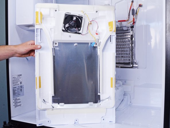

  7. Samsung Refrigerator Evaporator Fan (Refrigerator Compartment) Replacement: crwdns2935265:07crwdnd2935265:01crwdnd2935265:03crwdne2935265:0 Samsung Refrigerator Evaporator Fan (Refrigerator Compartment) Replacement: crwdns2935265:07crwdnd2935265:02crwdnd2935265:03crwdne2935265:0 Samsung Refrigerator Evaporator Fan (Refrigerator Compartment) Replacement: crwdns2935265:07crwdnd2935265:03crwdnd2935265:03crwdne2935265:0
    • Grasp the right edge of the evaporator cover with your hands and swing it outwards toward you.
    • Don't try to fully remove the cover in this step, as it's connected by several wires.

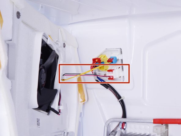

  8. Samsung Refrigerator Evaporator Fan (Refrigerator Compartment) Replacement: crwdns2935265:08crwdnd2935265:01crwdnd2935265:01crwdne2935265:0
    • Squeeze and disconnect all the wire connectors connecting the evaporator cover to the refrigerator.
  9. Samsung Refrigerator Evaporator Fan (Refrigerator Compartment) Replacement: crwdns2935265:09crwdnd2935265:01crwdnd2935265:02crwdne2935265:0 Samsung Refrigerator Evaporator Fan (Refrigerator Compartment) Replacement: crwdns2935265:09crwdnd2935265:02crwdnd2935265:02crwdne2935265:0
    • Pull the evaporator cover towards you and remove it.

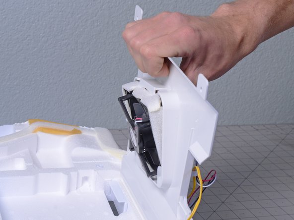

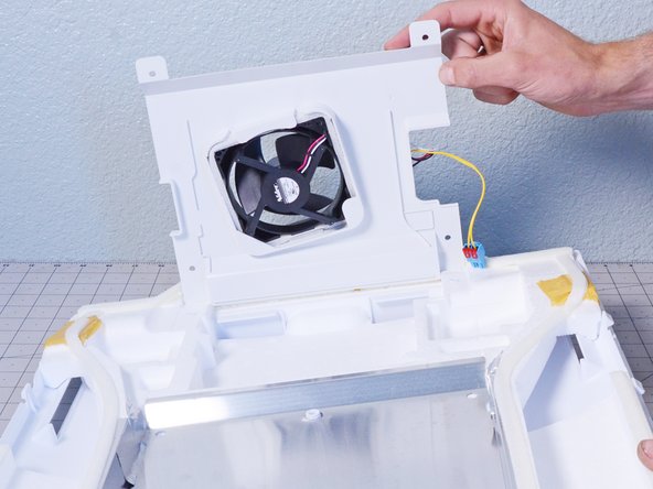

  12. Samsung Refrigerator Evaporator Fan (Refrigerator Compartment) Replacement: crwdns2935265:012crwdnd2935265:01crwdnd2935265:02crwdne2935265:0 Samsung Refrigerator Evaporator Fan (Refrigerator Compartment) Replacement: crwdns2935265:012crwdnd2935265:02crwdnd2935265:02crwdne2935265:0
    • Lift the loose edge of the fan bracket up.
  13. Samsung Refrigerator Evaporator Fan (Refrigerator Compartment) Replacement: crwdns2935265:013crwdnd2935265:01crwdnd2935265:02crwdne2935265:0 Samsung Refrigerator Evaporator Fan (Refrigerator Compartment) Replacement: crwdns2935265:013crwdnd2935265:02crwdnd2935265:02crwdne2935265:0
    • The fan is pressure-fit in place with some foam insulation.
    • Use your fingers to press the fan out of its recess.
  14. Samsung Refrigerator Evaporator Fan (Refrigerator Compartment) Replacement: crwdns2935265:014crwdnd2935265:01crwdnd2935265:01crwdne2935265:0
    • Remove the fan.
    • During reassembly, be sure to install the fan in the right orientation: the side with the center label should face down, towards the evaporator cover.
