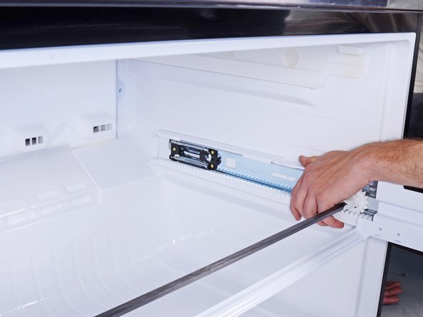

  3. Samsung Refrigerator Evaporator Fan (Freezer Compartment) Replacement, Remove the freezer bins: crwdns2935265:03crwdnd2935265:01crwdnd2935265:01crwdne2935265:0
    • Lift and remove all the freezer bins from the drawer.
    • You should be left with a freezer door attached by two rails.
  4. Samsung Refrigerator Evaporator Fan (Freezer Compartment) Replacement, Remove the freezer door: crwdns2935265:04crwdnd2935265:01crwdnd2935265:03crwdne2935265:0 Samsung Refrigerator Evaporator Fan (Freezer Compartment) Replacement, Remove the freezer door: crwdns2935265:04crwdnd2935265:02crwdnd2935265:03crwdne2935265:0 Samsung Refrigerator Evaporator Fan (Freezer Compartment) Replacement, Remove the freezer door: crwdns2935265:04crwdnd2935265:03crwdnd2935265:03crwdne2935265:0

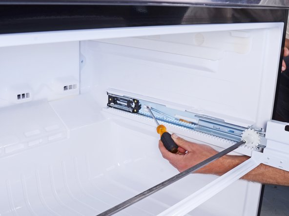

    • A plastic tab locks each drawer rail in place.
    • Use a flathead screwdriver to press in the plastic tab near the inner end of the drawer rail.
    • As you press the plastic tab, grasp the rail with your free hand and slide it towards you slightly to unlock the rail.
  5. Samsung Refrigerator Evaporator Fan (Freezer Compartment) Replacement: crwdns2935265:05crwdnd2935265:01crwdnd2935265:02crwdne2935265:0 Samsung Refrigerator Evaporator Fan (Freezer Compartment) Replacement: crwdns2935265:05crwdnd2935265:02crwdnd2935265:02crwdne2935265:0

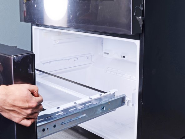

    • Repeat the rail unlock procedure on the other drawer rail.
    • Once both rails are unlocked, firmly pull both rails to slide them out of the refrigerator wall guides.
    • Remove the freezer drawer.
    • To install the freezer drawer:
    • Push the geared torsion bar until it rests at the very end of the rails.
    • Align the drawer rails to the refrigerator wall guides.
    • Close the freezer drawer until the rails lock back in place.
    • If you don't hear a click, visually check if the plastic tabs have locked in place. You may need to push the rails in a little further with your fingers to set the tabs.

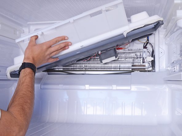

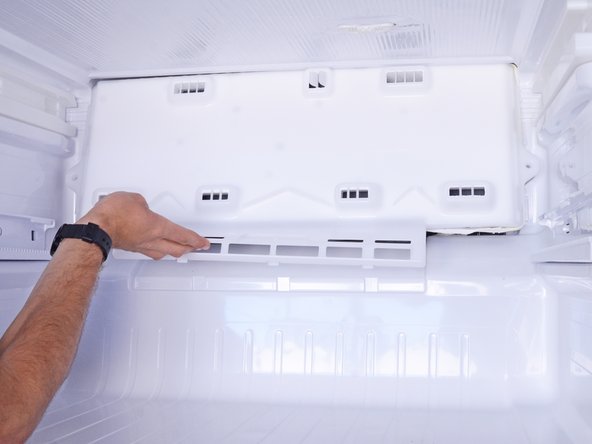

  6. Samsung Refrigerator Evaporator Fan (Freezer Compartment) Replacement, Remove the freezer compartment evaporator cover: crwdns2935265:06crwdnd2935265:01crwdnd2935265:01crwdne2935265:0
    • Remove the screws securing the freezer evaporator cover.
  7. Samsung Refrigerator Evaporator Fan (Freezer Compartment) Replacement: crwdns2935265:07crwdnd2935265:01crwdnd2935265:03crwdne2935265:0 Samsung Refrigerator Evaporator Fan (Freezer Compartment) Replacement: crwdns2935265:07crwdnd2935265:02crwdnd2935265:03crwdne2935265:0 Samsung Refrigerator Evaporator Fan (Freezer Compartment) Replacement: crwdns2935265:07crwdnd2935265:03crwdnd2935265:03crwdne2935265:0
    • Don't try to fully remove the evaporator cover yet, as it's connected to the refrigerator by a few wires in the top right corner.
    • Use your hands to lift the bottom edge of the evaporator cover up to release the lower plastic tabs.
    • Swing the evaporator cover upwards to access the connected wires behind it.
  8. Samsung Refrigerator Evaporator Fan (Freezer Compartment) Replacement: crwdns2935265:08crwdnd2935265:01crwdnd2935265:02crwdne2935265:0 Samsung Refrigerator Evaporator Fan (Freezer Compartment) Replacement: crwdns2935265:08crwdnd2935265:02crwdnd2935265:02crwdne2935265:0

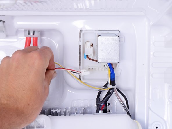

    • Use your fingers to squeeze and disconnect the fan cable connector from the back wall of the freezer.
  9. Samsung Refrigerator Evaporator Fan (Freezer Compartment) Replacement: crwdns2935265:09crwdnd2935265:01crwdnd2935265:01crwdne2935265:0
    • Remove the evaporator cover.

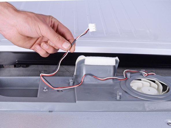

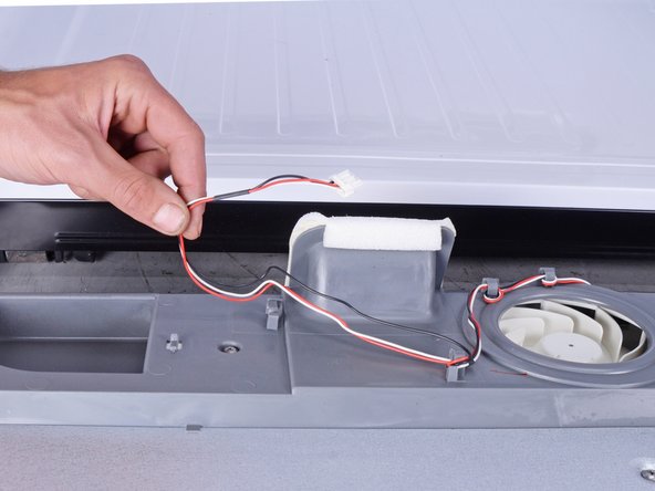

    • Guide the fan cable from the evaporator cover clips.
    • If you have trouble getting the cable out of the clips, squeeze the clips with pliers to create a wider gap.

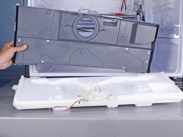

  11. Samsung Refrigerator Evaporator Fan (Freezer Compartment) Replacement: crwdns2935265:011crwdnd2935265:01crwdnd2935265:01crwdne2935265:0
    • Remove the screws securing the back panel to the evaporator cover.

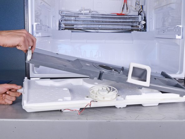

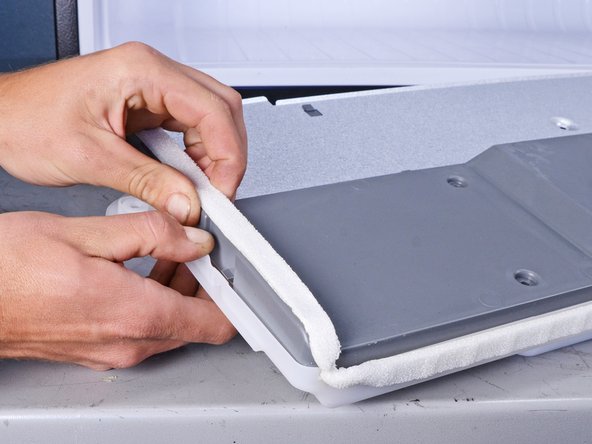

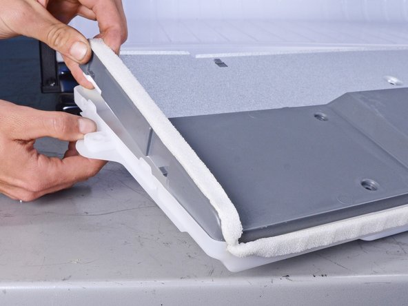

  12. Samsung Refrigerator Evaporator Fan (Freezer Compartment) Replacement: crwdns2935265:012crwdnd2935265:01crwdnd2935265:03crwdne2935265:0 Samsung Refrigerator Evaporator Fan (Freezer Compartment) Replacement: crwdns2935265:012crwdnd2935265:02crwdnd2935265:03crwdne2935265:0 Samsung Refrigerator Evaporator Fan (Freezer Compartment) Replacement: crwdns2935265:012crwdnd2935265:03crwdnd2935265:03crwdne2935265:0
    • Use your fingers to pry and release the clips along the short edge of the evaporator cover.
    • If the perimeter foam insulation prevents you from releasing the clips, cut the foam with scissors.
  13. Samsung Refrigerator Evaporator Fan (Freezer Compartment) Replacement: crwdns2935265:013crwdnd2935265:01crwdnd2935265:03crwdne2935265:0 Samsung Refrigerator Evaporator Fan (Freezer Compartment) Replacement: crwdns2935265:013crwdnd2935265:02crwdnd2935265:03crwdne2935265:0 Samsung Refrigerator Evaporator Fan (Freezer Compartment) Replacement: crwdns2935265:013crwdnd2935265:03crwdnd2935265:03crwdne2935265:0
    • Lift and separate the back panel from the evaporator cover.
