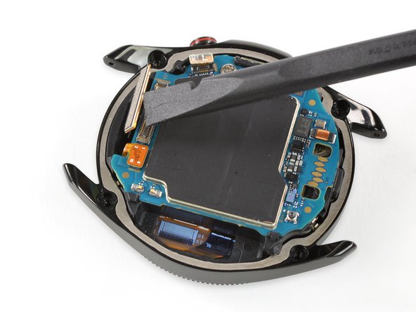

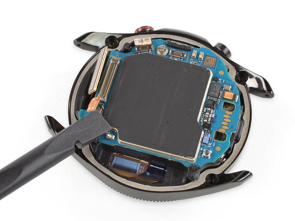

  5. Samsung Galaxy Watch3 Battery Replacement, Unplug the three connectors: crwdns2935265:05crwdnd2935265:01crwdnd2935265:03crwdne2935265:0 Samsung Galaxy Watch3 Battery Replacement, Unplug the three connectors: crwdns2935265:05crwdnd2935265:02crwdnd2935265:03crwdne2935265:0 Samsung Galaxy Watch3 Battery Replacement, Unplug the three connectors: crwdns2935265:05crwdnd2935265:03crwdnd2935265:03crwdne2935265:0
    • Use the flat end of a spudger to disconnect the flex cables of the side buttons, the display and the hall sensor.
