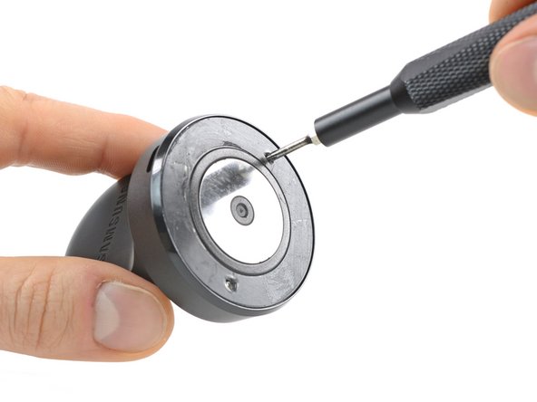

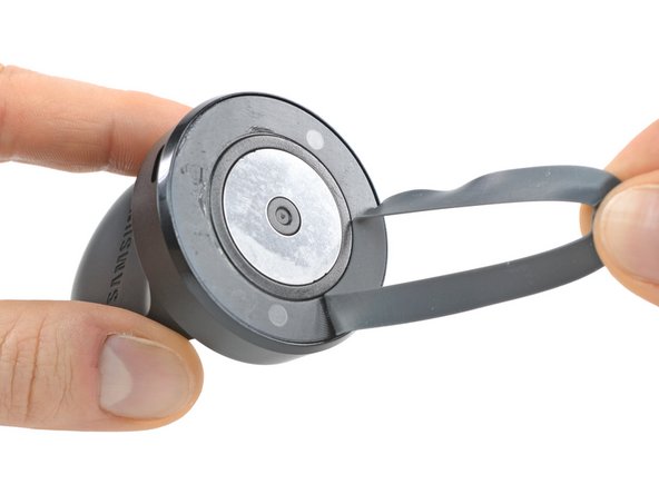

    • And its charger shall not remain a mystery. Again we grab our precision bit driver, and go for a spin ourselves.

    • This one won't give away its secrets that easily, so we have to bring out our thermally-enhanced particle accelerator (also known as an ordinary heat gun).
    • Eventually we succeed with strong (hand) force and the use of a pair of flat needle nose pliers ...
    • ... which lays bare the charging coil with its ~14 windings (front and back).
