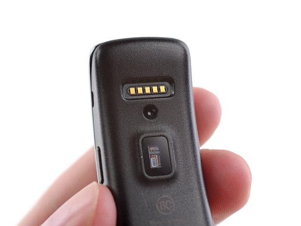

    • Wrist strap dispatched, it's time for a close-up inspection of the dark side wrist-side of the Fit.
    • Riding along against your arm, you'll find the heart rate monitor and charging cradle contacts.
    • Let's hope that Samsung didn't include a remote taser feature.
    • They did include a model number: SM-R350, if our eyes do not deceive us.

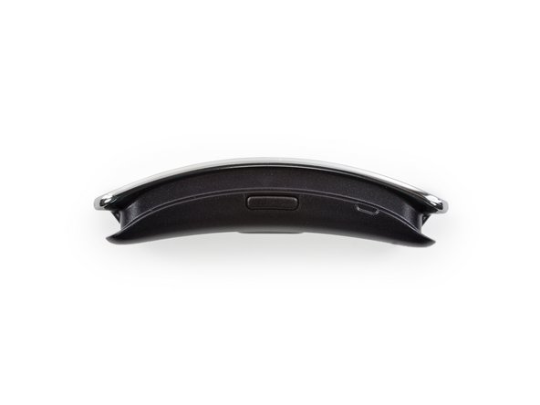

    • A single button serves as a sleep/wake and power switch, and is the only significant opening in the unibody enclosure.
  3. Samsung Gear Fit Teardown: crwdns2935265:04crwdnd2935265:01crwdnd2935265:02crwdne2935265:0 Samsung Gear Fit Teardown: crwdns2935265:04crwdnd2935265:02crwdnd2935265:02crwdne2935265:0
    • On the hunt for screws, we take a peek under a promising cover...
    • ...Only to find a hole. Perhaps for a microphone?
    • Whatever it is, it's no help in the opening procedure mystery. Looks like we're gonna need a little help.

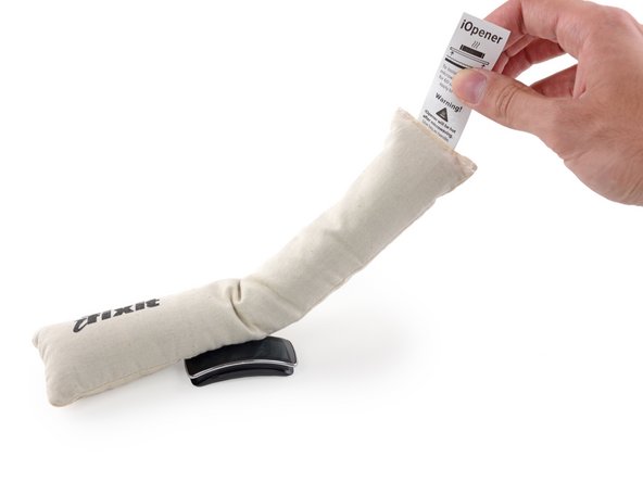

  4. Samsung Gear Fit Teardown: crwdns2935265:05crwdnd2935265:01crwdnd2935265:03crwdne2935265:0 Samsung Gear Fit Teardown: crwdns2935265:05crwdnd2935265:02crwdnd2935265:03crwdne2935265:0 Samsung Gear Fit Teardown: crwdns2935265:05crwdnd2935265:03crwdnd2935265:03crwdne2935265:0
    iOpener
    $24.99

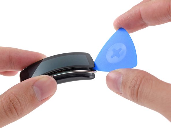

    • And help we shall receive—after we tell you about our exciting product, the iOpener. The iOpener makes repairs safer for you and your devices by gently heating and softening stubborn adhesives, without the danger of melting plastic or warping LCDs that you risk when using a heat gun.
    • Let's go ahead and throw an iOpener on our device, and—oh, what's that? We already did?
    • Why hello there, little Fit. Looking pretty cozy there. Sure would be a shame if somebody...
    • PRIED OFF YOUR FACE.
    • Thanks, iOpener.

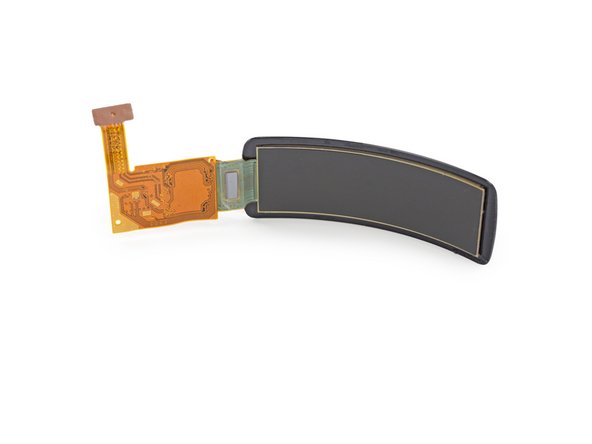

    • Adhesive softened, a little gentle prying and slicing is all it takes to separate the curved display from the body, hinging on its data and digitizer cables.
    • This thing is layered like an onion. Let's hope this is a safe place for some prying...
    • It is! With a wee pop, the cute sushi-shaped innards are free. We personally think it looks like some tasty nigiri (we are a California company after all).

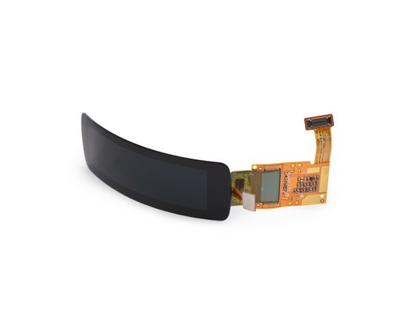

    • With some careful coaxing, we pick our sushi apart and peel the display assembly off the frame.
    • We liked the Gear 2's combined digitizer and LCD data cable, but it really isn't that much more effort to disconnect two things to remove the display.
    • At least these guys never got in the way of our industrious opening tools, unlike others we could name.
    • At 432 x 128 pixels, the Fit sports just over half the pixel count of the Gear 2's 320 x 320 display.
    • Pity it costs far more than half as much.

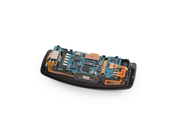

    • A close look at the motherboard shows a segmented, three-piece construction, with ribbon cables joining the parts—certainly an interesting approach, in contrast to the rumored flexible PCB of the upcoming wearable iDevice.
    • Our first stop: disconnect the battery. Next step: figure how to get it out. That's gonna take some digging...
    • Peeling the Bluetooth antenna up from the side allows us to pop the first segment free of the plastic frame.
  9. Samsung Gear Fit Teardown: crwdns2935265:010crwdnd2935265:01crwdnd2935265:02crwdne2935265:0 Samsung Gear Fit Teardown: crwdns2935265:010crwdnd2935265:02crwdnd2935265:02crwdne2935265:0
    • This is starting to feel a lot like KP. More peeling as the ribbon cable and contact for the Fit's sole button are spudgered away.
    • Aww, you're a cute little itty bitty motherboard, aren't you? Yes you are!
    • It could be a mirage, but is that a battery under there? We'll have to wait to see.
  10. Samsung Gear Fit Teardown: crwdns2935265:011crwdnd2935265:01crwdnd2935265:02crwdne2935265:0 Samsung Gear Fit Teardown: crwdns2935265:011crwdnd2935265:02crwdnd2935265:02crwdne2935265:0
    • Populating the board, we find this fittingly Lilliputian array of chips:
    • STMicroelectronics STM32F439ZI 180 MHz, 32 bit ARM Cortex CPU
    • Macronix MX69V28F64 128 Mb flash memory
    • InvenSense MPU-6500 6-axis gyroscope / accelerometer
    • Broadcom BCM4334WKUBG dual-band 802.11n, Bluetooth 4.0+HS, FM receiver combo chip
    • Maxim Integrated MAX77836 (the same chip we found in the Gear 2—likely the micro-USB interface controller and Li+ battery charger)
    • Melfas 8FM006A (likely touchscreen controller)
    • Texas Instruments 1211A1 standalone USB transceiver chip
