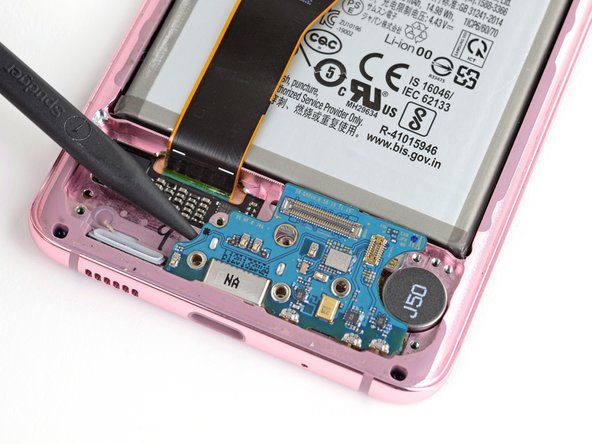

  23. Samsung Galaxy S20 USB-C Port and Daughterboard Replacement, Unfasten the daughterboard: crwdns2935265:023crwdnd2935265:01crwdnd2935265:01crwdne2935265:0
    • Use a Phillips #00 screwdriver to remove the three 3.4 mm-long screws securing the USB-C port and daughterboard.
  24. Samsung Galaxy S20 USB-C Port and Daughterboard Replacement, Remove the daughterboard: crwdns2935265:024crwdnd2935265:01crwdnd2935265:03crwdne2935265:0 Samsung Galaxy S20 USB-C Port and Daughterboard Replacement, Remove the daughterboard: crwdns2935265:024crwdnd2935265:02crwdnd2935265:03crwdne2935265:0 Samsung Galaxy S20 USB-C Port and Daughterboard Replacement, Remove the daughterboard: crwdns2935265:024crwdnd2935265:03crwdnd2935265:03crwdne2935265:0
    • Insert the pointed end of a spudger under the left edge of the daughterboard and pry up to release it from its recess.
    • Use a pair of tweezers to pull the daughterboard up and away from the bottom of the device and remove it.
